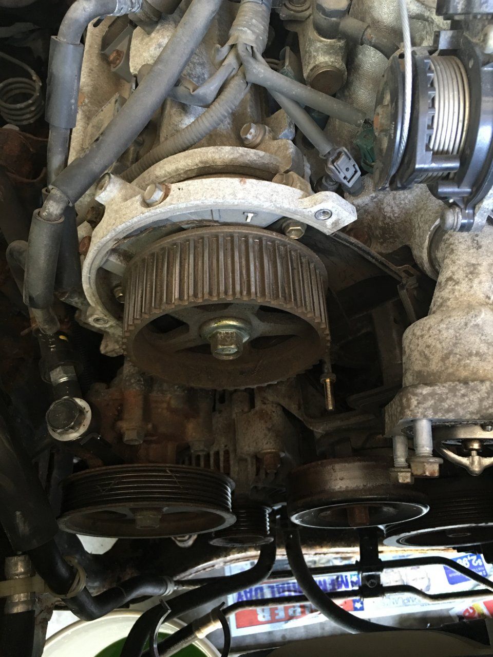

So that is the bane of my existence right now! I am following the FSM and trying to get off the fan bracket. The FSM says remove two bolts and nuts then remove bracket, just so simple, but the bracket is not cooperating! Any ideas anyone?
My guess is you are missing the removal of the two bolts that attach sort of from the side down by the oil filter. See pic & text in the FAQ at post #8 of this thread. The FSM talks about these two bolts in the section on removing the LH side of the timing cover, then neglects to mention them in the part about actually removing the fan bracket. Thankfully many of these issues have been pioneered and documented by Mudders.

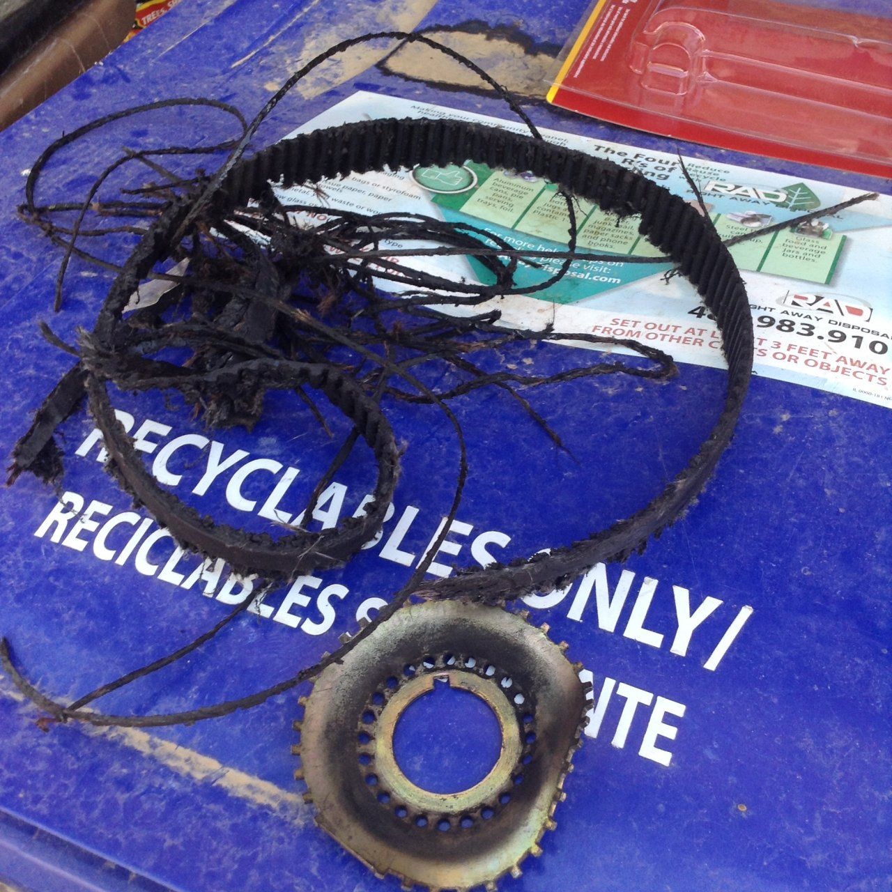

That's what's left of the belt and guide, I will need to find a place to get a new guide to replace that one. Also the dust boot of the tensioner was gone and I didn't see a space once the pulley was removed. The number one cover was also damaged.

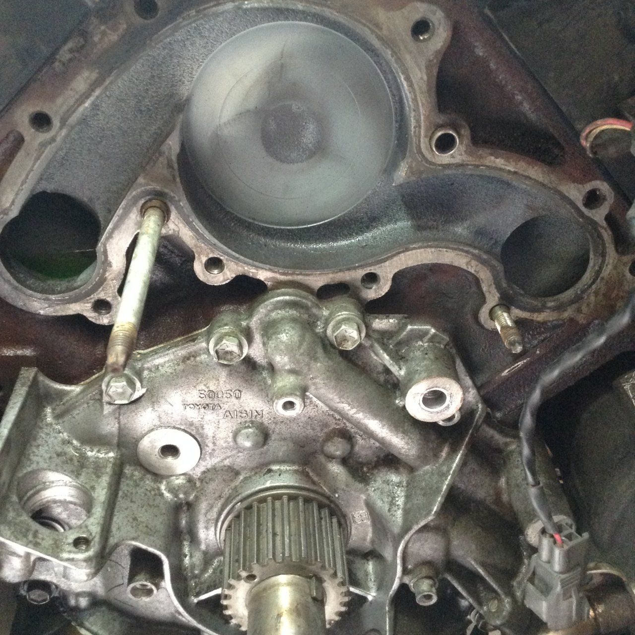

All taken apart. Water pump and bearings came out with no issues and I didn't see any damage to them.
Does anyone know where I would be able to get a new timing belt guide? I've checked online and local autoparts stores and pick a part places with no luck.
You're asking about the toothed part that's bent in an ealier pic? The crank angle sensor plate that goes on the end of the crank right?
Search Toyota 19315-50020 - may have to visit a dealer or buy from one online.

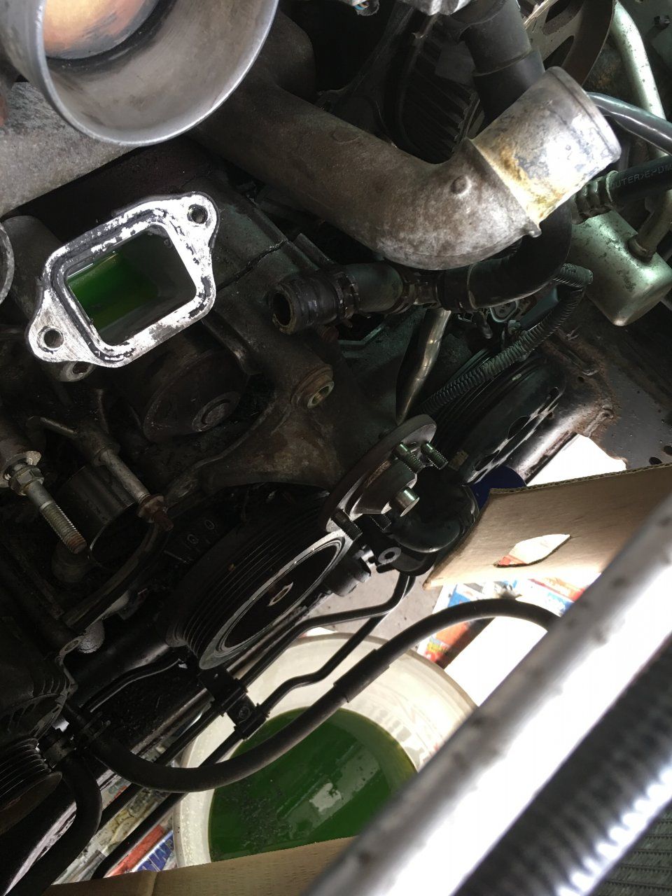

Also, get red TOYOTA coolant and drain that green s****t.
Thank you for the part number. That was my last effort was to go to a dealer and see what they have.

That's the plan, get that green crap out of there since I've already gone this far!

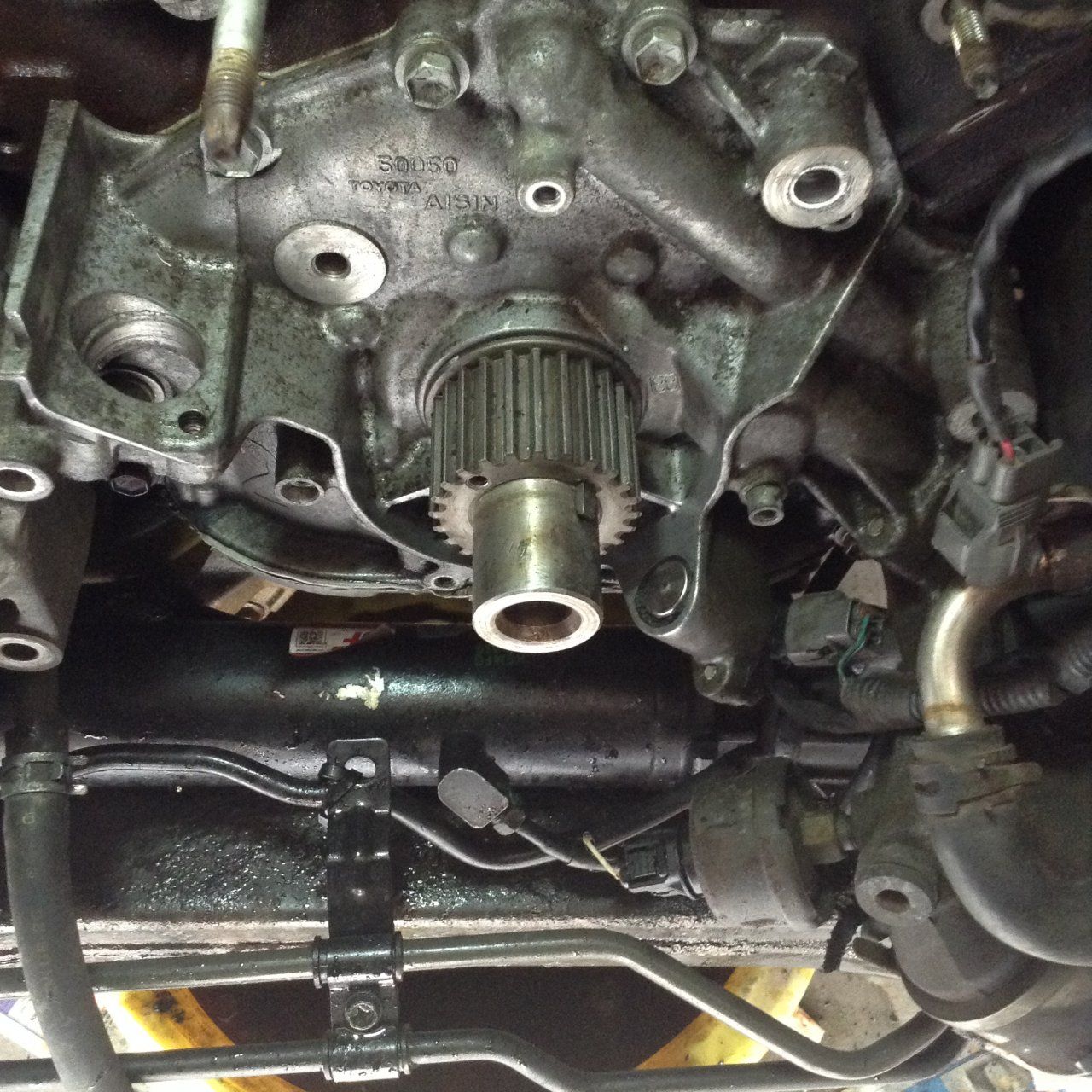

Well the belt is on and it is mostly put back together. There have been some hiccups but nothing major. Getting the belt on was fun, as well as getting the timing correct since there was no old belt to mark for reference. New wp, bearings and fan bracket installed. The worst part has been dealing with the AZ summer heat! Hopefully tomorrow I will start her up and then the truth will be known.
