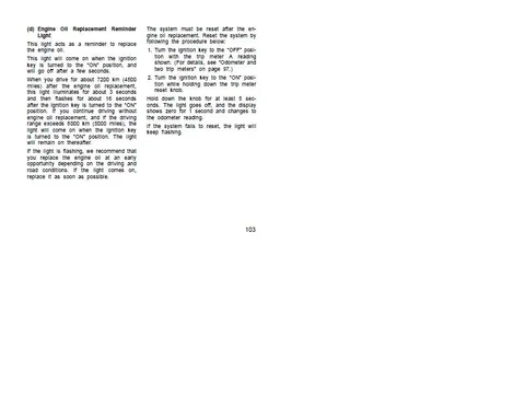

From your owner's manual:
It has to be in "Trip A."
Not the cursed owners manual!!!!!
I dont think one out of a thousand owners read those things.
