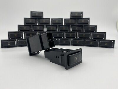

You can do this mod with a hazard switch on the cheap.
Or you can spend twice as much and get the switch with the proper symbol... I needed the correct symbol, its just easier for me.
This e-bay listing is dirt cheap compared to new:
