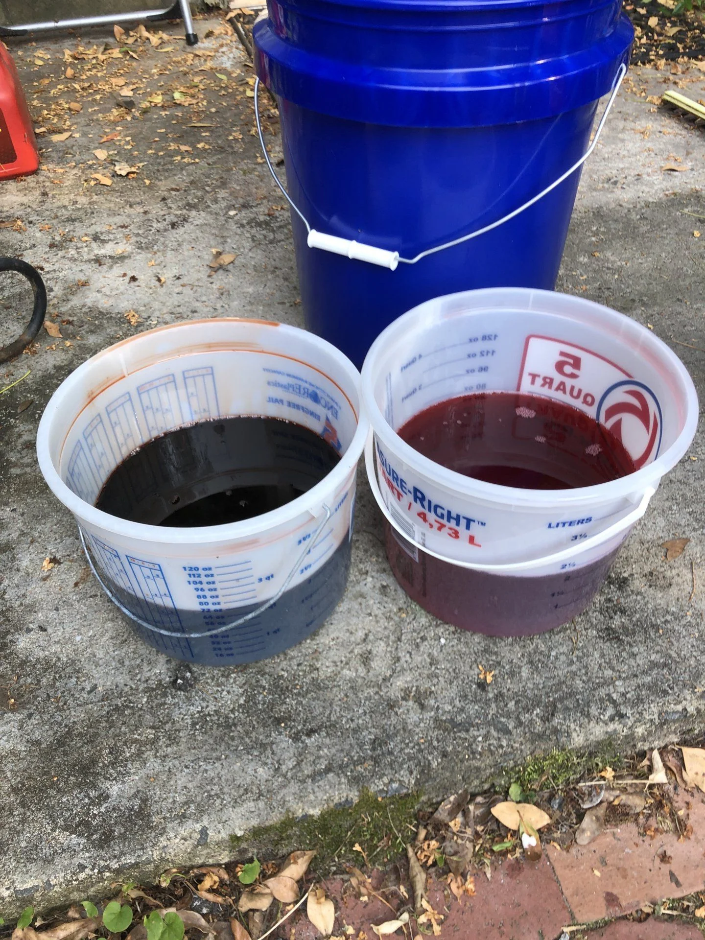

I recently purchased an 04 with 150K and the fluid had also never been changed. I did a drain and fill (about 3-3.5 liters at a time) using Toyota ATF twice now within about a month and will probably now just switch to doing it when I change my oil. The tech at the dealership may have been told never to tell a customer to change the fluid on a vehicle that claims to have a lifetime fluid.

It is my understanding that on modern automatic transmissions with electronic controls, flushing out all the old fluid at once is what creates the myth that changing the fluid is bad. The reason is the electronics that control the hydraulics have adapted to the reduced performance of the old fluid. A sudden change to all new fluid causes the electronics to have to adapt too much too quickly and results in errors.
Drain and fill, which usually replaces about half the fluid, does not seem to cause problems. Even on finicky BMW automatics (which are built by GM France or ZF). Also the filter needs changing and the gasket frequently needs replacing as well. This is why I pay a shop to do it so they can get the vehicle up on a lift and drop the entire transmission pan. As a plus you get any crap that is laying in the pan out as well.
I've done this twice (2000 BMW E46 with ZF auto @ 83k mi and 2006 LC 100 @ 123k mi). In both cases I brought extra fluid beyond what the manual said was needed for drain and fill. In both cases all the extra fluid was needed.
