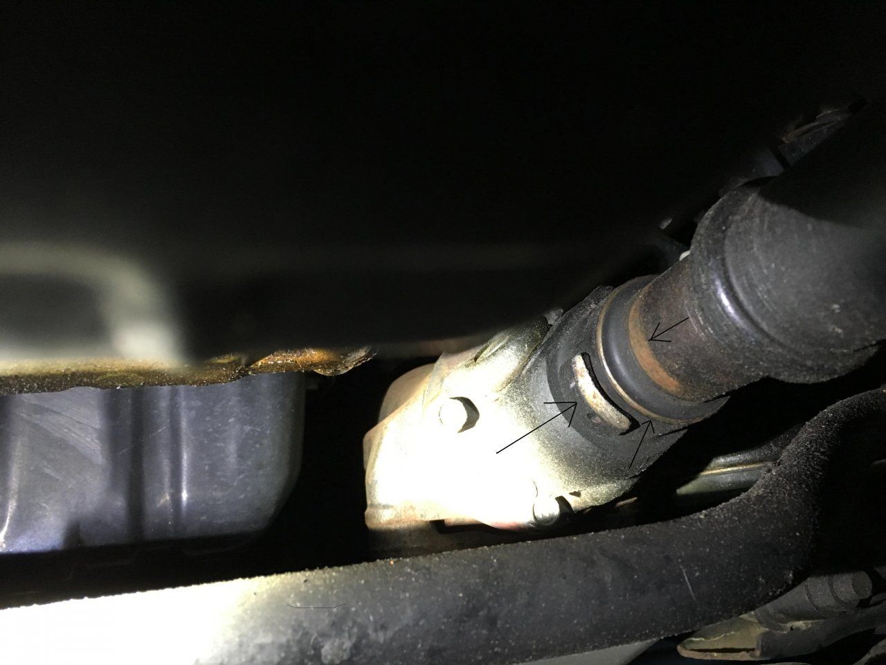

Below is an edited pic of my FRONT driveshaft. A torn rubber bushing caused my front driveline to drop down. When I put the 100 into certain low speed turns at an uphill angle, it allowed the driveshaft to contact the front sway bar causing a rub that sounded like a bump/knock. You can see where I marked the worn area with an arrow...these are the areas that rubbed. The balancing lug on the driveshaft caught most of the wear as you can see from the shiny wear surface.
This drove me crazy for a few months. Once you know where to look, it will be immediately apparent. None of these marked areas on the driveshaft should be shiny or have any wear. If you have this, check the rubber bushings that support the front driveline.
