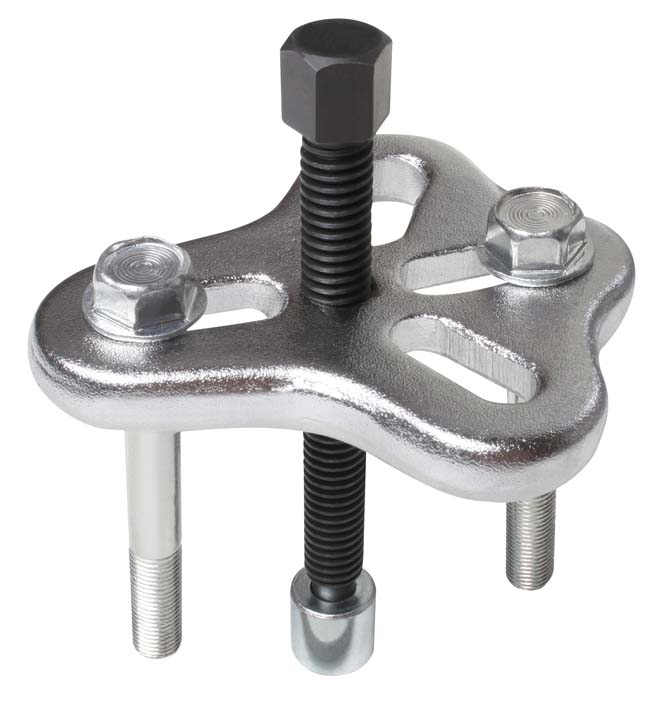

Hey folks,
How do I get this Nardi adapter thing off the steering column? There aren't any obvious bolts holding it in there after I unscrewed the main nut.
Thanks,
Gino
I'm about 50% sure a steering wheel puller is what you need. I've used one like this with success (also worked on crank pulley):
Image result for steering wheel puller
Hello,
x2.
A gear puller will also work. You need to put the wheel back in for the pawls to grab, though.
These wheels make a loud bang when they come loose.
Some WD-40 to loosen the splines will help.
Juan
I ended up loosening the center 19mm bolt, but left it attached. Then, I reattached the steering wheel, and used the leverage from the wheel to gently wiggle everything back and forth. The adapter came out very easily.
Thank you all for your recommendations. I love this group!
