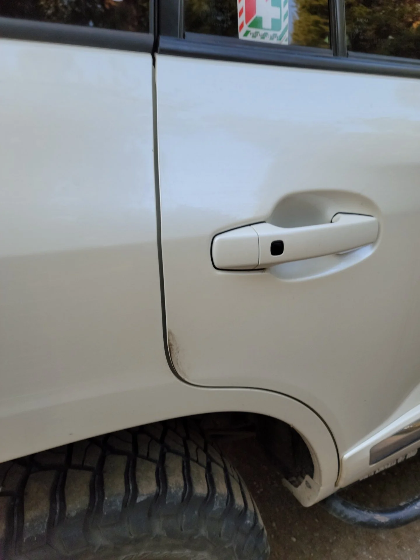

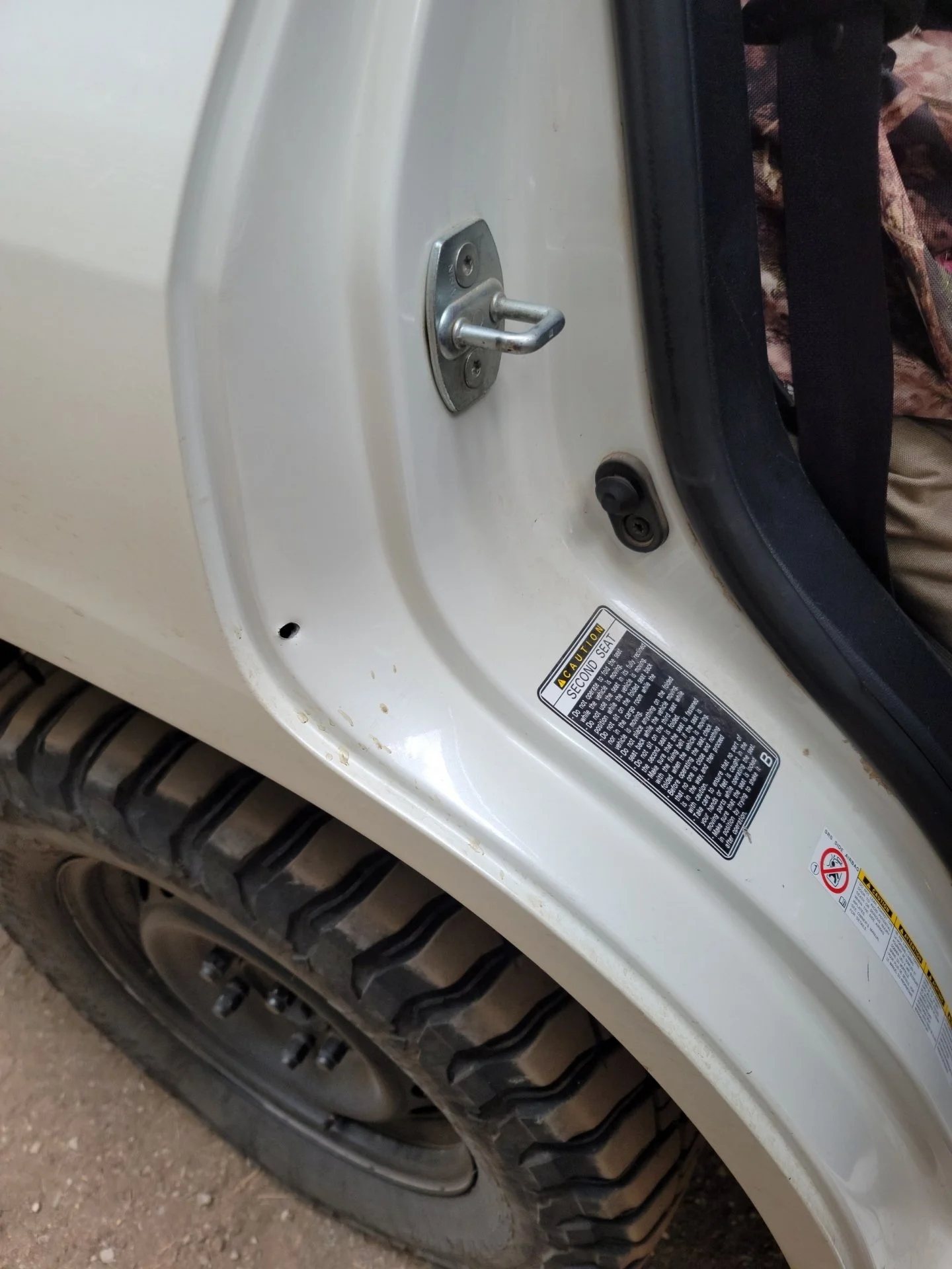

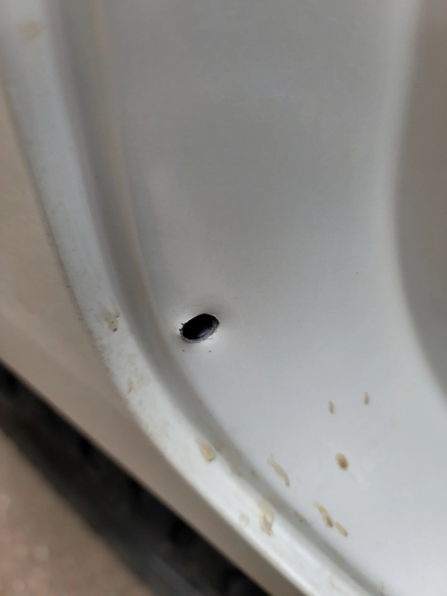

I found this hole in the rear P/S door jam.
I don't know how long it has been there. It is not bullet hole

Is there a hole in the door ?
That's from paintless dent removal. They make a hole and then stick their stuff Metal rod in to massage the dent from the inside out...... I'm pretty sure that's what it's for.... could be wrong 🤷🏽‍♂️🤓 One of my old 100 series had the same thing on the left side.
I agree. Was probably drilled to access the quarter panel for dent repair.
