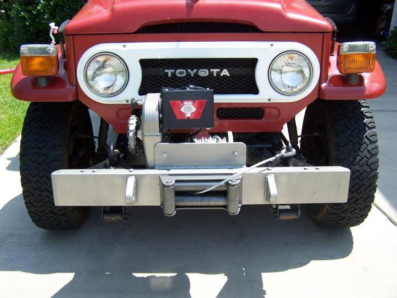

I finally wrapped up my 8274 rebuild. :cheers:
Thanks to the many ONSC guys that helped along the way but mainly diggity (Brad) who never seemed to tire of my questions.:clap:
HERE is the thread I posted on the Winching and Recovery forum at the request of a few guys. I hope some of you will benefit from it.

Cirbo gave me the same advice and I tried it but the 8274 is just so fast, I had a hard time making it look good while operating the remote. :doh:I expect I'll get used to it but I've got to find a better spot than here by my house. A 150' with a slight incline and a tree to hook to are hard to find around here so I used the snatchblock to get away with half the distance.:hhmm:
Thanks for the complements guys. I didn't provide near the details flintknapper and Awl_TEQ did as I didn't want to be redundant and could never have explained it as well. Hope others will enjoy having all those links in one place.
