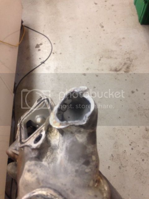

My mechanic called after finishing up a lengthy 90K service for me saying he couldn't get the bleeder values on the brakes open due to extensive rust. On top of that, he broke the thermostat housing due to rust (not sure I have part name right but photos attached). He went on to say my passenger side rocker was totally rusted (I knew that). Most suspension components are fully rusted and even the straps on the gas tank are corroded. When I said my next project for him was changing out the AHC for an OME suspension he said that it would likely not be possible due to the rust. He said in all of his experience (25 years), he has never seen a more rusted vehicle. He advised not taking it off road due to fragility of suspension and other components.

Thermostat housing is aluminum. That's not rust.

With the neck of the thermostat housing breakage. I've had the same thing that happened to me when I went to replace the timing belt.
Mechanic said he didn't know how it broke so maybe wrongly assumed rust.
This was the second 90k service at 191k miles.

Aluminum definitely corrodes, gets pitting and can crack. Just ask anyone in aviation. That could have contributed to your issue.
