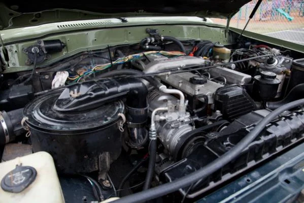

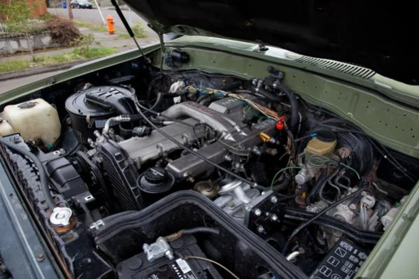

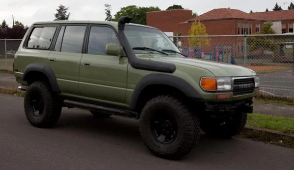

Just finished up last week. Its out for an extended road debug now through December.
Its a 94 FZJ80 with a used 1HD-T / hydraulic auto. Turned out to be much more than a conversion build as it needed paint and other cosmetic items. Should have a 4xlabs rear bumper in the next few weeks. ARB winch bar was installed after these pics.
A few pics...

What is the cable that runs parallel to the throttle cable and then disappears next to the fuel filter?
Thanks,
Jan
Jan that is the main accelerator cable. It runs from the pedal to the right side to connect to the cruise control mechanism. Then there is another cable from the cc box to the engine.
Chris
Chris
Ah, thanks! I don't have the cruise control on mine...

Where did you source the 1HD-T engine?!
are you guys getting engines in CA? Looks like a nice setup. Do you just generally setup the engine stock (boost / fuel pump)?
Nice build and as stock looking as mine, which 12v starter did you use (do you have the number)? I am looking for a stock 12v starter to use in my HD-T (at the moment it has a hybrid unit I built myself) and I wanted to get as much data as possible on the various starters so I can get one 'off the shelf'.
regards
Dave
Thanks guys. The engine is from Japan. Its set up stock at this point. Has a new rear seal, new rod bearings, and a new timing belt. Dave, the starter is a hybrid of a HD/HZ nose cone and another 12v motor I had. Any 12V number you can look up for a 1HZ, 1HD, or 1PZ should fit. Just about any other 2.5kw 12V denso motor should fit the nose cone.

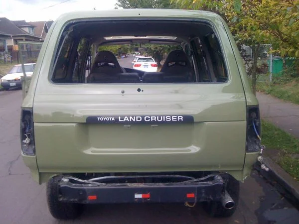

The 4xlabs rear is on now but I only have a crappy picture of that. The best MPG so far is 19. Less than hoped for but seems appropriate given the setup. 315/75 tires (35") and 4.88 gearing with a roof rack. 4.56 would probably be a bit better for highway economy.

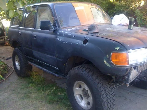

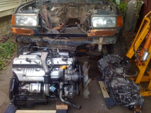

Some earlier pics. The engine removed with 1HD waiting, and after Ive already made some progress on body prep for paint.

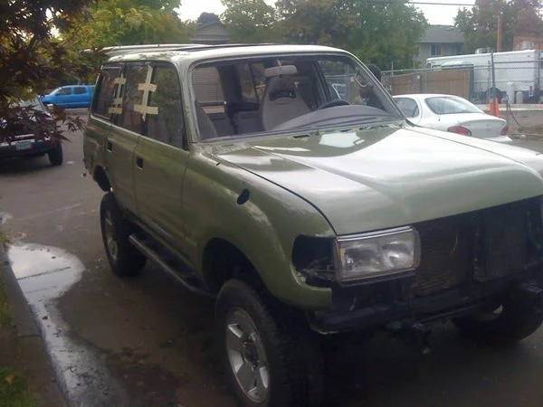

photos after paint. I did the body work and paint prep then took it to a shop down the street for the actual paint. Stock paint was peeling in spots and there were some dings but nothing major really. Windshield and rear window were removed along with everything else that could come off. Door jams and under hood were painted as much as possible.
The color is a nissan color. I spotted an exterra around town with this color and thought it would be a good fit - since its called "tank green"
