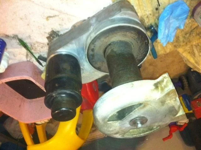

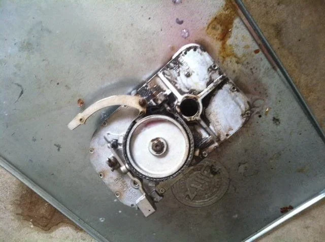

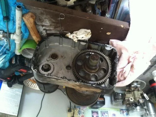

Spent the afternoon taking the winch apart and checking everything out. I plan to read a bit more on the web and the forum and would appreciate anything that you all may chime in. Are there some things that I should look at replacing for sure while it is apart? Seems to be in good shape. No metal shavings or anything, but not sure the motor works.....
Can I just use jumper cables and hook it to a battery to test it? Yes that is a real question.....
Thanks all.
Randy

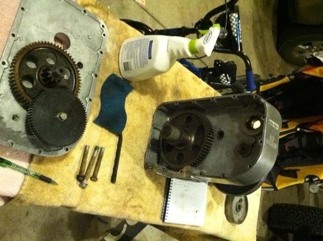

Clean Winch
I got it all cleaned up and now I am waiting for the motor to get "looked at" to make sure all is well.

I'd order new seals where the nylon bushings are ( each side of that large gear still on that case and at the end of the drum).
use a gear puller to pull that large gear off, if not you will give yourself a head ache. Don't ask how i know.
