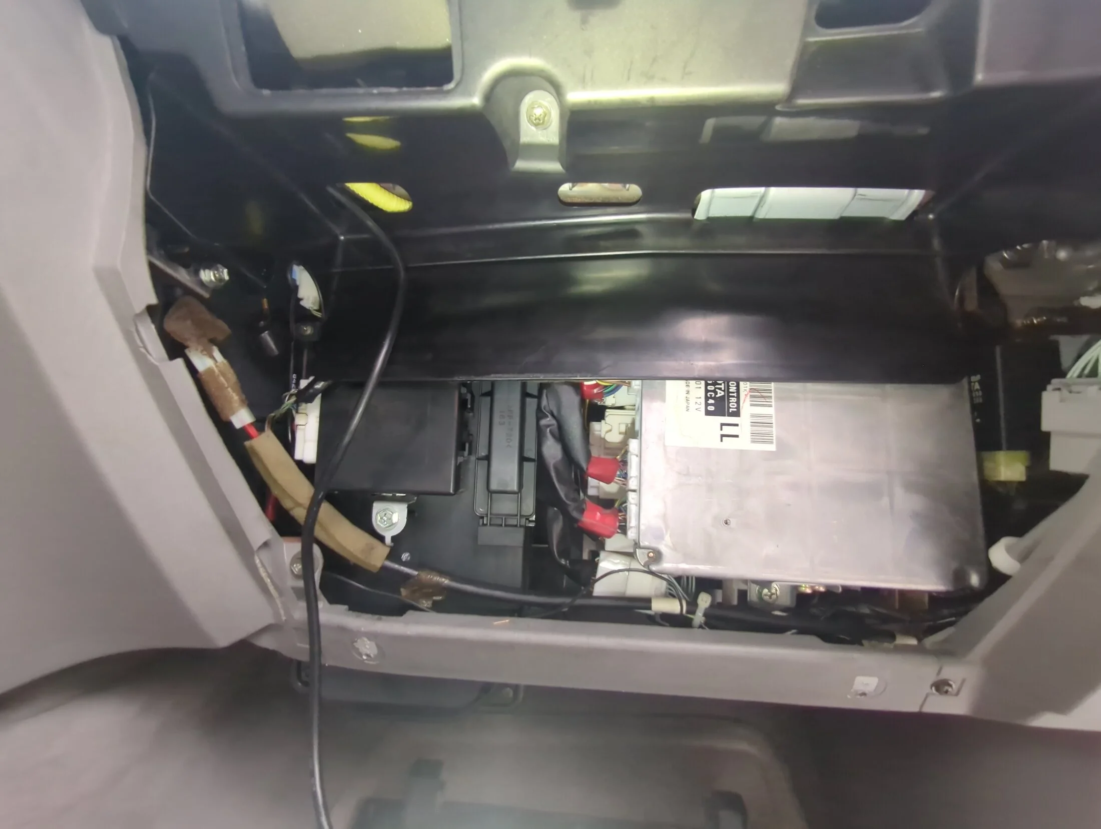

I've also discovered bluetooth has been installed. Unfortunately I don't know the trick to pair my phone. I was hoping to find a unit behind the glovebox with a "pair" button on it, but it's buried somewhere deeper (or I'm just blind to the mass of wires). Whatever unit it is, it has an old iPod cable.
If anyone has any ideas on how to get the bluetooth on--that don't involve me pulling open the nav unit and tracing the wires--let me know. After one minute with the key in the ON position, I get this message on the unit. It's not showing in my phone bluetooth pairing menu during this minute.

That Bluetooth message is actually part of the factory Bluetooth system on later year models. It only support hands free phone functions, but not Bluetooth audio. You can pair your phone in the factory menu. There is a pairing mode somewhere in the menu.
That cable in your photos is not factory. Looks like an aftermarket connection for an older iPhone. It’s likely connected to some kind of box to play audio similar to an aux in. You’re going to have to trace it to figure out what’s been installed. It’s likely a USASpec or Grom unit.
Okay, thanks! I'll dig into it and see if there's an aux cable. Just picked up some little plastic pry bars.
