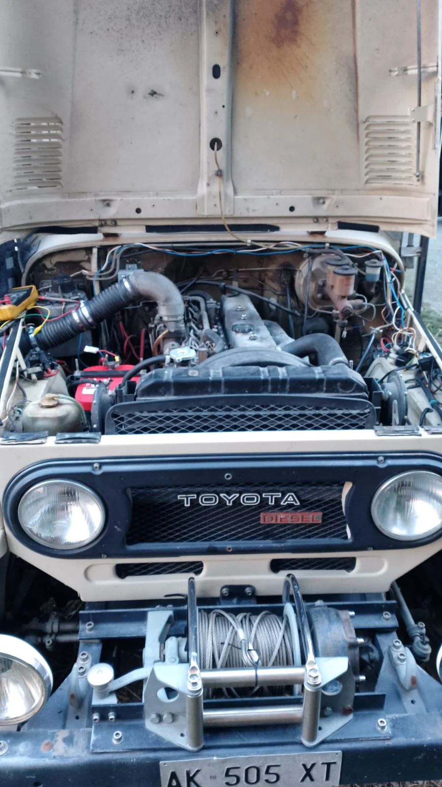

a lot of smoke....
alternator charge16 v
try to lighten the dinosaur now 32 qli / 7050 lbs and the engine struggles :deadhorse:
I probally open a more speficic topic about...
one thing i have to say : 25 years driving b and 3b, first time now h engine , beautiful !
the straight six is very pleasant engine... thinking on 2h or 1hz..... ( dreaming :steer:)
a lot of smoke....
For the smoke.. consider a blown leather diaphragm in the injection pump.
For the overcharging consider open circuit/resistive sense wire to the regulator (or to the alternator if an internally regulated alternator has been fitted).

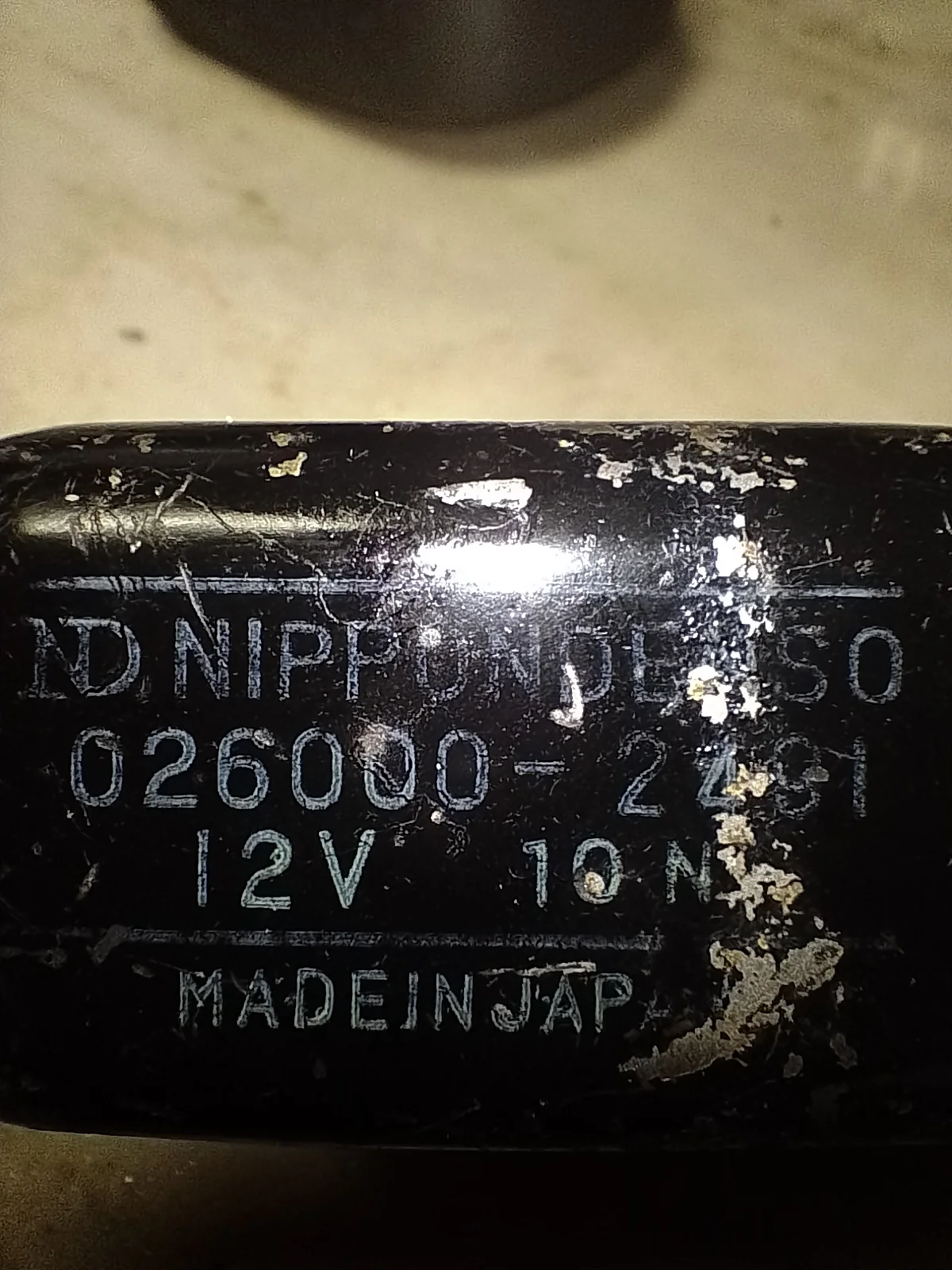

thinking about to solve i remembered that i had something similar in to my junkbox et voila i found this
this is from an old motorbike but it looks very similar so i connected the 3 wires and i was lucky !!
now i have 13,7 14 v !!!!

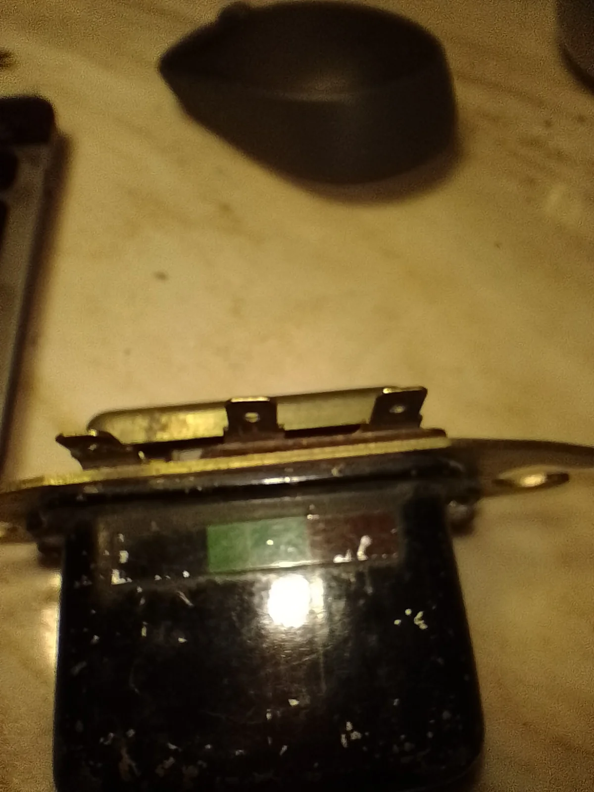

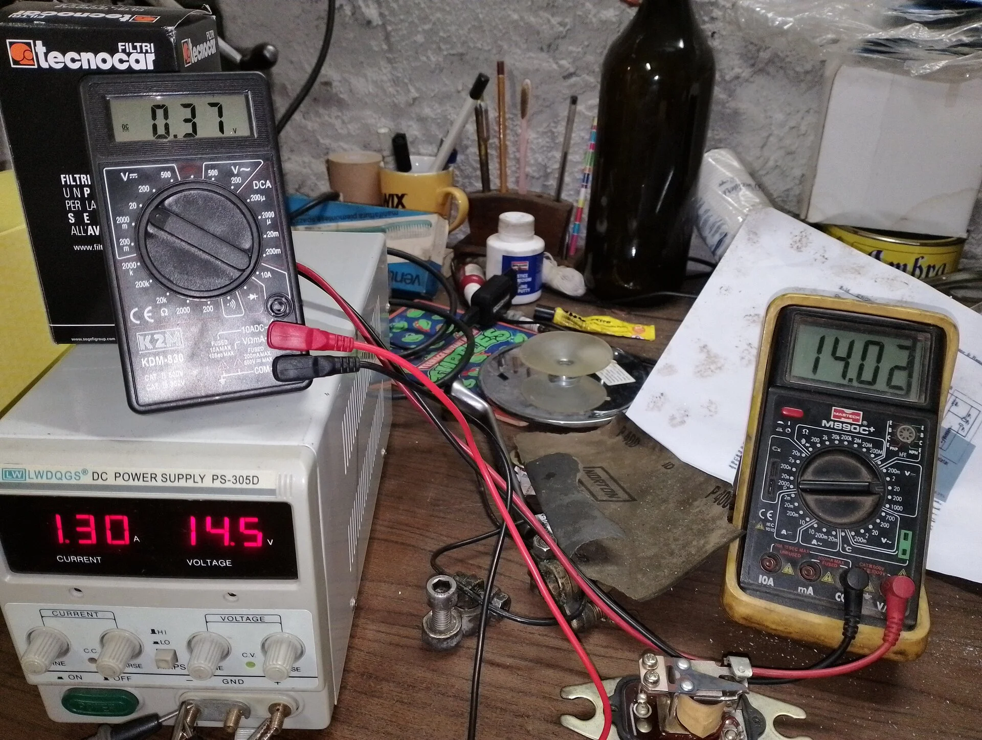

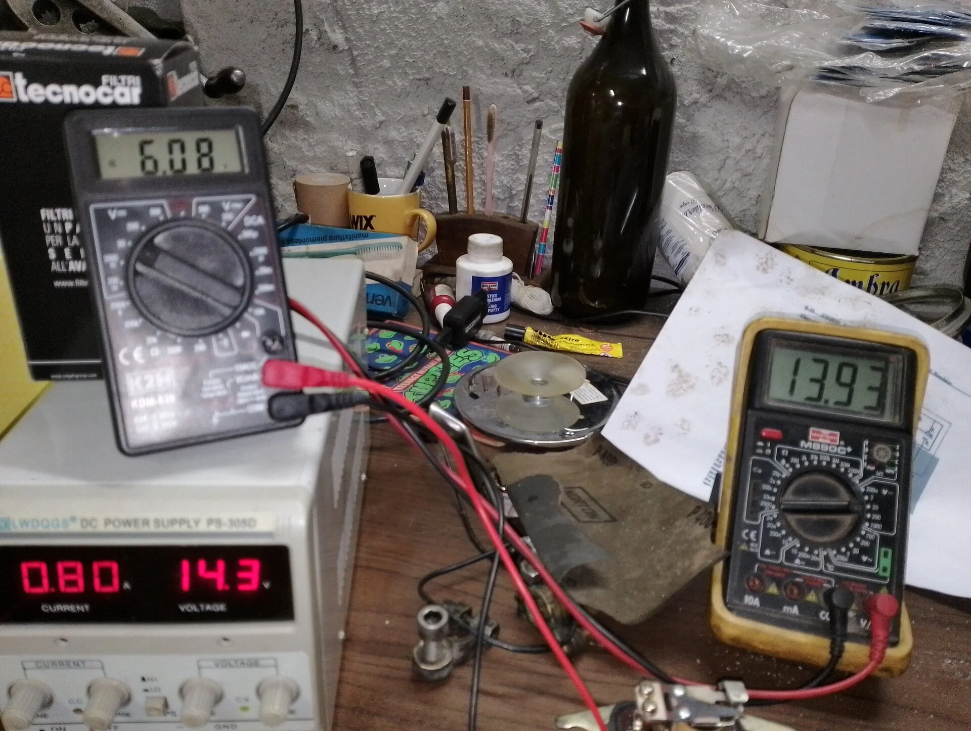

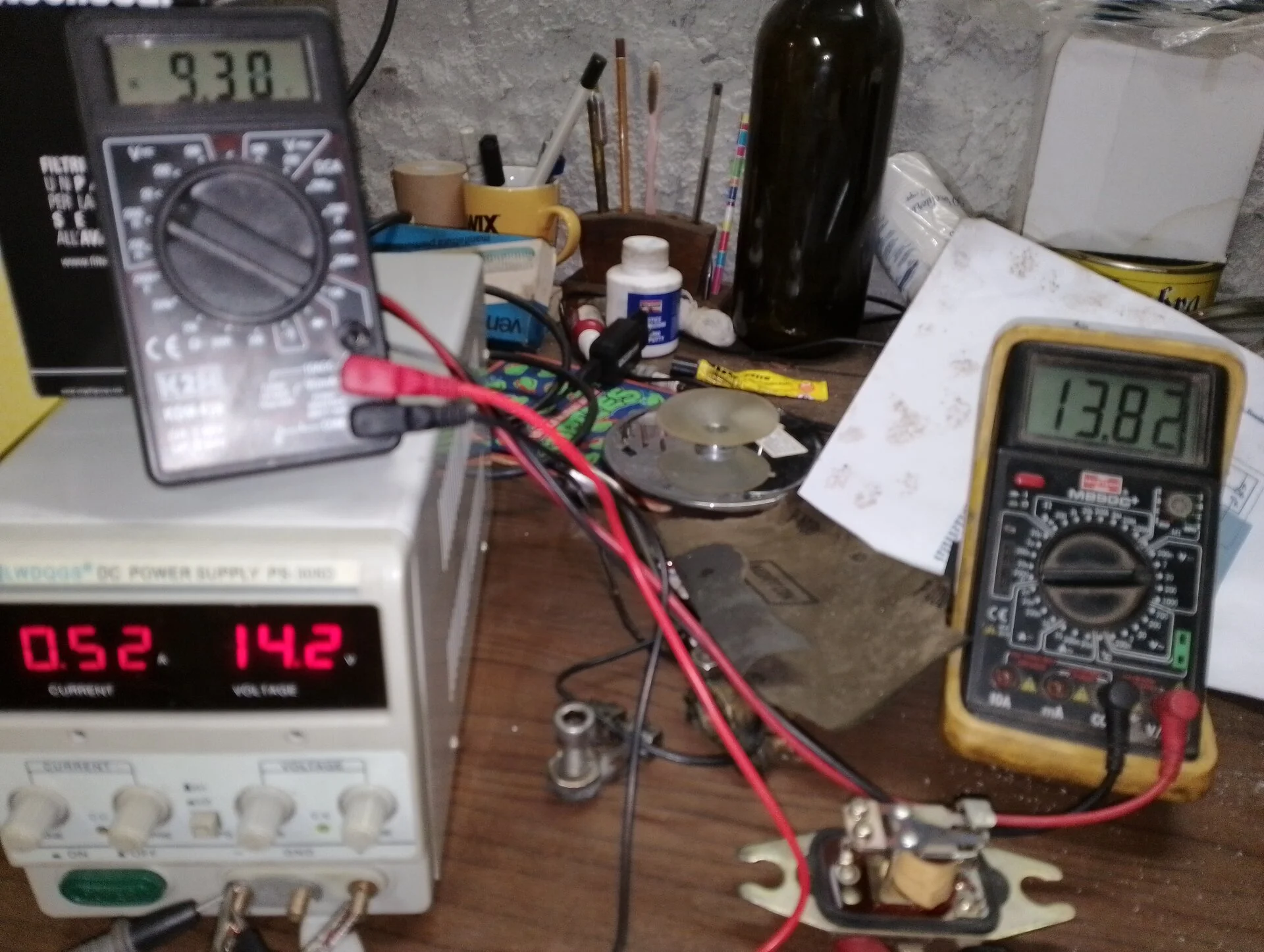

So remembering an Rudi post about VR I opened the VR and after checking the resistor i tried to adjust the arm with these result
the multimeter on the right is a "battery voltage" the other on the left i a "field voltage"
the photos are about the motor bike regulator that on the bench it has a "trickle position" while
one strange thing is that the factory VR has not a trickle charge transition :
it go to full charge to no charge and i was not able bending the arm to find a trickle charge position
i have partly solved because when installed on the hj without load i have 14-14,5 but with headlight on i have only 12,5 ... never less.. with idling engine and 13 at 2000 rpm : NOT SOLVED !
