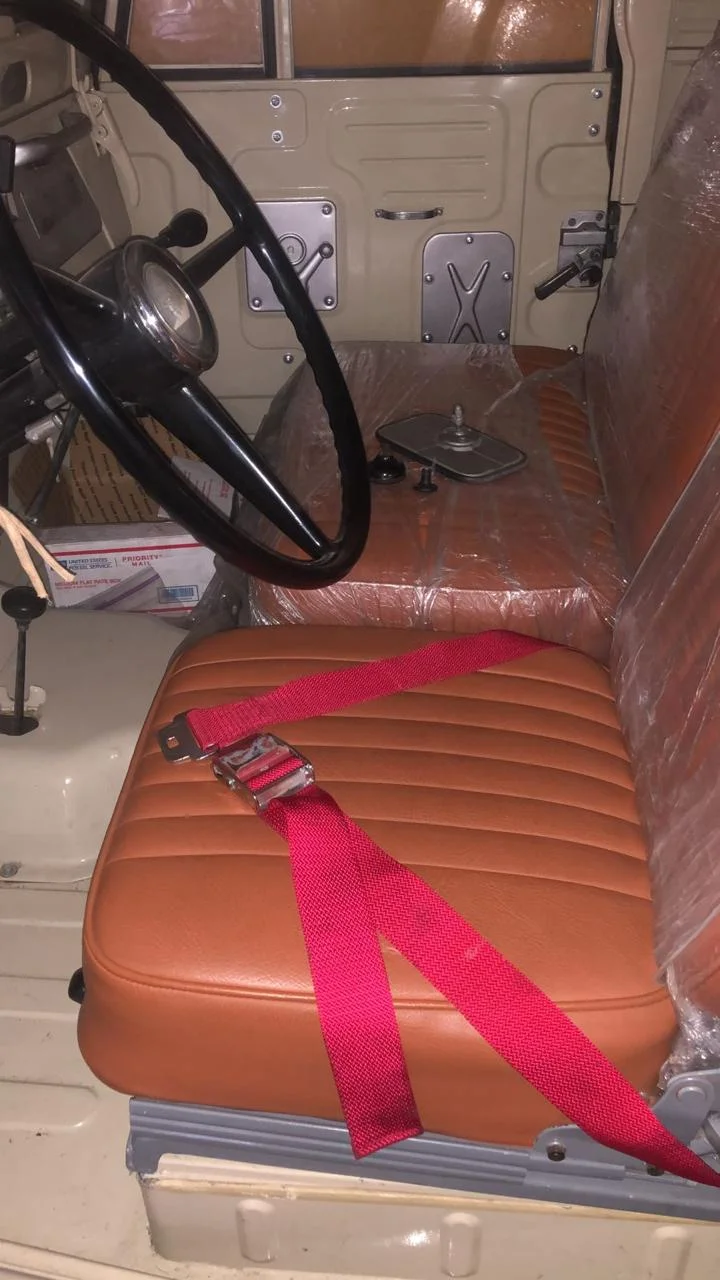

I now have my red 1965 seatbelt! Package was lost for nearly one year.
The straps were cleaned and wow do they look nice:

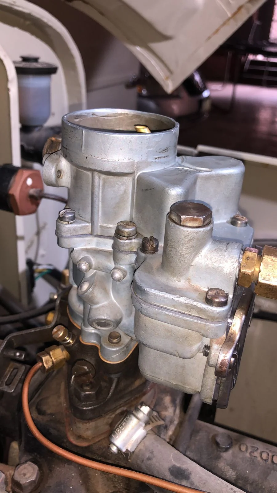

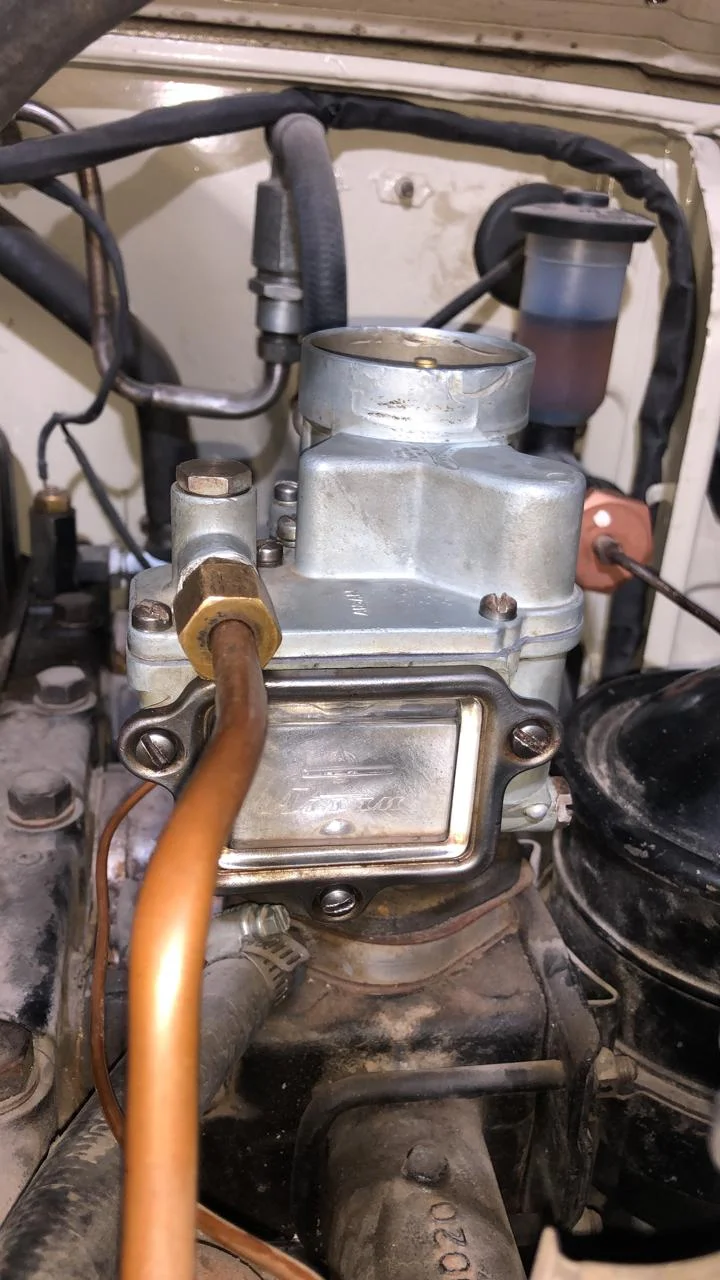

And my carb was fully rebuilt using a kit I got of "Flea Bay" as @HelloKitty65 would call. It was a perfect fit and my carb does not leak anymore:

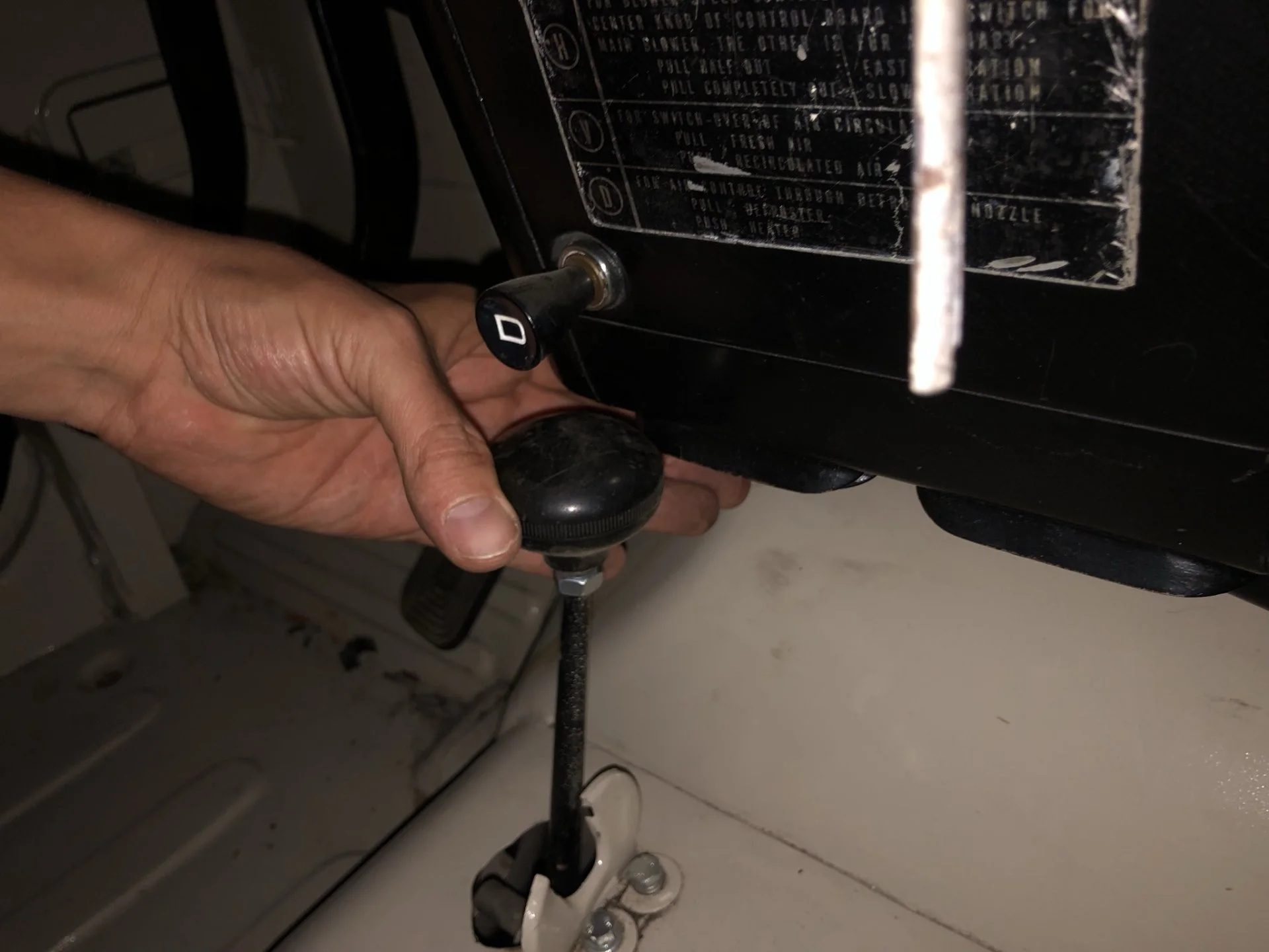

My winch knob hits the heater when pushed forward, do I need a finer one?

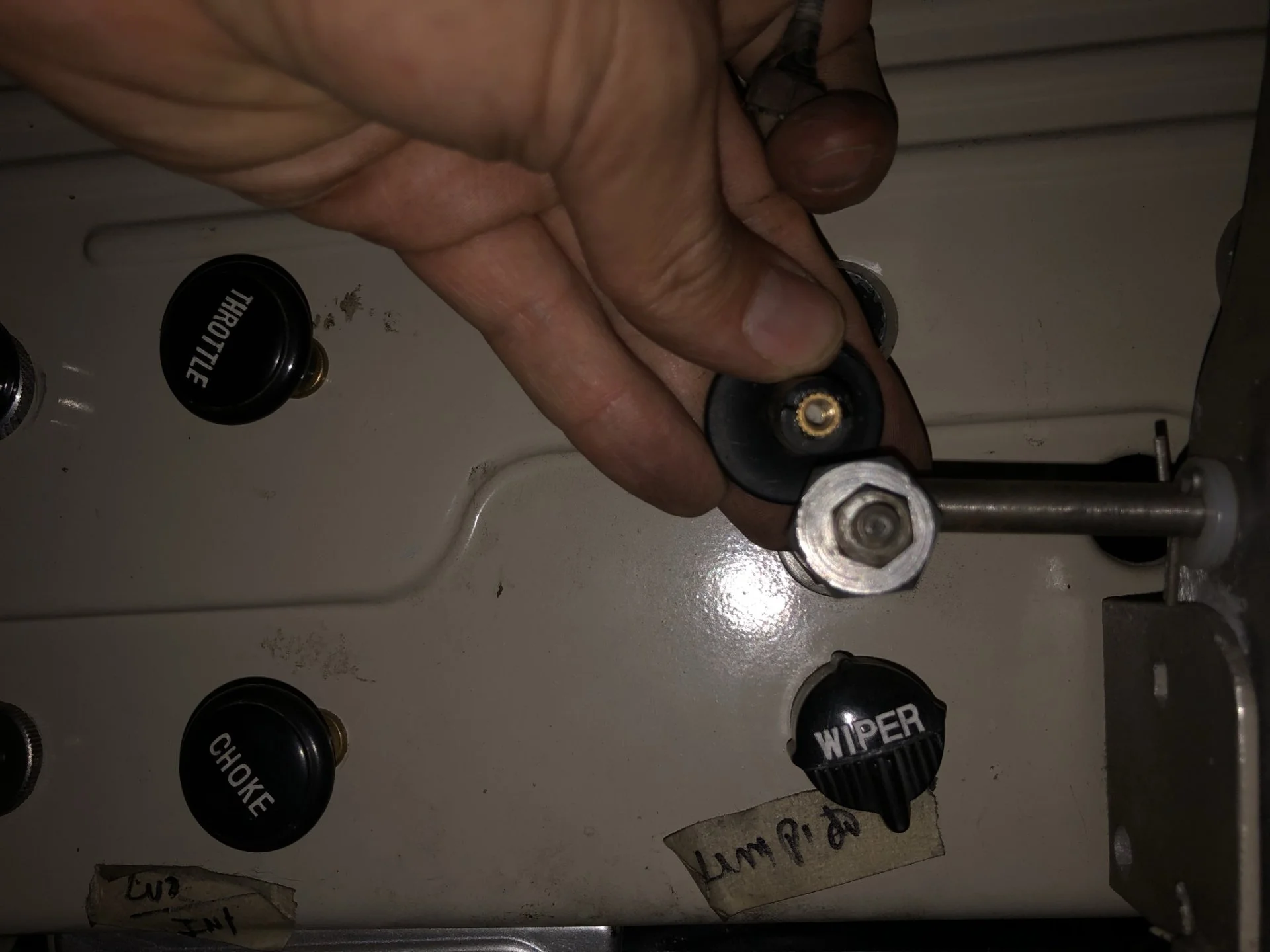

I also need help with this, the knob I bought from @thecrazygreek, which is beautiful, does not fit my F.D. cable. It is a M6 width and the knob is for an M4 I believe. Does this mean my pull cable is not OEM? I am confused.

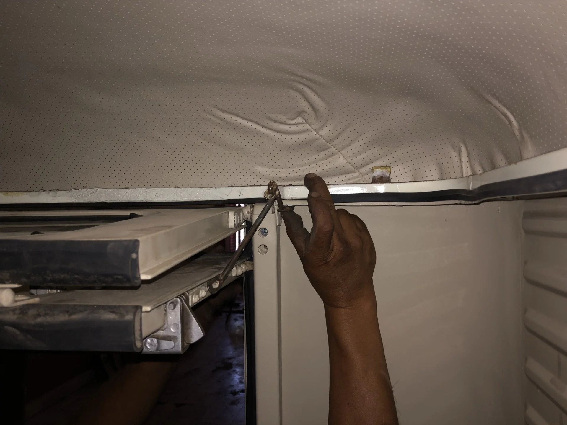

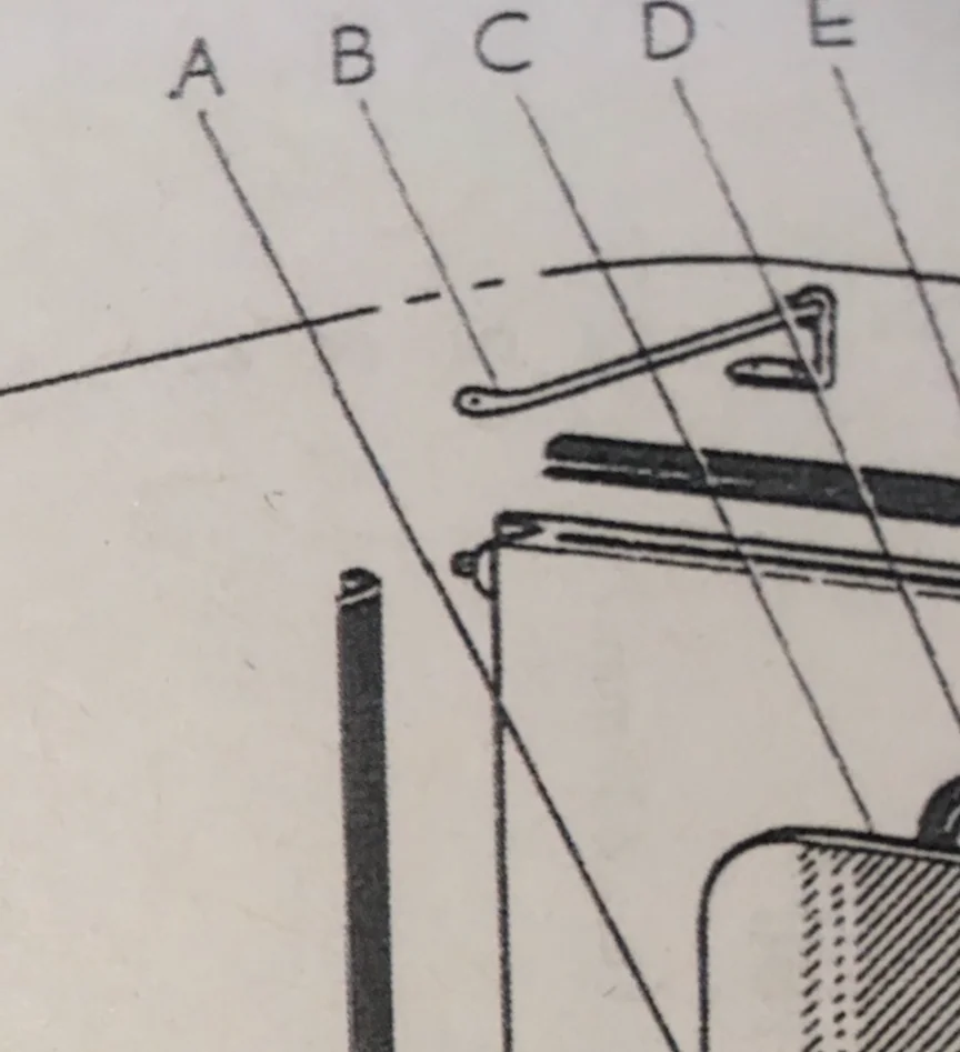

And lastly, does anyone know how the rear metal loop that hold the rear bifold door fits? I am unable to make it work!

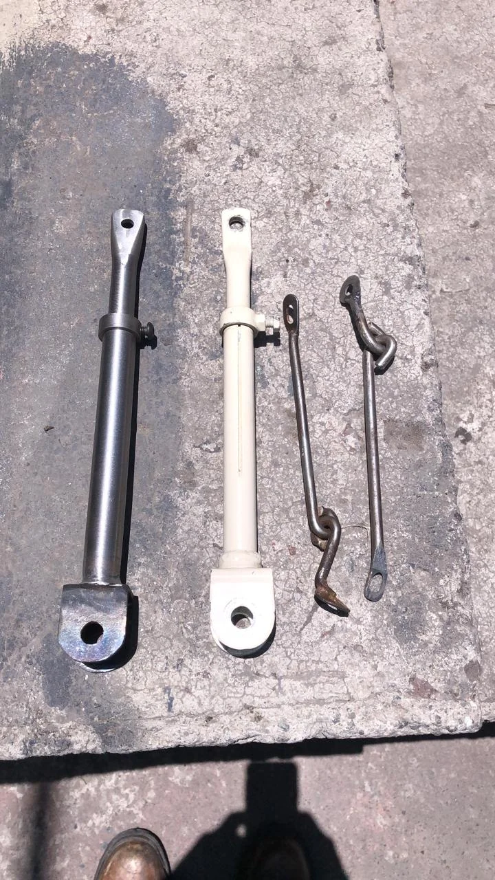

And lastly, I decided to commission a local smith to do a repro of the passenger telescoping mirror and aforementioned "loop" because I only had one of each.
Not bad for a small town smith I'd say, still a working progress:
IIRC it was @owensexport that determined there were three different thread diameter/pitch possibilities for the early FD cables. So the fact that your knob doesn’t fit is not determinative of whether your cable is stock.

Your cruiser is coming along nicely. I remember i when installed a tuffy console on a 79, the gear shifter kept hitting or bottoming out and would not allow me to shift comfortably so i got the torch out and proceded binding the shift lever until it did not hit the console. I don't recommend doing that to the PTO lever but if you can cosmeticly make it look "right" and make it functional...that could be a possibility or shortened it enough to clear the heater. Anyhow, it will be interesting to see how you remmendy this issue.

Message me on that FD KNOB. I'll get you a 4mm version free of charge. Just handle the shipping and I should get one to you in the next few days.
There's only two options regarding the threads. 4mm and 5mm. You got one of my 5mm. I believe they went up in size in the 64 to 65 year area...

Thank you for the kind offer. I believe you sent me a 4mm but the "male" is 6mm. I am extremely confused and this is why I believe I may have an altered, non-stock, F.D. set up.
Would you be able to do a 6mm? I'd be happy to pay for it.

What I need is to see a picture of it actually holding the door. When I try it isn't long enough to hook.
J
I would like to see that too.😊 Ijust found a pair of those in my office drawer. I was going to post a pic and ask where they go. I pulled them off a ‘64 that I parted out in ‘92 and just don’t remember any more.☹️
H
Hence my original post.
