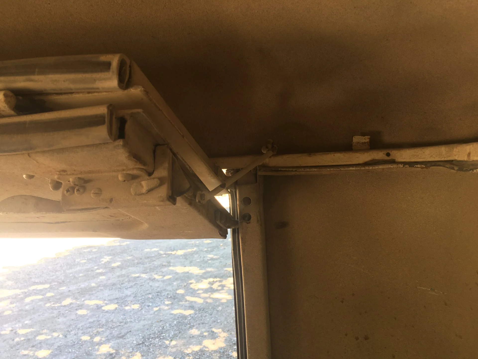

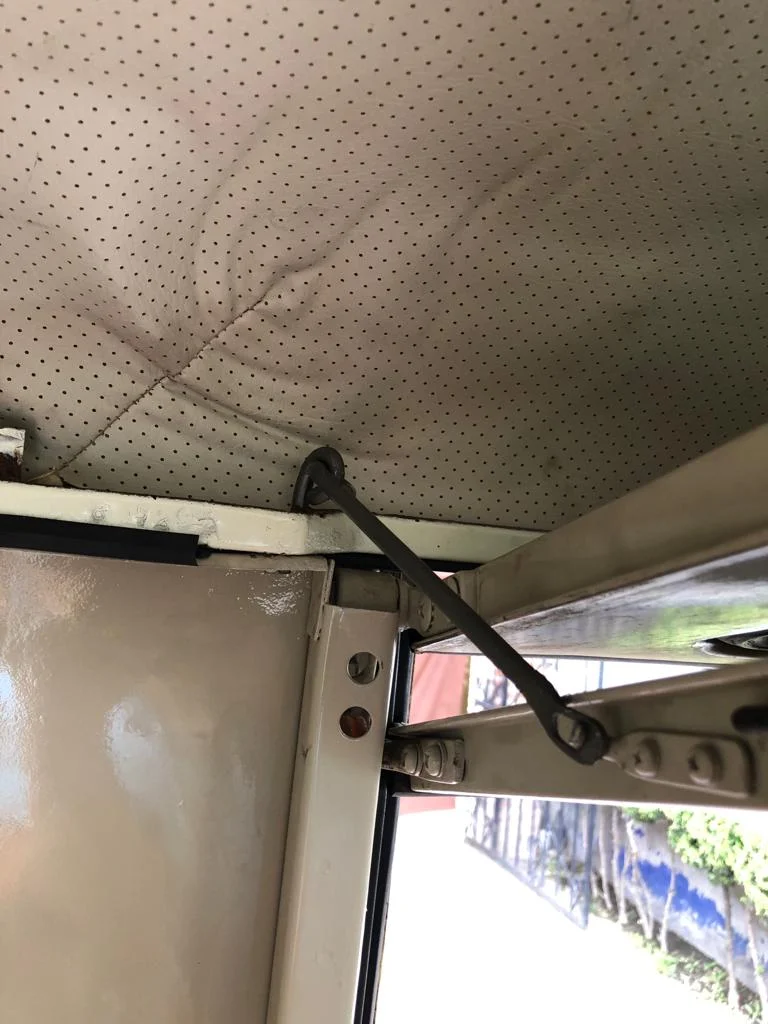

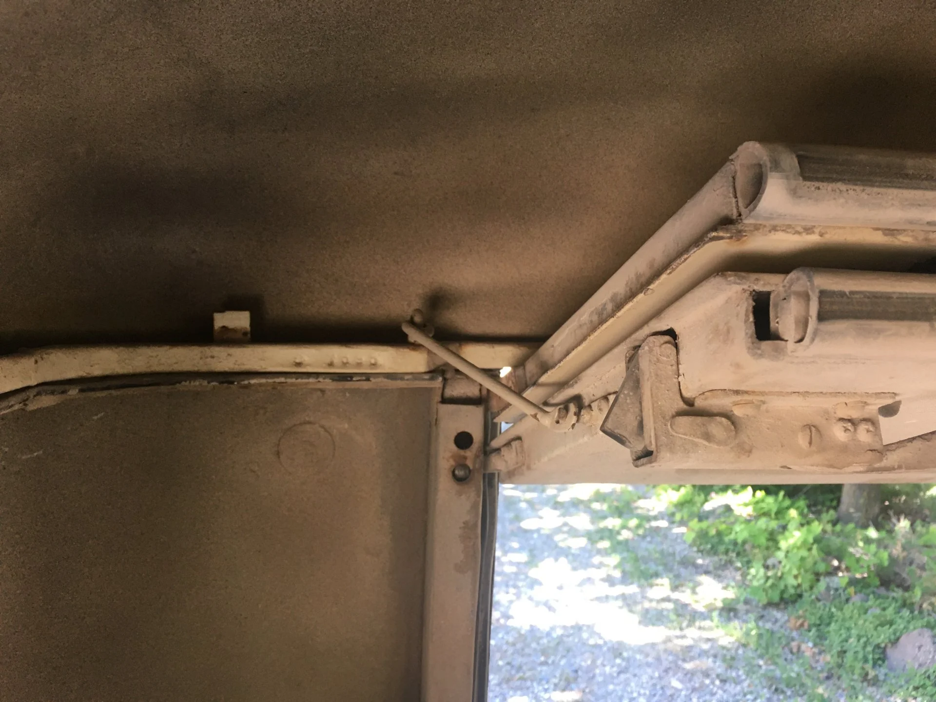

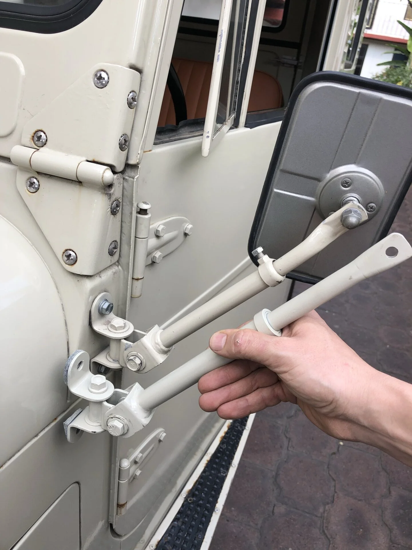

The loop is bolted in the roof channel. It’s length actually lifts the folded door a bit when hooked in place. Lift the folded door up at the middle joint, hook one side, let down so hook is holding folded door up, then lift again and do the other side. I guess this is meant to take the load off the vertical door channel and roller when bouncing down the road with the door open. I very rarely do that as I’m on dirt roads and get a tremendous dust storm in the rig if I do. 😂

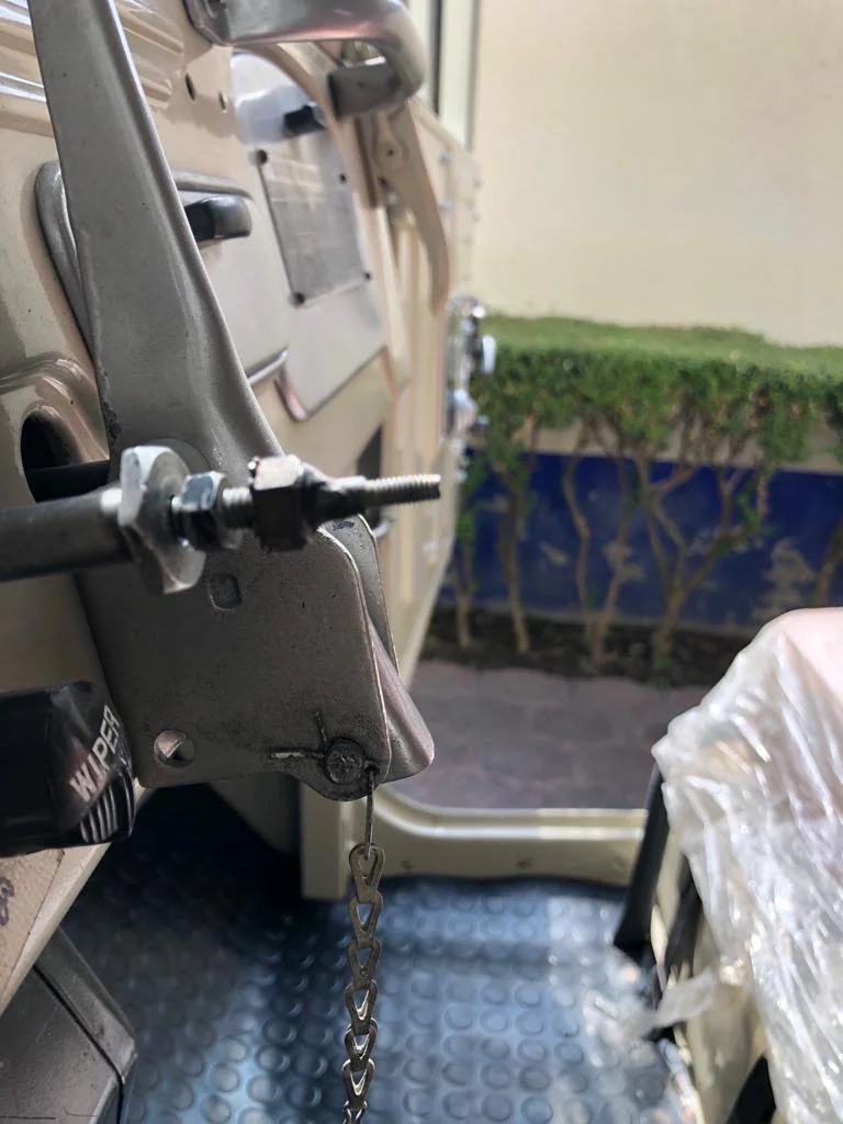

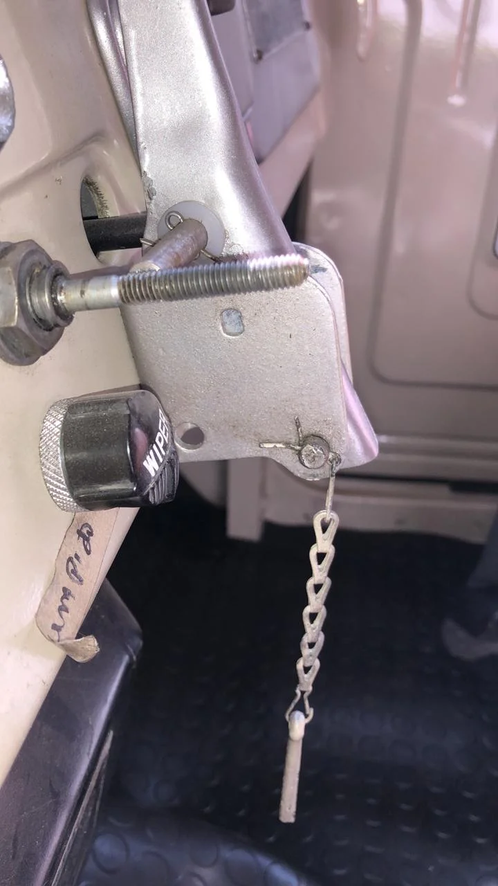

Your FD cable pic is a bit soft but it doesn’t look original, the big hex thing should be a nut that turns on a larger diameter shaft. The FD knob should screw on to the pull cable shaft that should be 4mm diameter iirc as noted by @65swb45. Maybe your pull cable is broken at the shaft as it appears to not stick out like it needs to to thread the knob on. A side pic might help to show what’s going on with it.

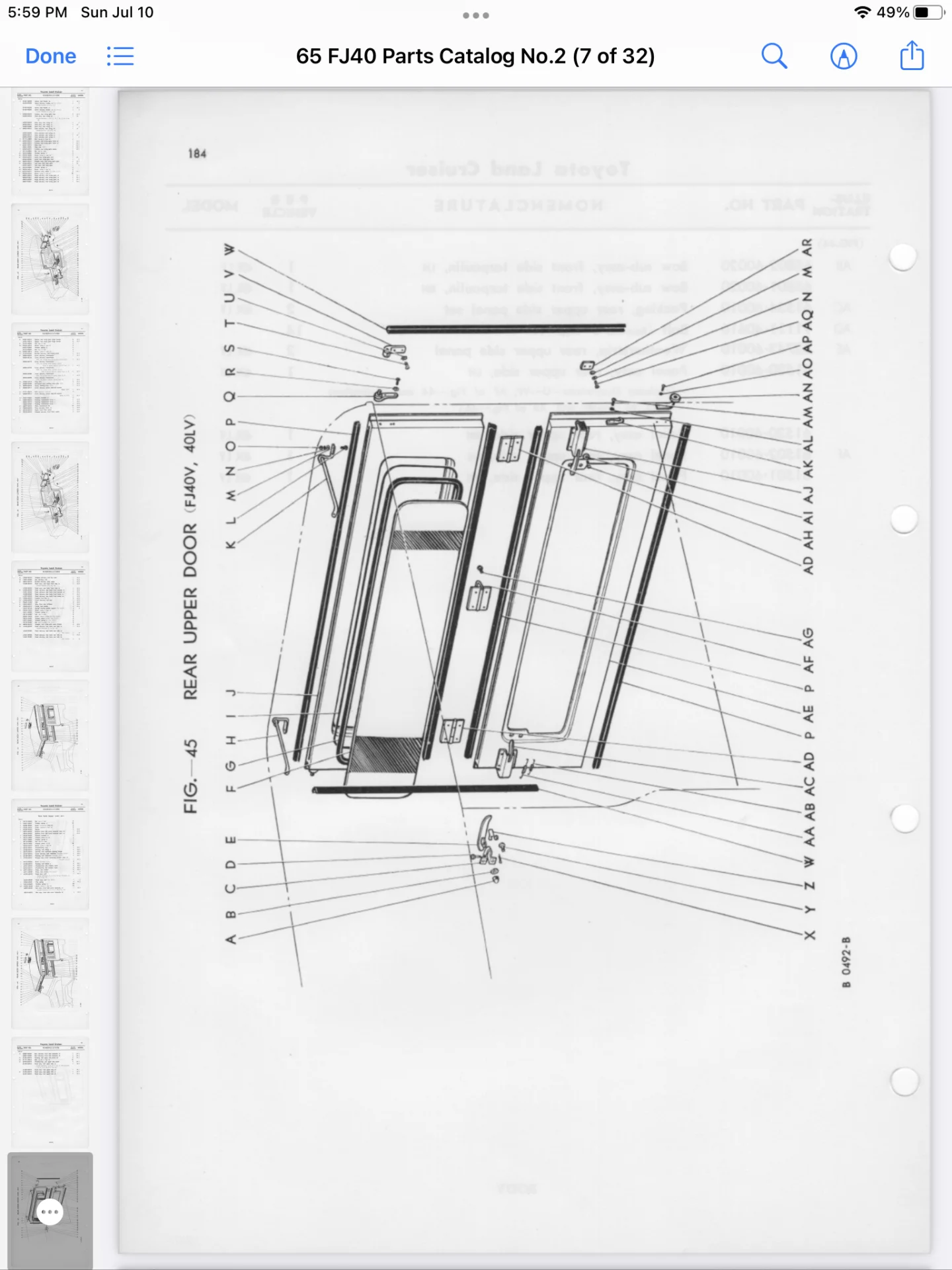

Not a lot of detail in the parts book pic but it does show the orientation of the “back door stay sub-assy” parts H & K. They sit down in the roof channel.
I would like to see that too.😊 Ijust found a pair of those in my office drawer. I was going to post a pic and ask where they go. I pulled them off a ‘64 that I parted out in ‘92 and just don’t remember any more.☹️
This is what I have Mark, this is a zoom out of @tahoe40/45 's picture from an early manual, it gives you the orientation of the bases at least:
Thank you so so much! This is exactly what I was looking for.
Here's a side picture of the F.D. thread, it is definitely 6mm. @thecrazygreek Can you make a 6mm thread button? If not I believe I can convert a 5mm one to 6mm.
I’ll look at mine closer tomorrow, yours doesn‘t look original but if a 6mm fits then go for it.

Message me on that FD KNOB. I'll get you a 4mm version free of charge. Just handle the shipping and I should get one to you in the next few days.
There's only two options regarding the threads. 4mm and 5mm. You got one of my 5mm. I believe they went up in size in the 64 to 65 year area...
Good Sir, I'd like to order a 5mm thread F.D. knob from you. Would you be able to make it 6mm? If not, 5mm will do!

I think I can pull off a 6mm but I'll have to find a proper insert that will fit the skinny neck of the FD knob.
5mm is ready to ship if you want to go that route.

Happy to take, and pay for, the 5 mm.
Please send me the total via message and I'll get it to you ASAP, shipping to 07928

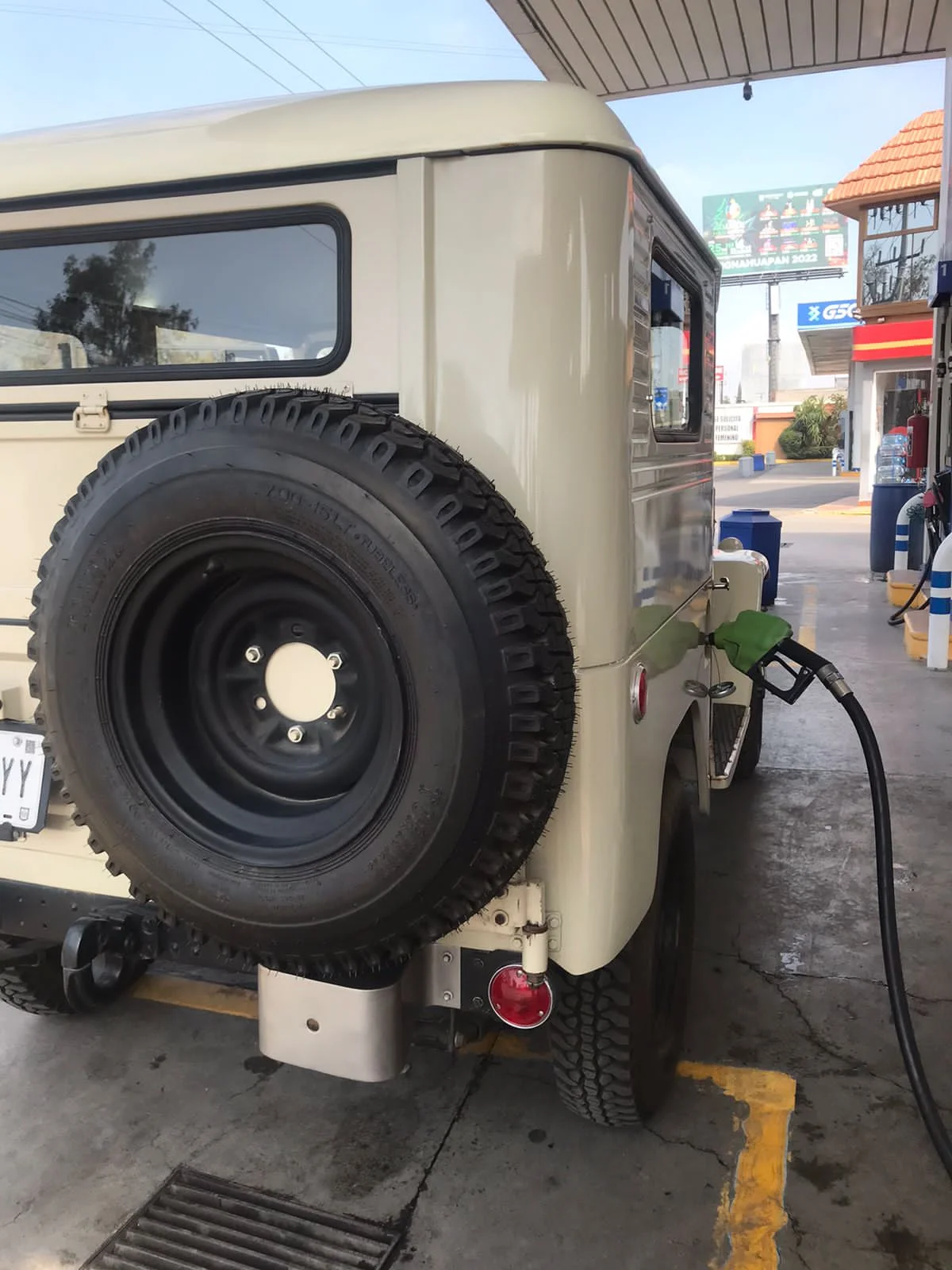

Pumping its first stop at the gas station and not filling it with bottles.

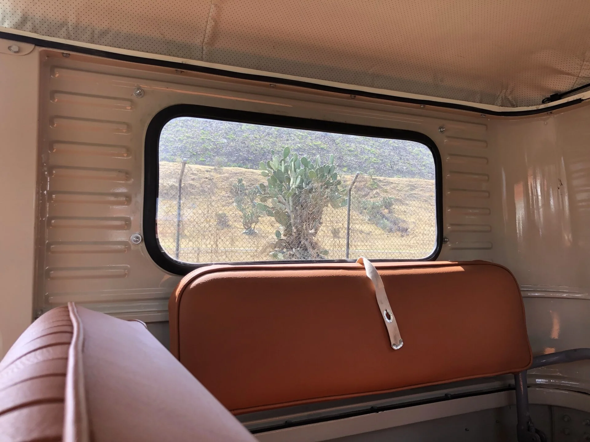

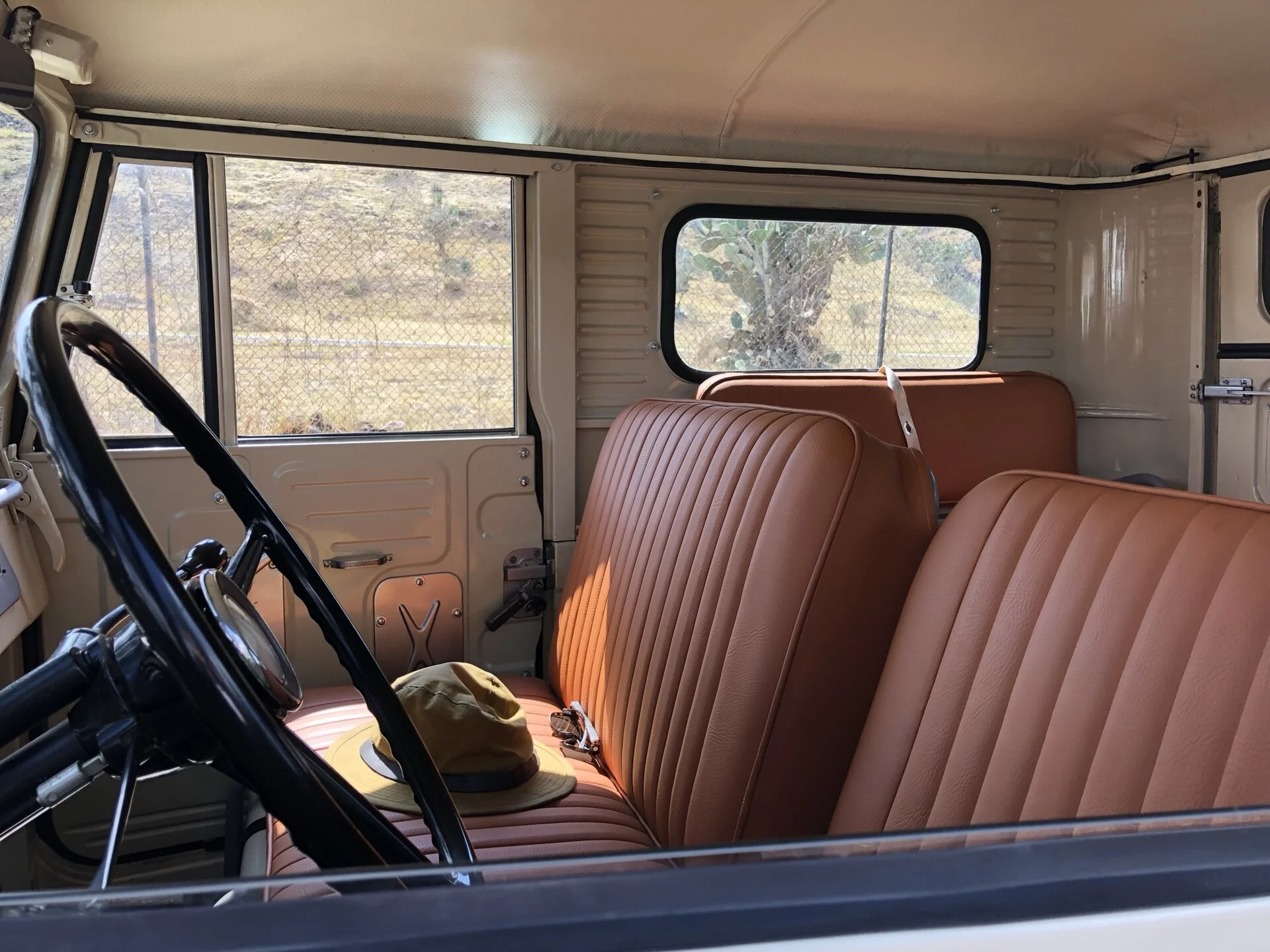

I took advantage that we redid the wiring for the wiper motors and added a third wire to subtly install interior lights (small LED strips) hidden inside the roof.
I am pleased with the outcome.
I really liked how the seats came out, they're comfortable too!

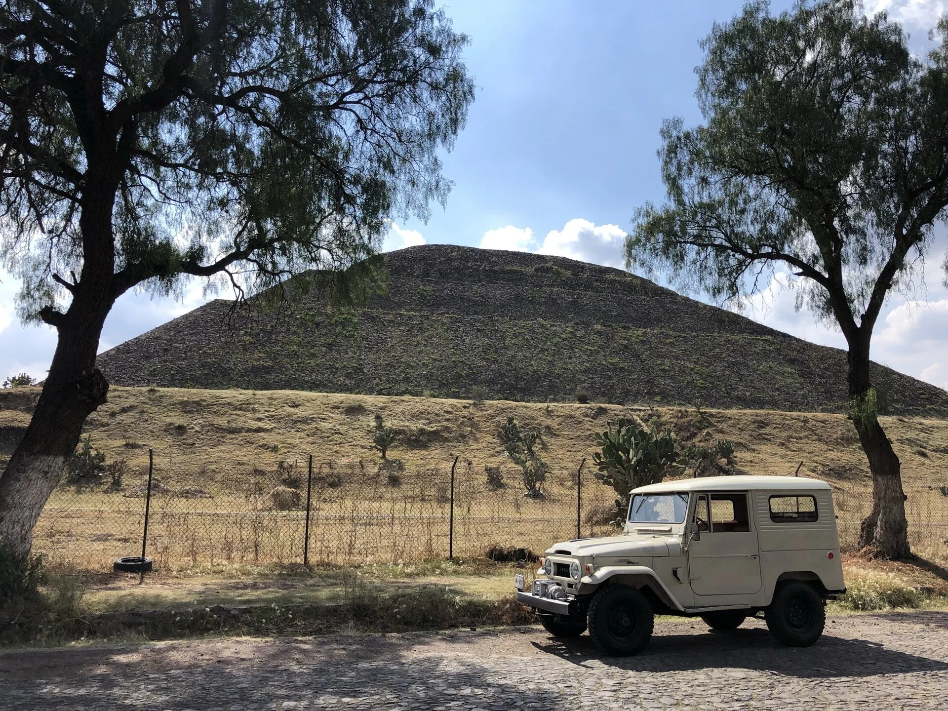

Here she is, at the Pyramid of the Moon in Teotihuacán:
