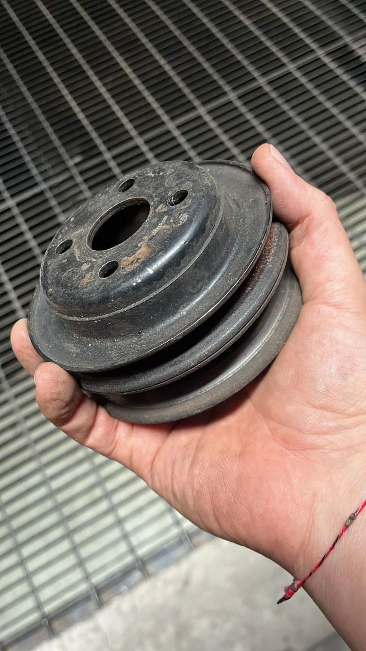

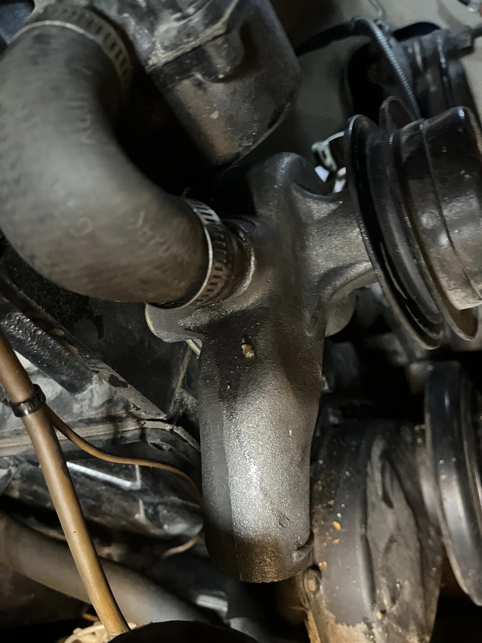

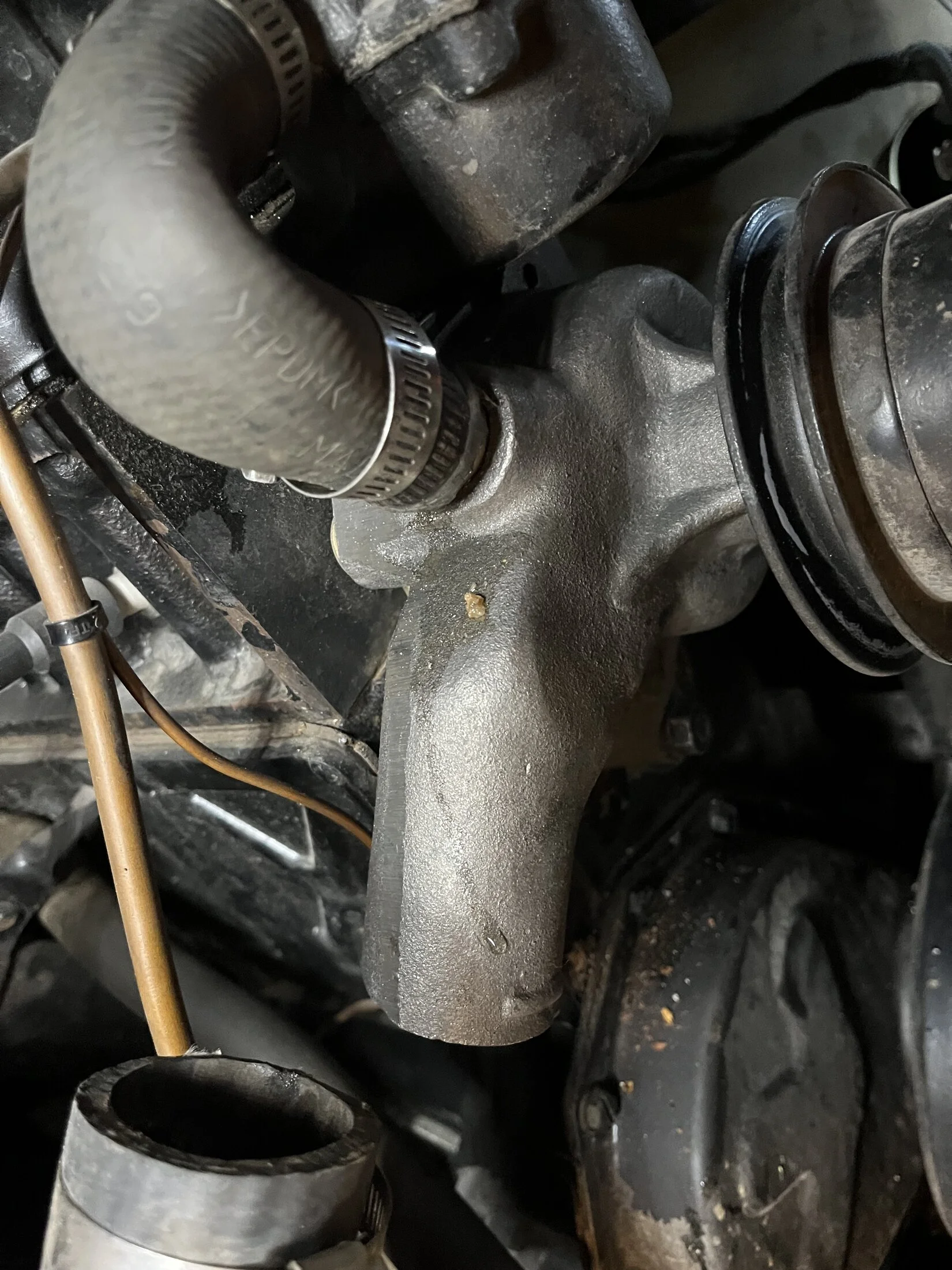

Now comes the installation of the new pump which is later years and non OEM, we work with what we have not with what we want, which is going to be pressed in order to align with the crankshaft pulley. Alternativley, I also have a later pump pulley for two bands and this may give us a gain on the distance in aligning pulleys if parting from the second grove.

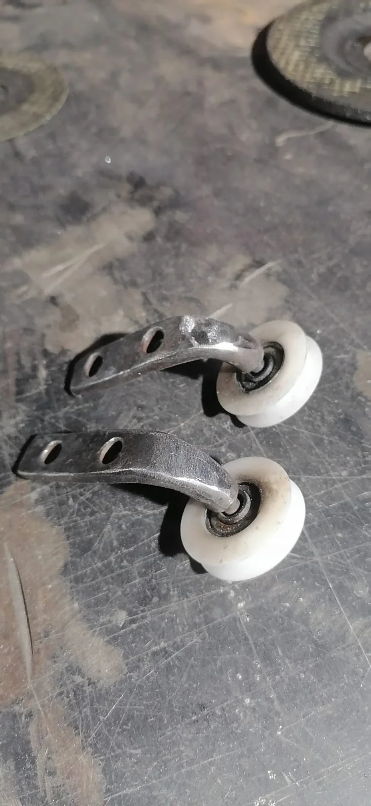

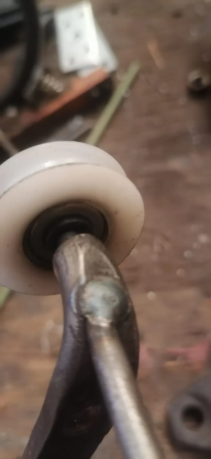

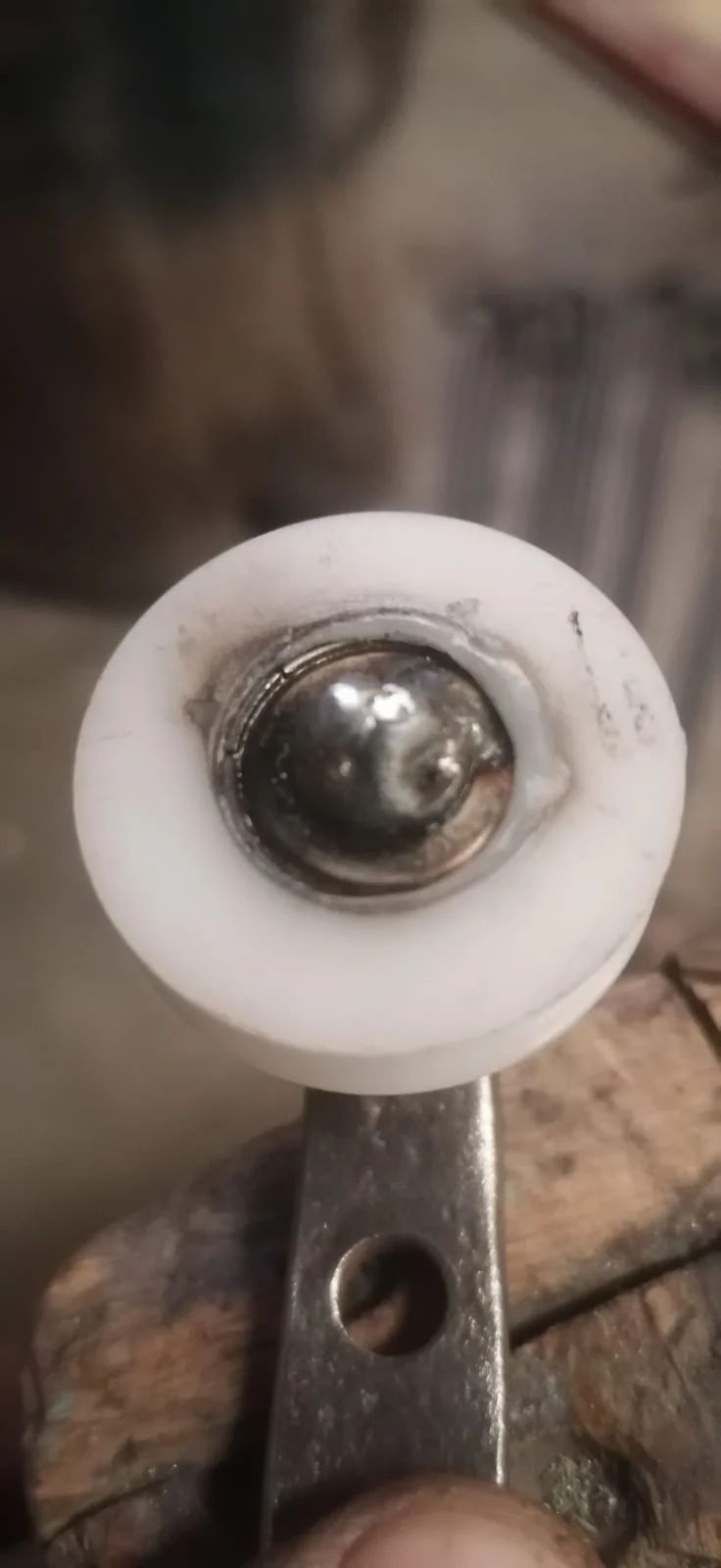

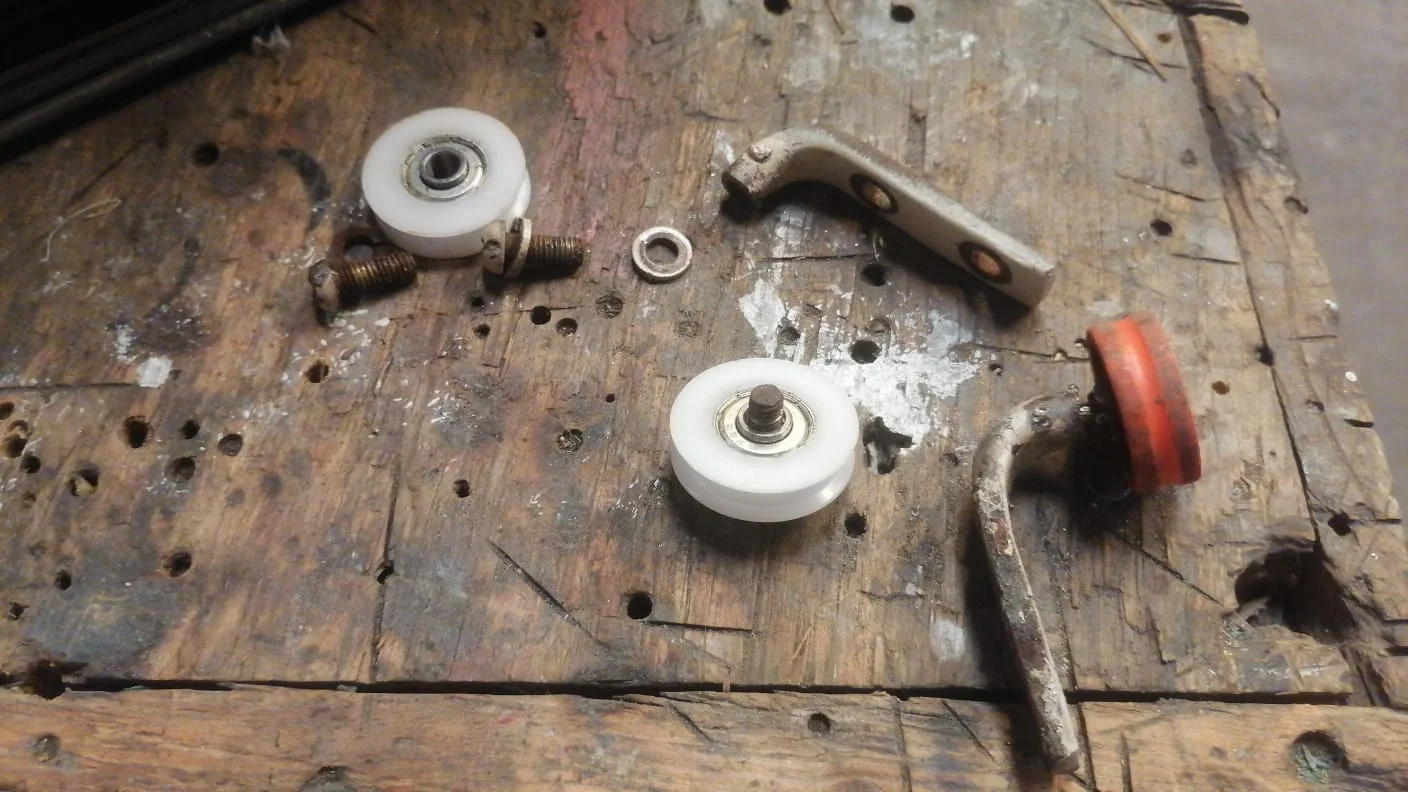

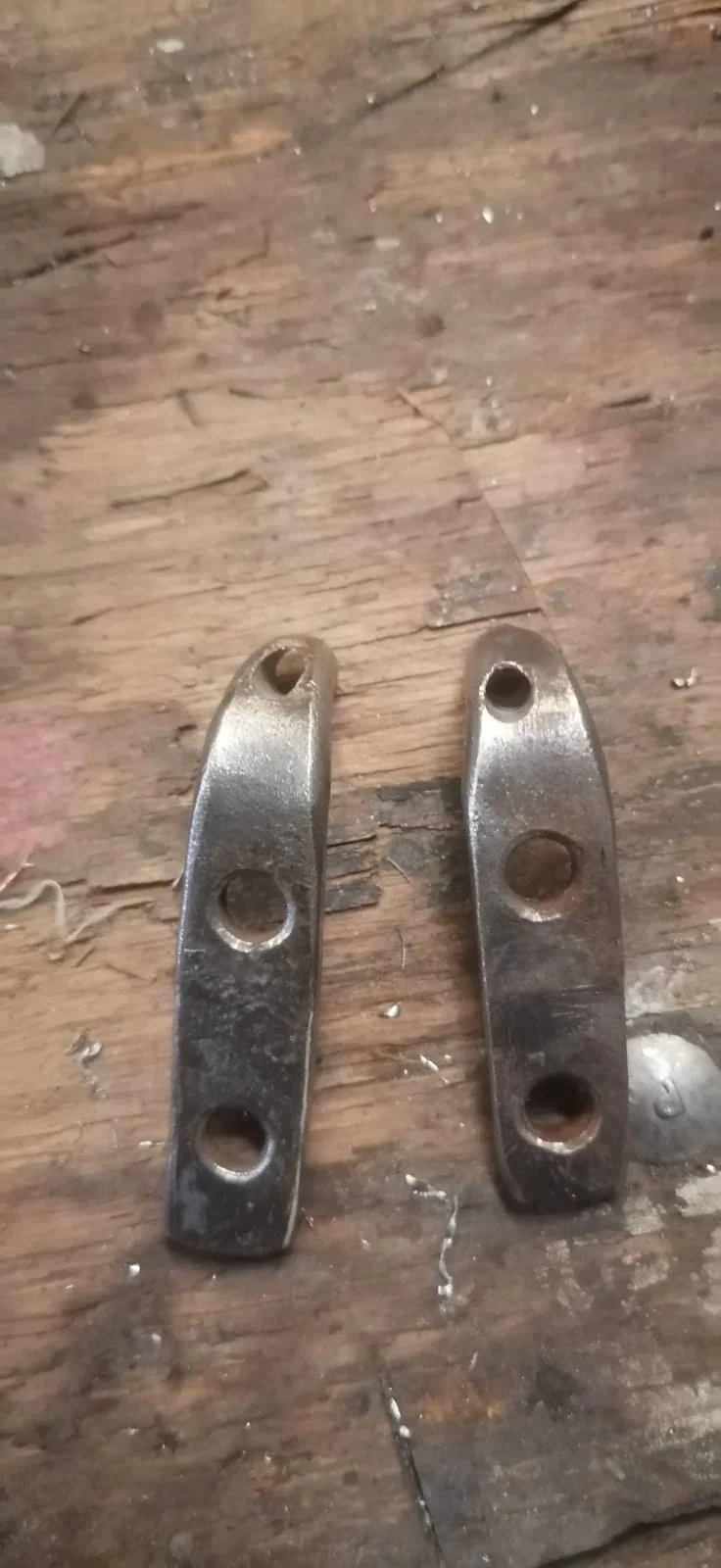

My BiFold Door rollers were rebuilt and the repair was just not good enough: they came off too easily.
I had a friend look at them and propose a repair and boy did he deliver on a solution.
This was the original solution which came off fairly easily.
The solution was to drill into the piece itself.
We inserted a steel rod into the new drilled hole.
We then welded the rod onto place, cut off the excess rod and will sand it too.
The roller is also properly welded to the rod.
Will update once they are sanded and installed!
Cheers friends.
