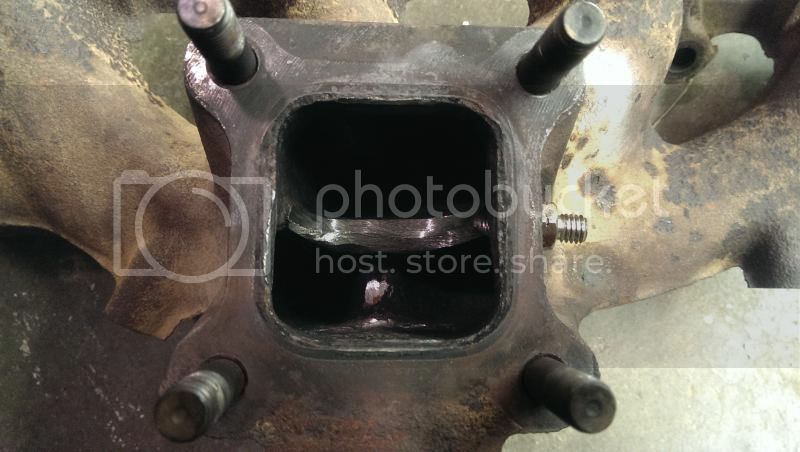

It all started out with marking the side of the manifold (pre turbo). I drilled slowly making sure to stop from time to time so I removed all the shaving. I planned to use grease on the drill bit for the final part of the hole. So... If I hadn't rushed into it and actually looked up what was in those manifolds I would have seen that there is a divider... That I had now drilled into the center of. Well off everything came, as it is now time to fix my screw up!

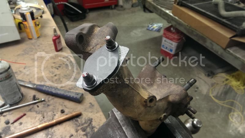

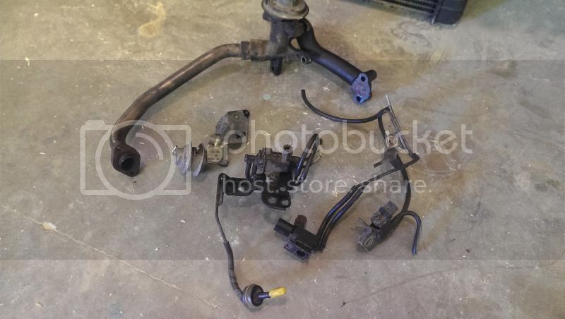

First being a proper EGR delete. I pulled the large pipe that wraps around the back of the block. Removed all vac lines and sensors that were related to the EGR and fabbed 2 block off plates (one on exhaust manifold and one on intake)

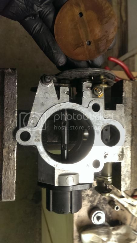

After that I pulled the 2 plates from the throttle body
Removal of these plates are suppose to make a huge improvement to the performance and economy of these engines. I look forward to this and will report back as soon as I have it running again.

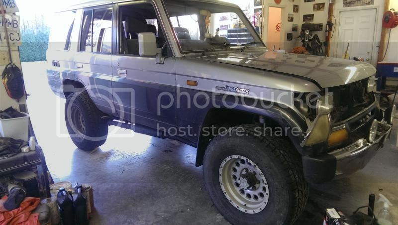

Lastly for tonight... one more visual thing. I have never liked the running boards that came on this truck. I do plan that one day I will build or buy some proper rock sliders. So I had some time and off they came!
After pulling the boards I realised that the exhaust needs some cleaning up... its pretty ugly but that's a project for another day.

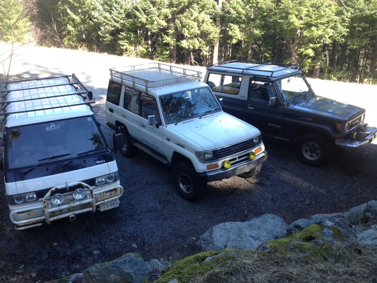

How about a shot of the fleet?

I cannot say that I have noticed a rough shut down (common characteristic if you remove the throttle plates) so I was happy with that.
After these few mods (complete EGR delete & throttle plate removal) the truck seems to be a lot happier. I also think that the throttle plate removal is easier on the turbo, reason for this is I have noticed that if I am at full boost and quickly let off the throttle I no longer get the shutter sound from the turbo (I did not have a BOV).

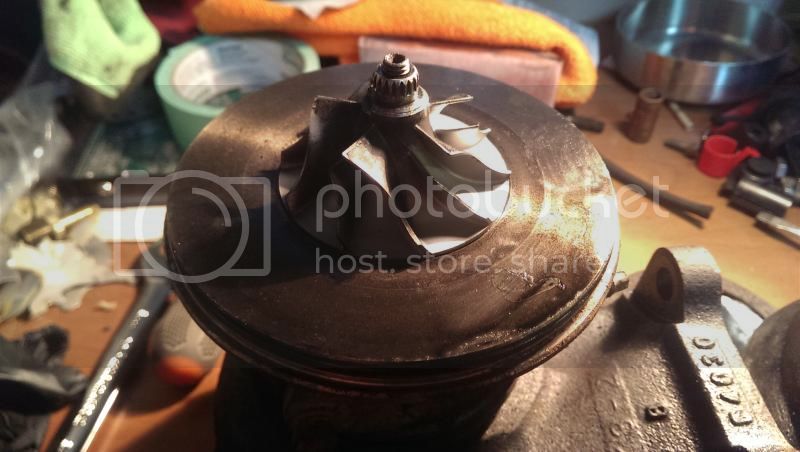

The CT20 all freshened up with Dynamic seal and new bushings
Exhaust EGR block off

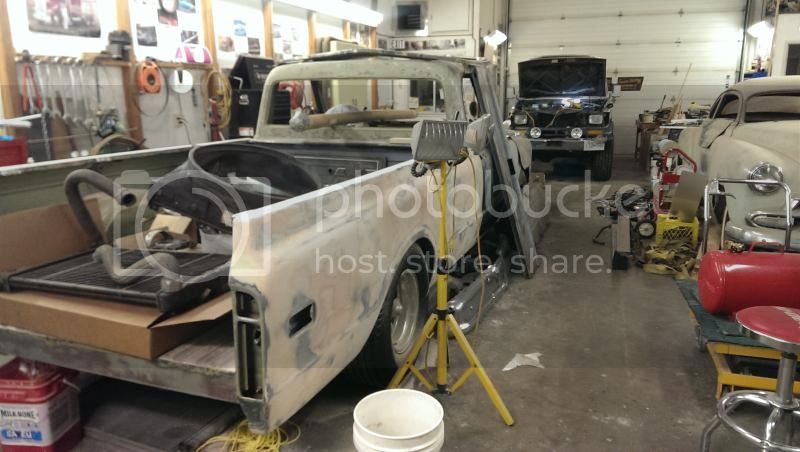

And a random shot from the shop... I will one day complete that 72... been working on it for 3 years but it has kind of been on the back burner
