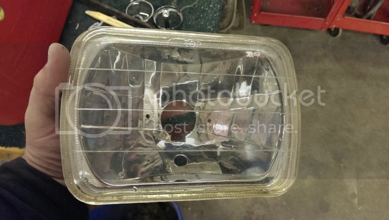

I picked up a pair of cheap used h4 conversion headlights

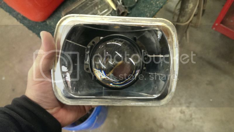

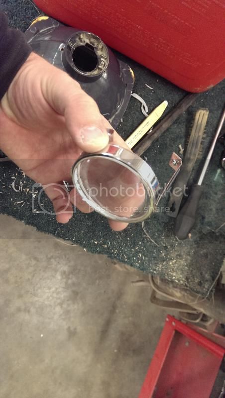

They had these crappy wannabe projectors. I split the housings to remove them

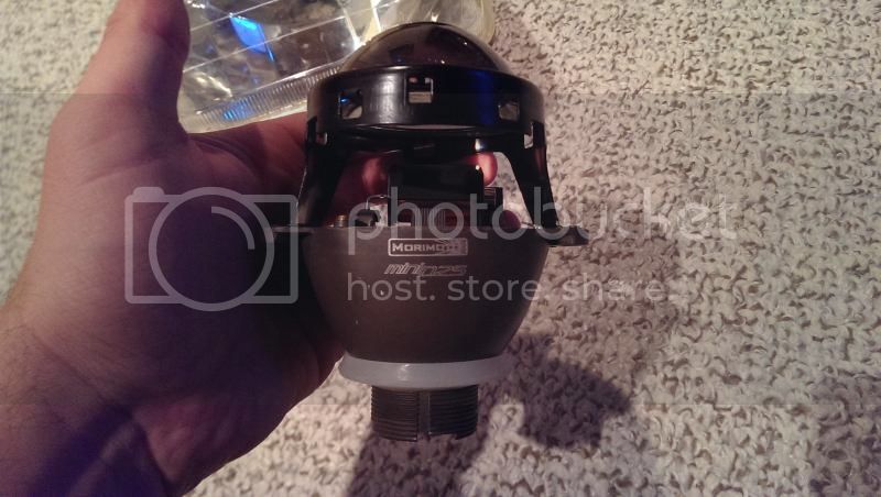

And replaced them with these
these take a d2s bulb (factory bmw, Lexus etc) and should help to brighten up the roads at night without blinding other drivers.
I need to gain about a 1 1/4" depth for these to work... I have a few ideas. Will update once I'm done.

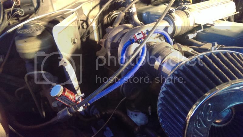

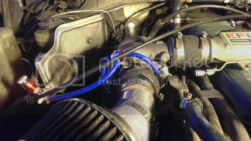

Added a cheap eBay boost controller over the weekend. There seems to be little to no information on how these are to be installed and they come with no instructions. Now to some it might be quite simple how they go on but to others not so here is a pic on how I plumbed mine! Works like a charm!
