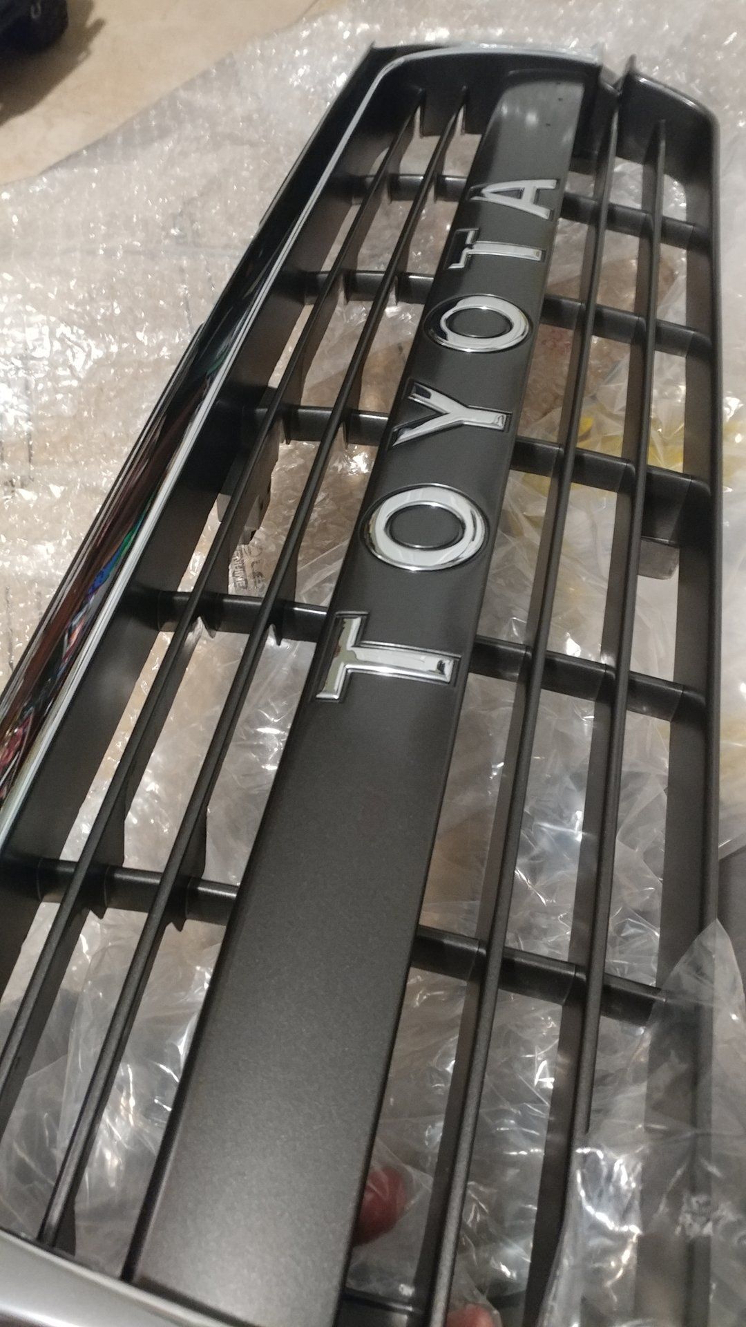

Installed new oem front grill and placed oem fan and transmission cooler. Waiting for front bar to get painted.

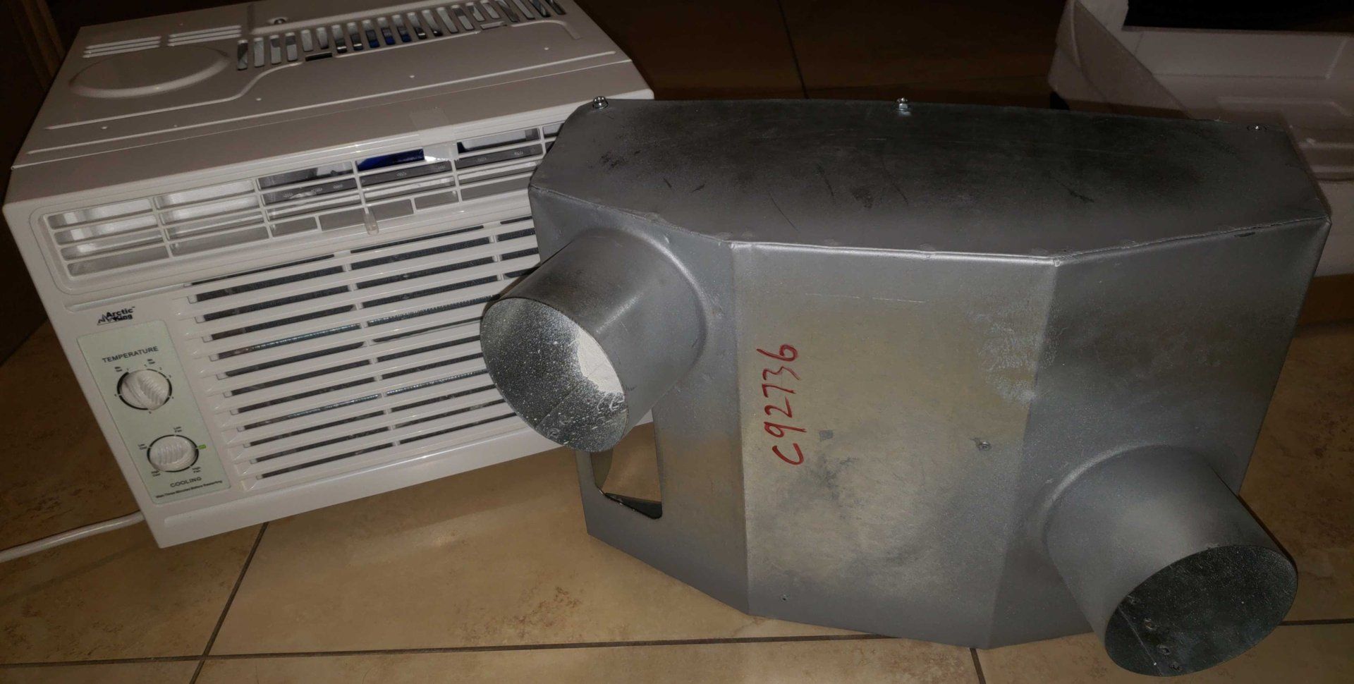

This weekend ended up working on the A/C. I installed a few months a new compressor and think it came defected had a little wobble to it. Ended up returning it and got a new one also installed a dryer and new condenser. Flushed and drained out oil and added new minerial oil from napa because i couldnt find nd6 oil. Vacuumed system and recharged it. Now its really throwing out ice! Turned on console refrigerator and but it on max and on idle for 15mins it went down 31. But usually stays on 38-40.

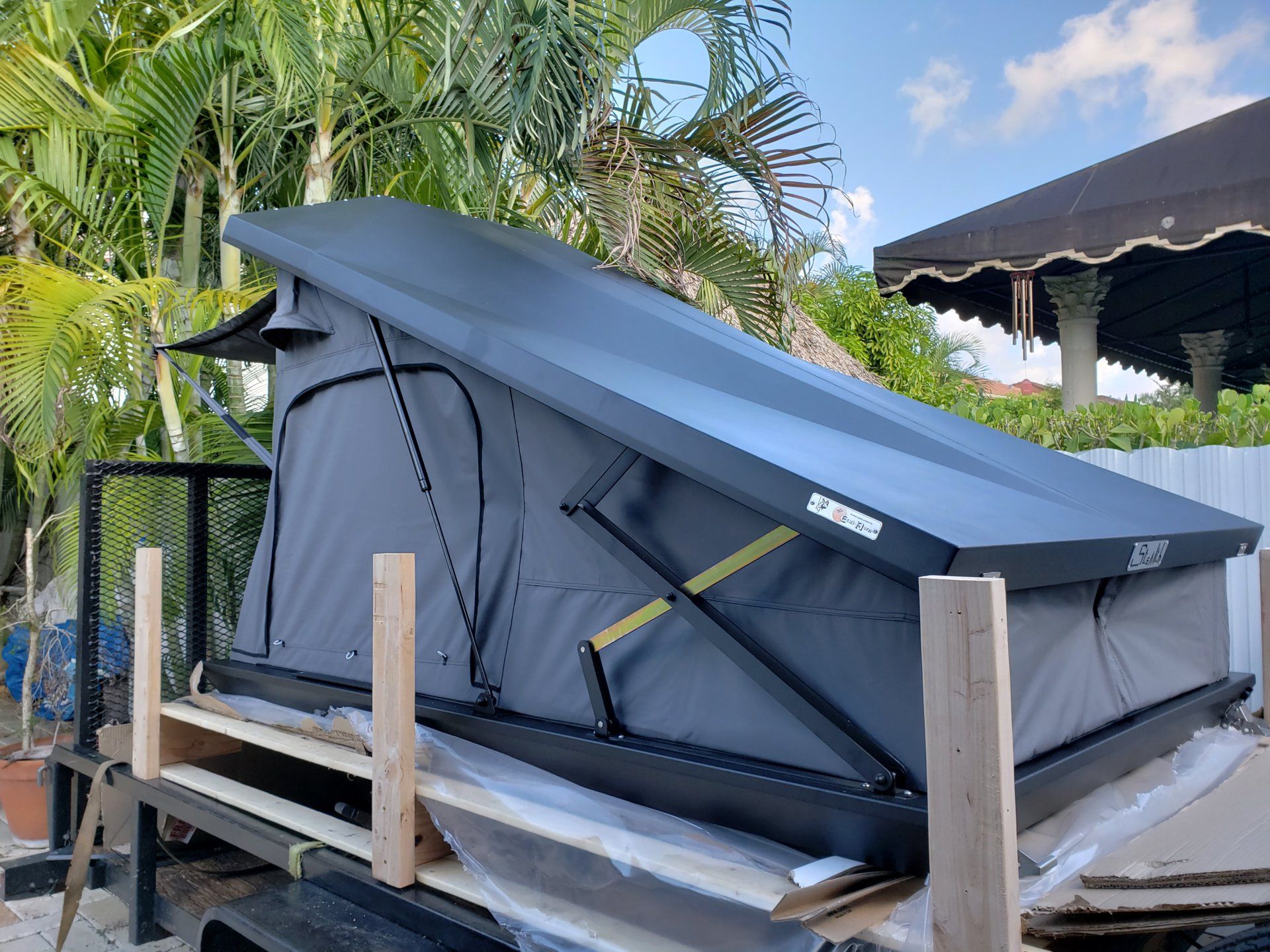

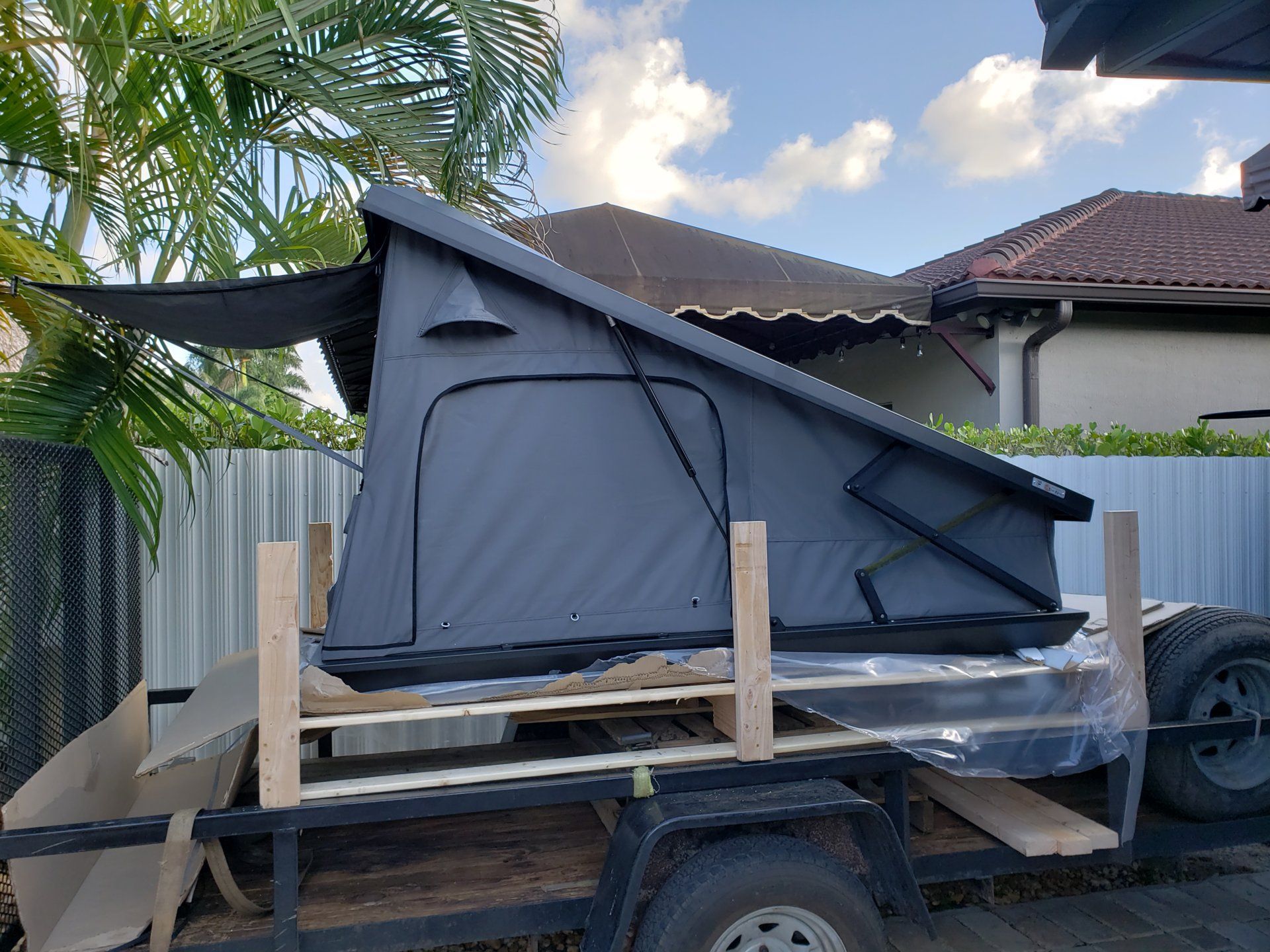

Got me some power!!! Plan to do alot of camping with my son soon. Cant wait! Little by little getting camping gear together.
