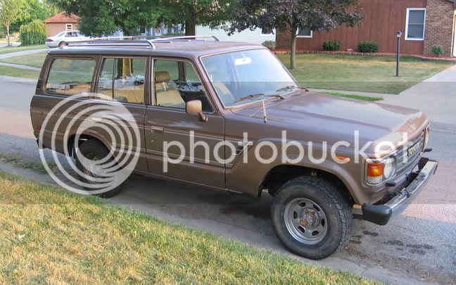

Hello all. Newbie here. I just purchased my first Land Cruiser, an 87 FJ60 from a friend of mine for 2K. It has 131,000 original miles and runs pretty good. It was de-smogged by my friend, but is all original besides that and the full stainless magnaflow exhaust. It has the Beige Metallic paint (code 4E8) but also has some gray graphics down the side that are supposedly factory. I have never seen one like this.
It has some rust here and there as it was a midwest truck. The frame has some scale and the body has some spots but the previous owner used POR 15 on most of them. The passenger rear tire is a spare, and I have the original chrome wheel, I just need to get a good tire for it. The interior is in excellent conditon and overall the truck is in good shape. I have an original chrome rear bumper coming from forum member freds40, as it has a bent up, painted black bumper on it currently.

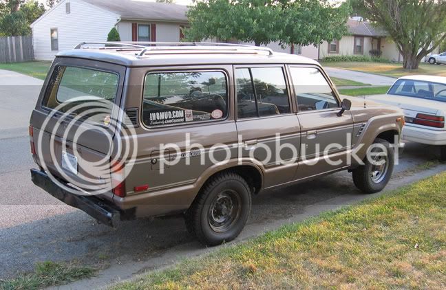

Here are some pics of the truck. The oil spots on the ground are from a neighbors car. Since it has been de-smogged, it currently runs best when the choke is pulled out two clicks, and you have to drive it like that. Any input or advice? I can take pics of the motor if need be. Thanks for lookin!
nice LC looks clean

Yeah, not sure about the mirrors. I have seen pics of both types, but the larger ones might have been an option?
Yeah, you don't want those big bulky ones...too much air drag, kills your mileage. Will trade you for a pair of the little ones. Send me a PM
:D You beat me to it..... ;)
Two-tone? Wicked.

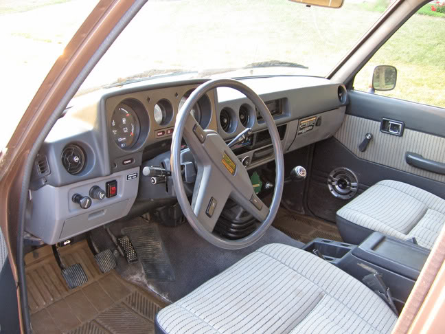

Do later model 60's have different center consoles? My 83 does not look like that one.
Two-tone? Wicked.
His center console looks like my 88 FJ62 one. Not sure of the differences b/w your 60.
Nice truck. I dig the stripes and the factory roof rack. Post up as you begin to go through it.

looks like my 87
