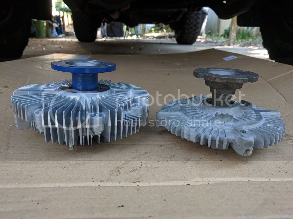

After getting her home, I went to flushing the coolant system. Found no thermostat in the housing and the PO's mechanic used a silicone sealant which made a mess inside of the system. I pressure flushed about 10 gallons through her and then another 4 gallons of distilled water and all kinds of junk came out. Popped a new OEM t-stat in her (after testing it) and filled her up with toyota red mix. She was still slightly overheating while driving around where I live - max speed limit is 35 mph on the island - so I bought an Aisin Blue Hub and did the mod on it. The old one in it was a terrible excuse for a replacement and I'll probably replace the water pump soon too just for comfort.
But here's the old one compared to the new one.

Is the front half missing off of the old fan clutch ? ! ?

Thanks! Yeah it was dinky. No markings on it except made in the USA. Needless to say it was not adequate for her cooling system
