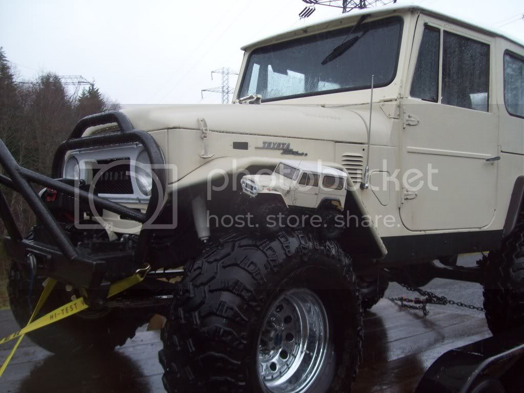

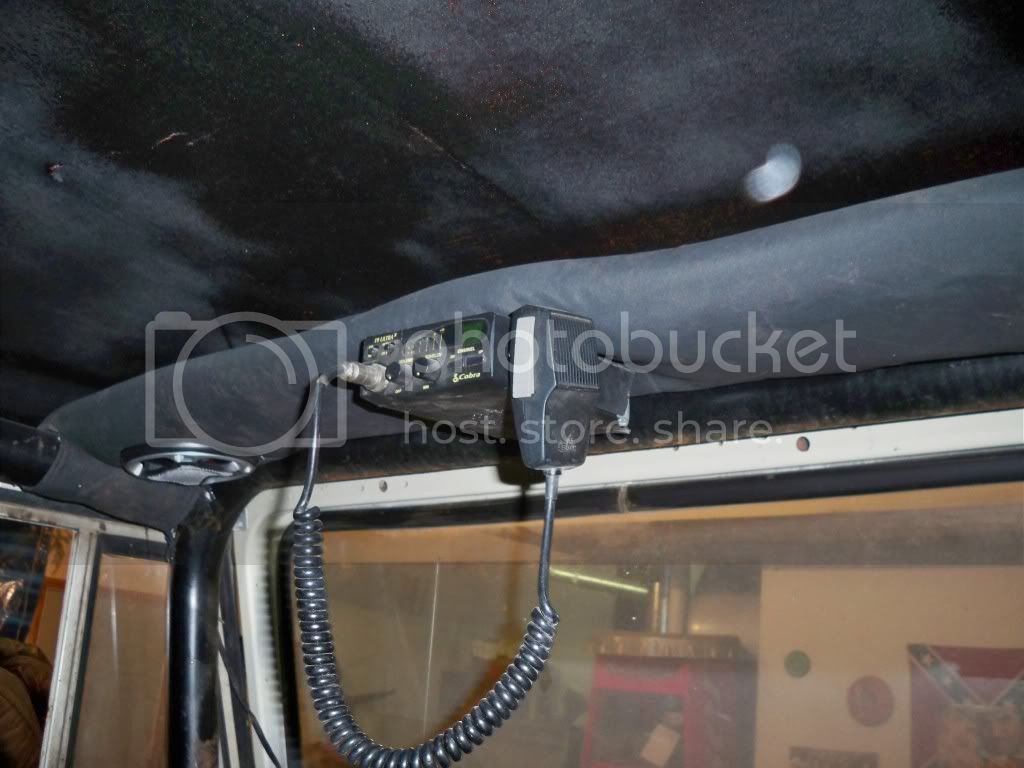

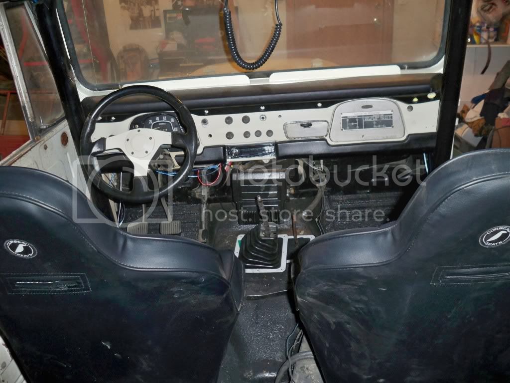

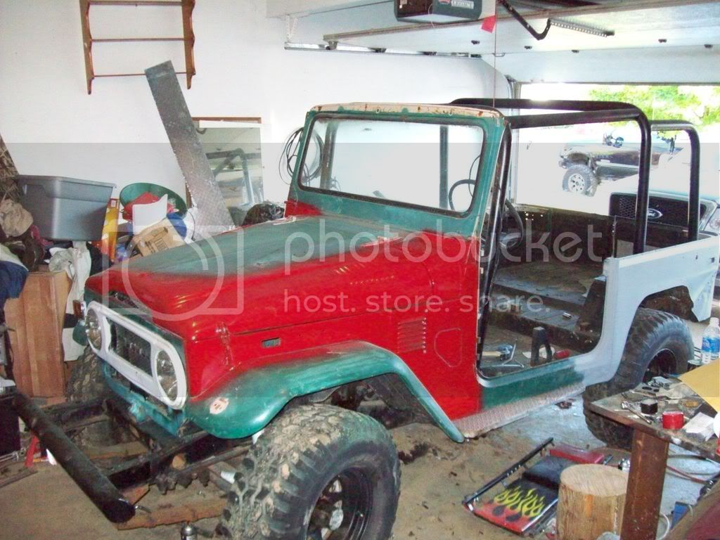

I have been building this for the last 6 months or so I got it in pretty sad shape and have gone through most everything on it. Its a 73 with a mid 80s 2f , 3 speed, Drivlinetech.com 1/4" wall long slip drivlines, locked front and rear, stock cruiser rear axle with 2" wheel spacers and a 1980 mini truck front axle with trusses diff. guards and the Longfield 30 spline super set :D,The front leaf pack is a toyota IFS rear leaf / jeep wrangler hybrid pack. U bolt flip, pro comp shocks , Custom made rear leaf perches for the spring over / flip in the rear. The wheel base is almost exactly 100". The interior is herculined , Corbeau baja ss seats with a cj7 rear seat. RCI 5 point harnesses, CB , PA, CD player, found a cool sound bar out of a yj i think to hold my cb and speakers, I made my own tube fenders , Saginaw power steering , Cross over high steer , disk brake front blah blah blah ... I still have a ways to go until its done but its getting close !

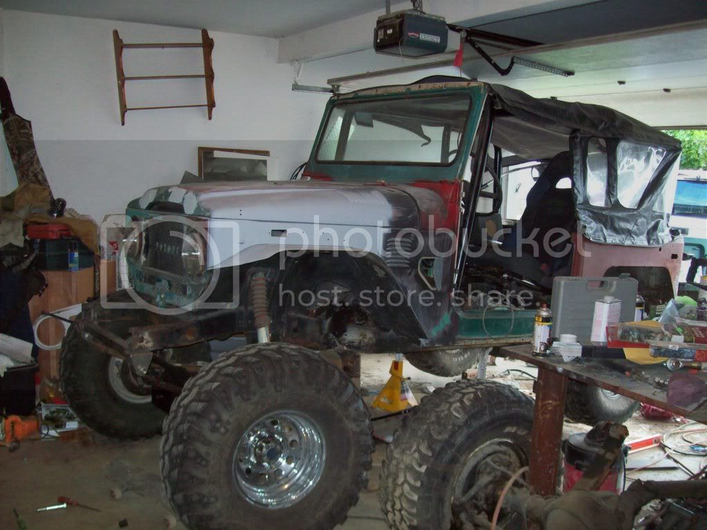

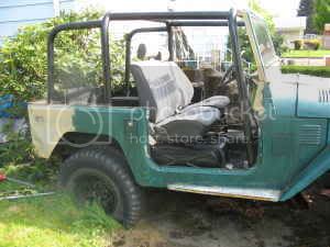

here it is when I first got it

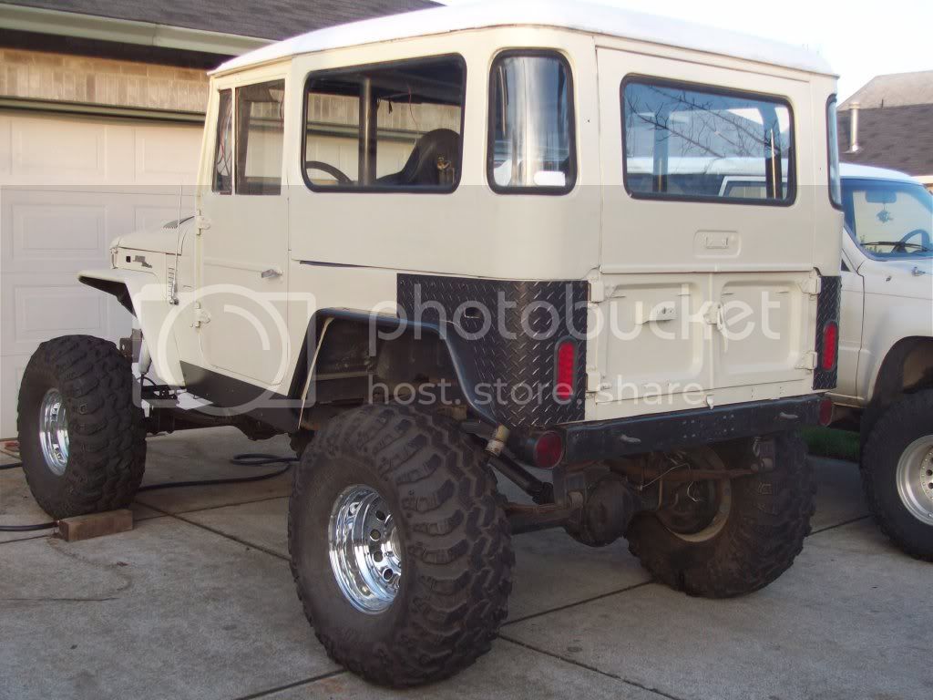

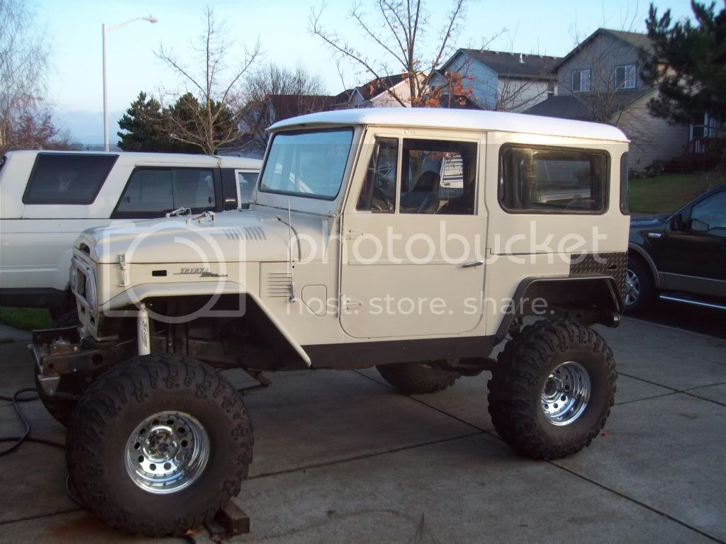

Here it is right now

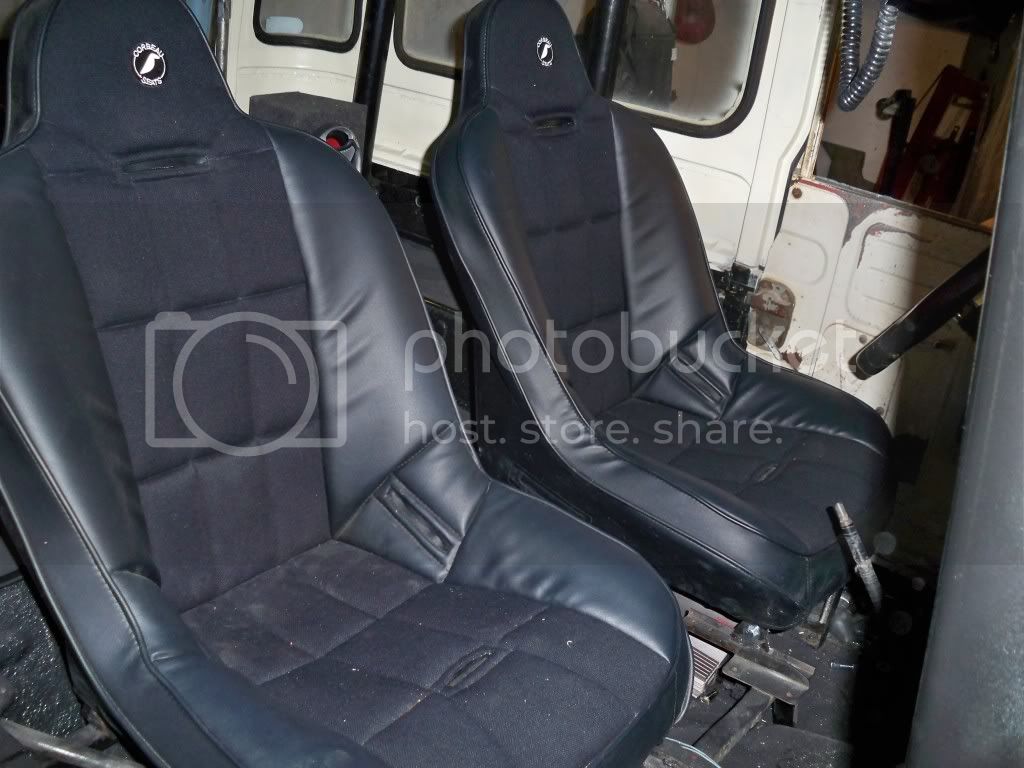

Thats a pretty clean rig, props. How do you like those seats? jw:hhmm:
The paint is out of a can :hillbilly: I built this to be a wheeler and here in the Pacific Northwest we have lots of trees to run your paint down. So I figured i would put my $ where i needed to and have a paint job I could re do on the trail :D The seats are nice but im about 200 lbs and if you are any larger than that I would most defiantly get the wider ones !

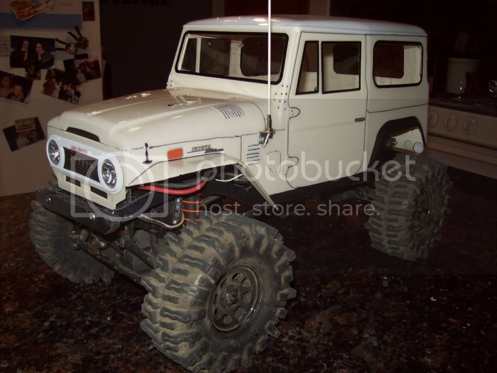

Looks like all your effort has payed off good looking rig. I also like the ease of touch up with quailty rattle can. That rc is sweet how big is it, it looks large in the picture

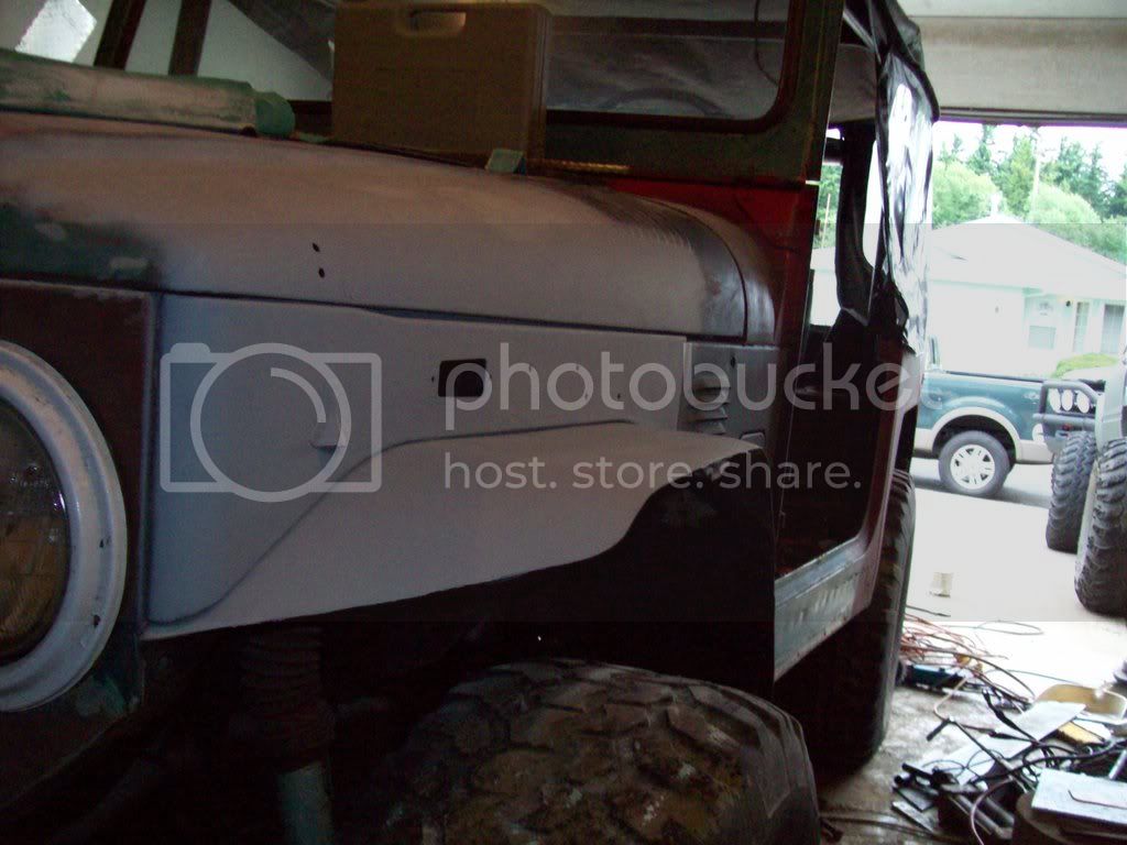

Nice job on the rig, Winkle! I especially like how you did the front fenders - did you bend-over the edges, or did you tube 'em?

This picture gives perspective to the r/c
