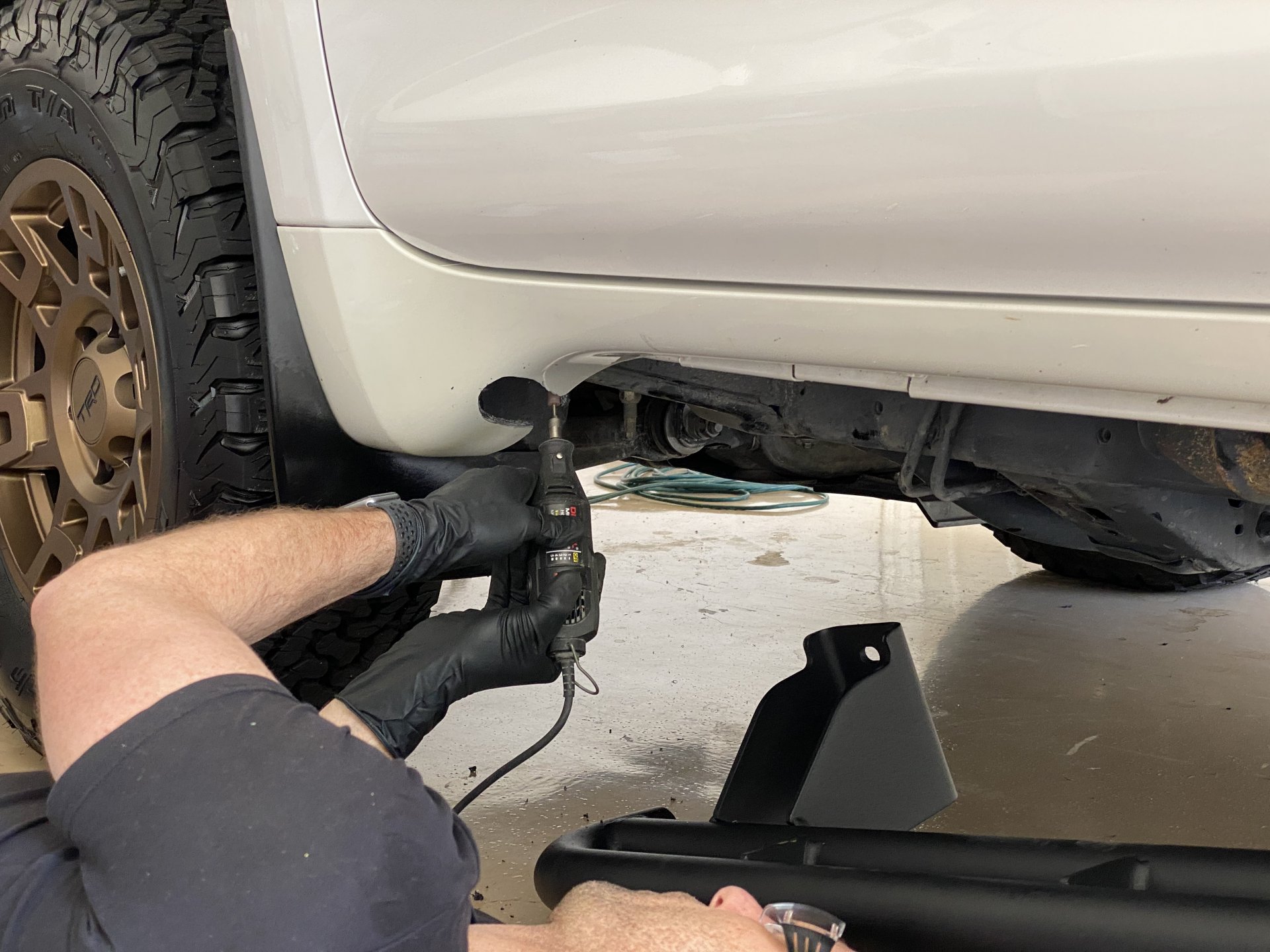

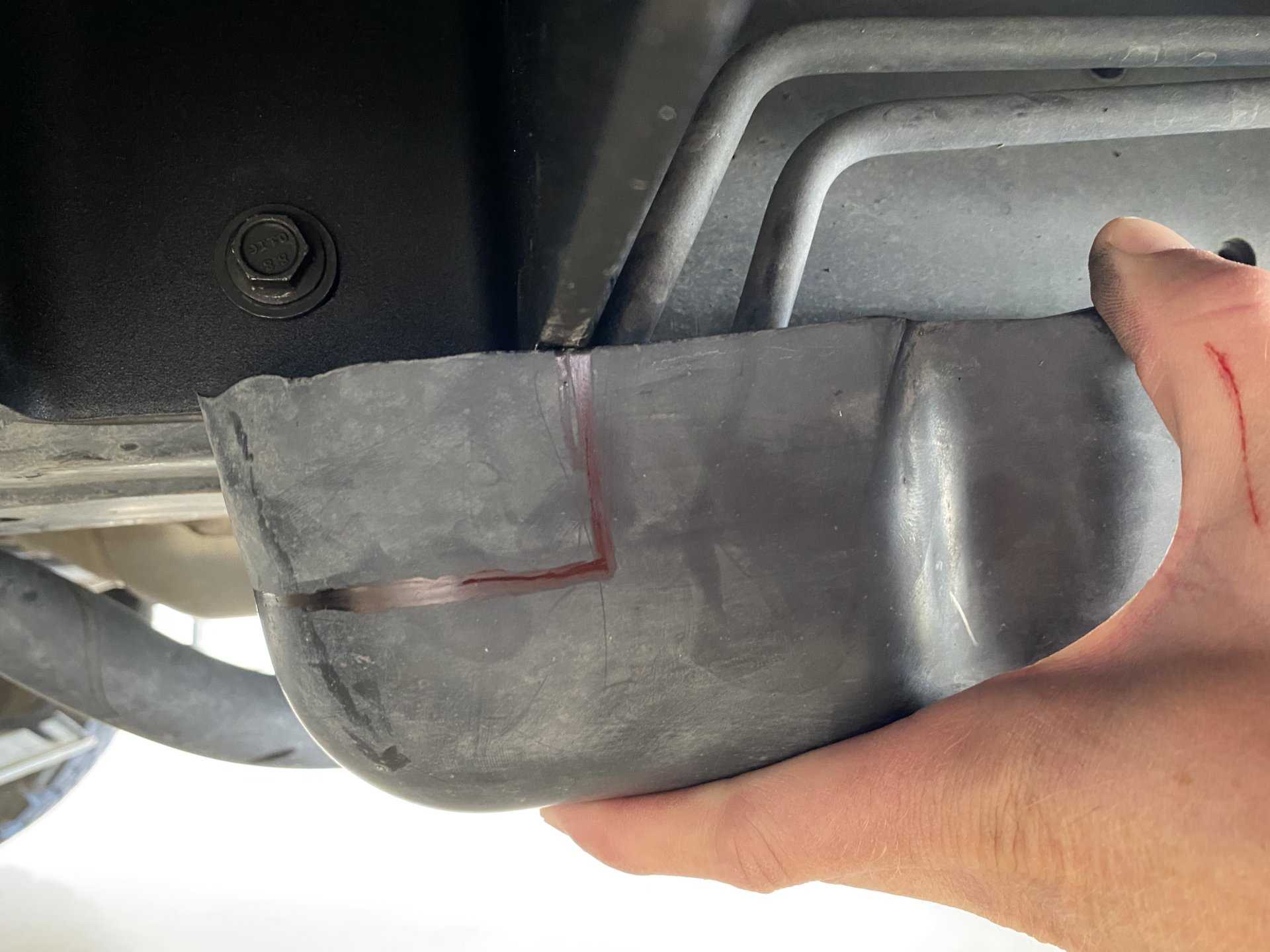

How did you modify the Prado rocker panels to work with the 4runner rock rails? I have Prado rocker panels on their way from Japan and am considering this combination as well.
I used a dremel tool.
Also had to cut a corner off of the KDSS skid plate. See that square
