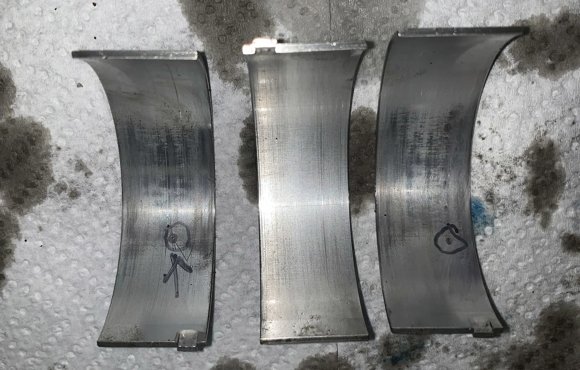

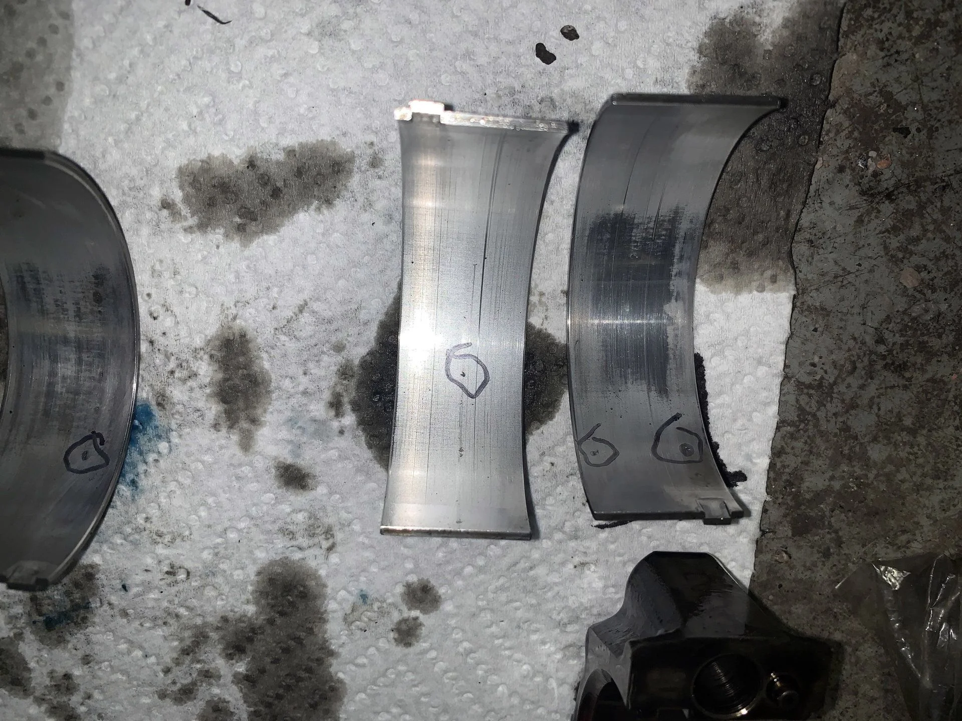

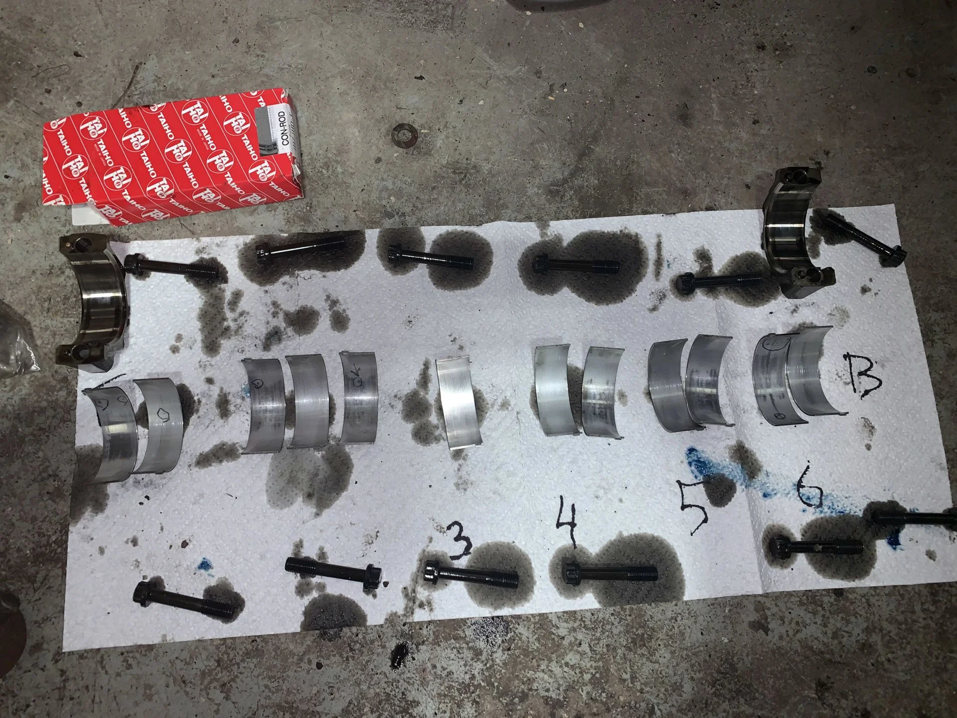

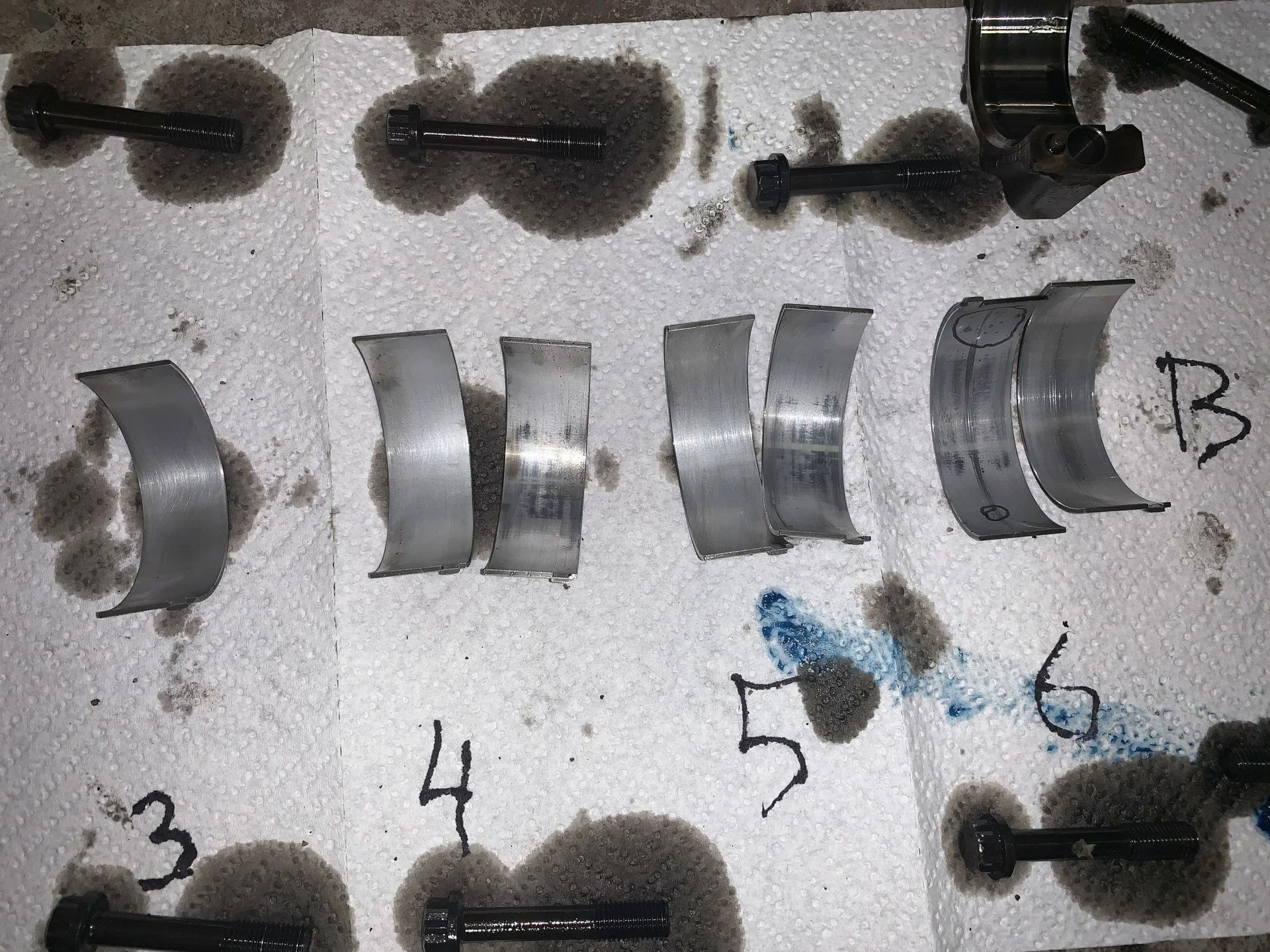

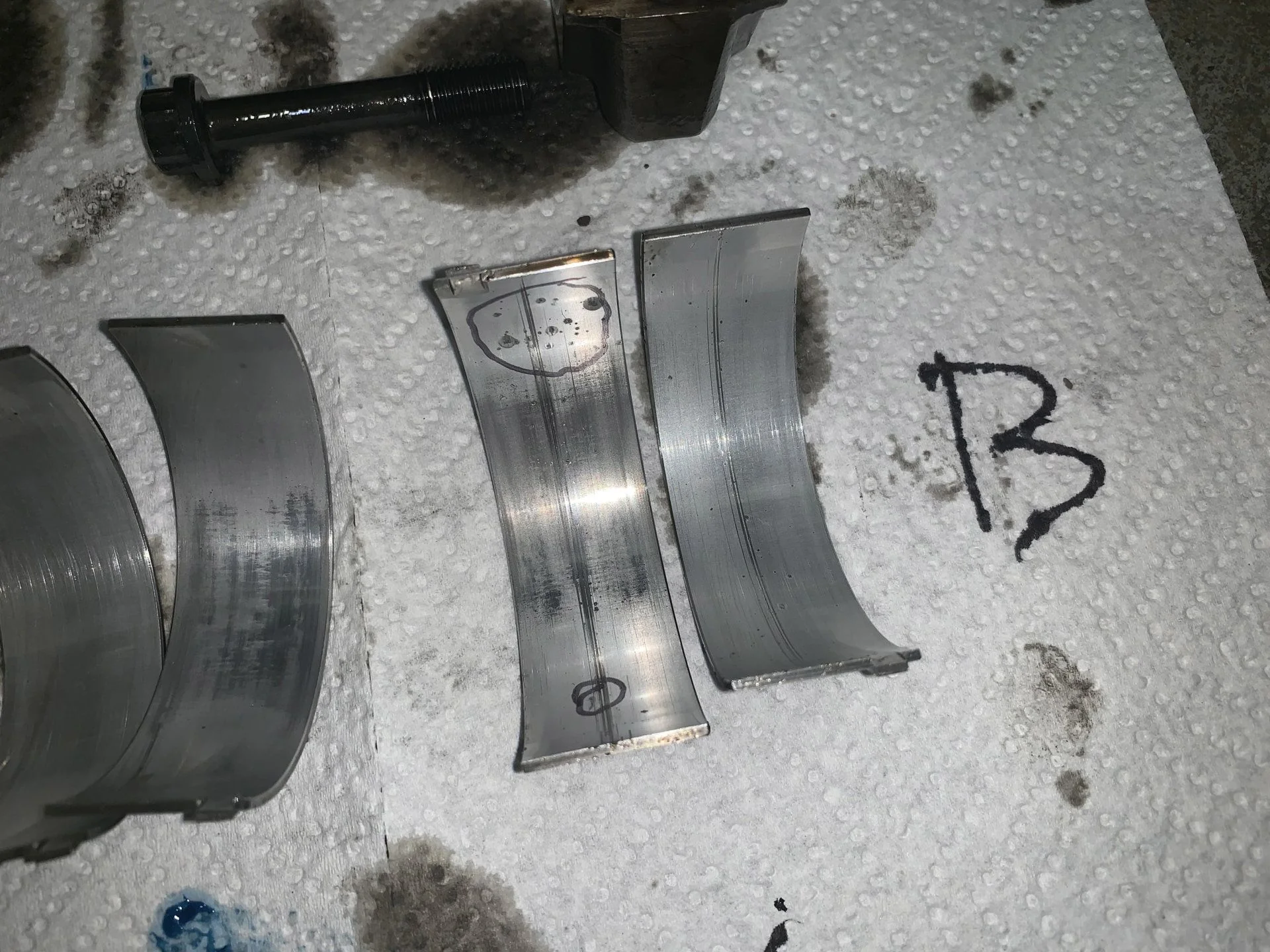

I finally got to preemptive rod bearing replacement on my '91 HDJ81 / 132K.KM
It seems that I caught them in time, some pinhole sized erosions (circled with sharpie) can be see on the few upper bearings. That vertical scratch was also a concern but I found nothing on the corresponding crank surface.
Please see the images below and let me know your thoughts.
You did it right .. yours are very good shape tho .. I've seen much worse on a perfect healthy engine.
Agreed with Tapage, seen worse on running engines and now you know what you have.
