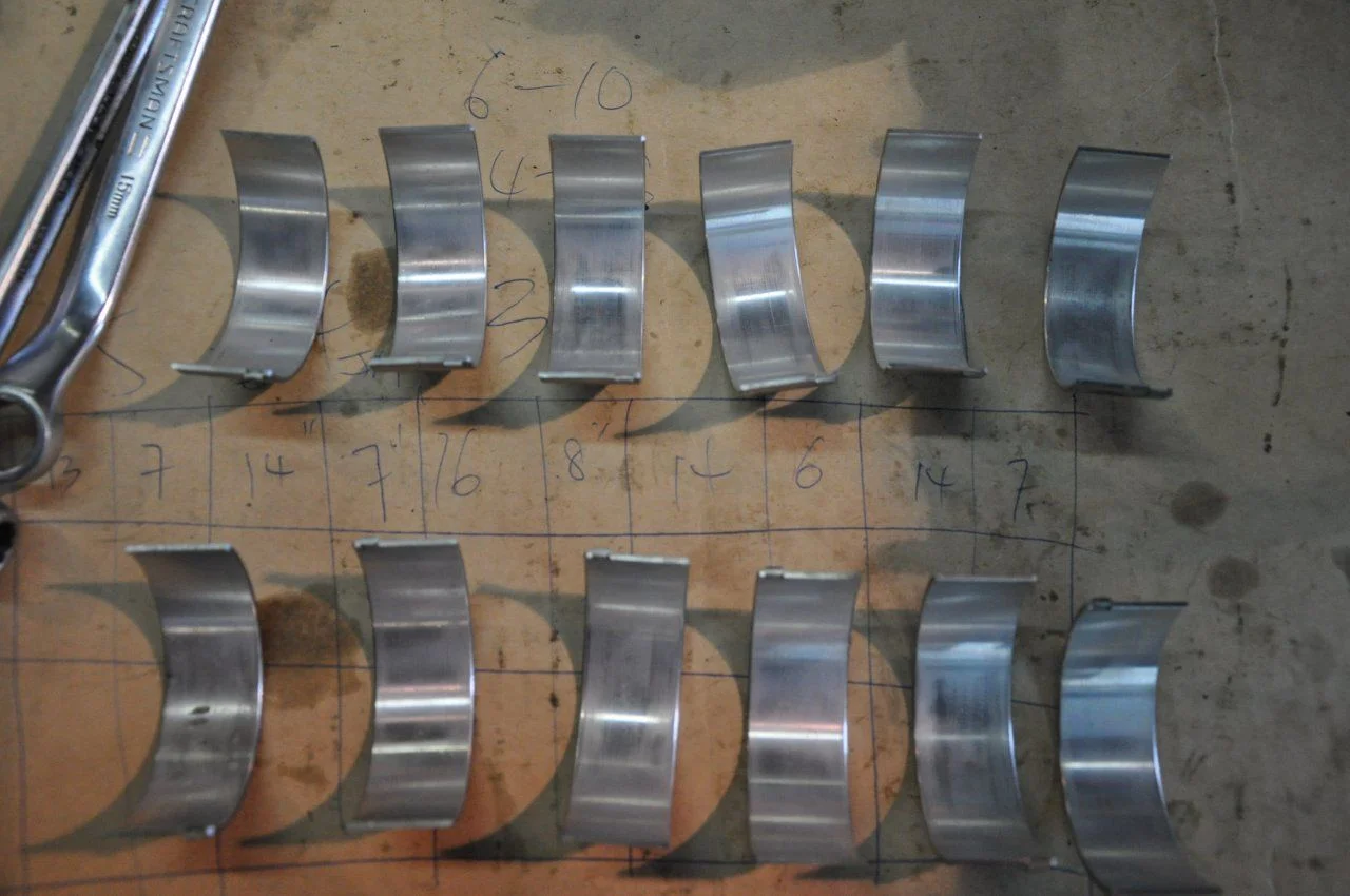

i have a 1991 1HDT that has roughly 500 000km on it. it was swapped into my truck (1989 fj62) for me almost three years ago so i only know if it’s history these three years. as far as i now the oil pan hadn’t been off. i figured as preventative maintenance i should change them. the job is quite easy actually. i drained my oil three days before pulling the pan. it’s still a messy job but i just had cardboard down on the floor and the truck up on axle stands

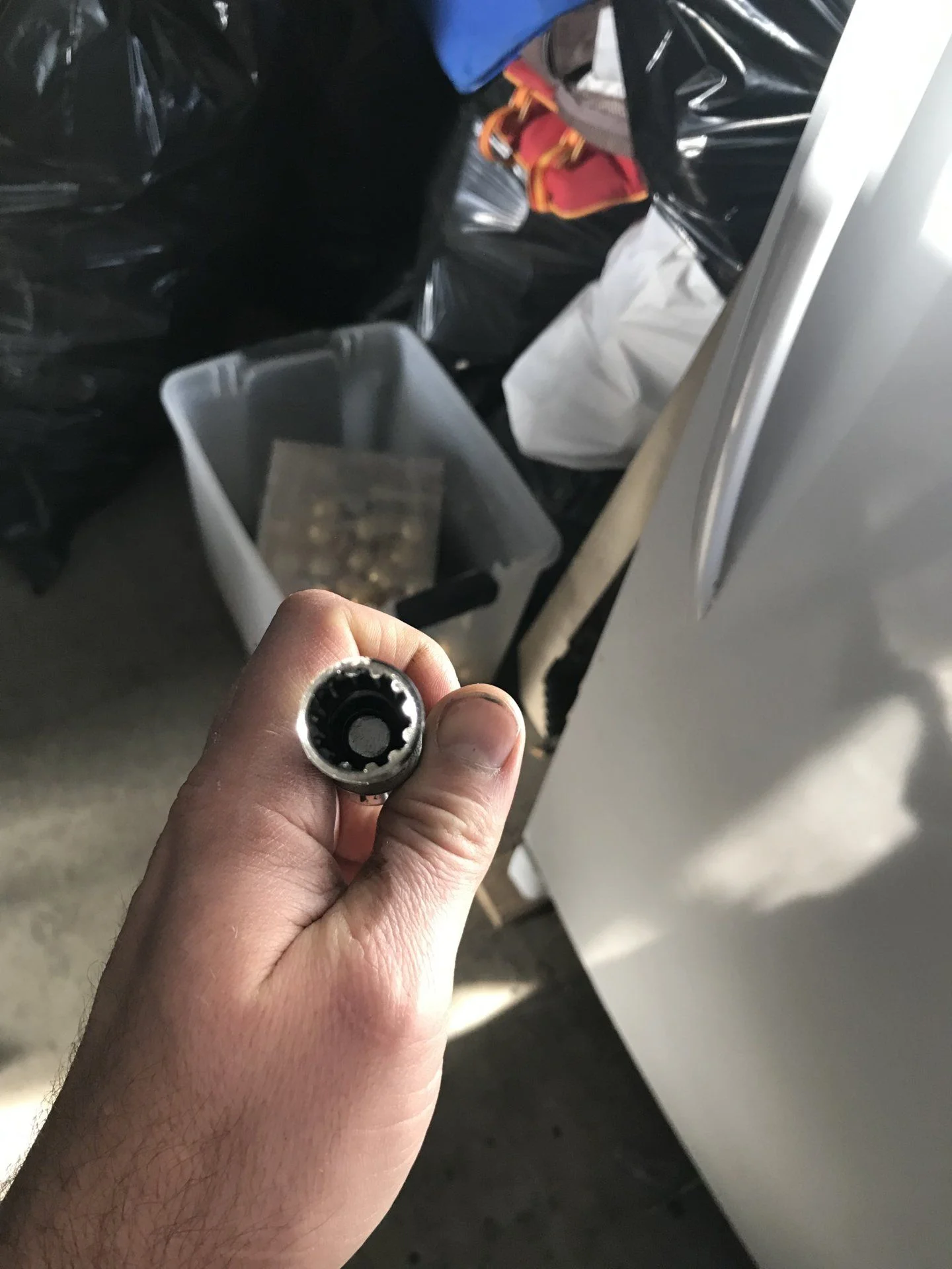

the connecting rods are right there. i used a breaker bar because they are tight!! this it the kind of bolt you will encounter so have the right socket. i started with the rods that were bottom dead center.
i used this socket. it’s a 12mm socket with a star type pattern. not torx but not a normal hex either. i think it’s called a spine type socket.

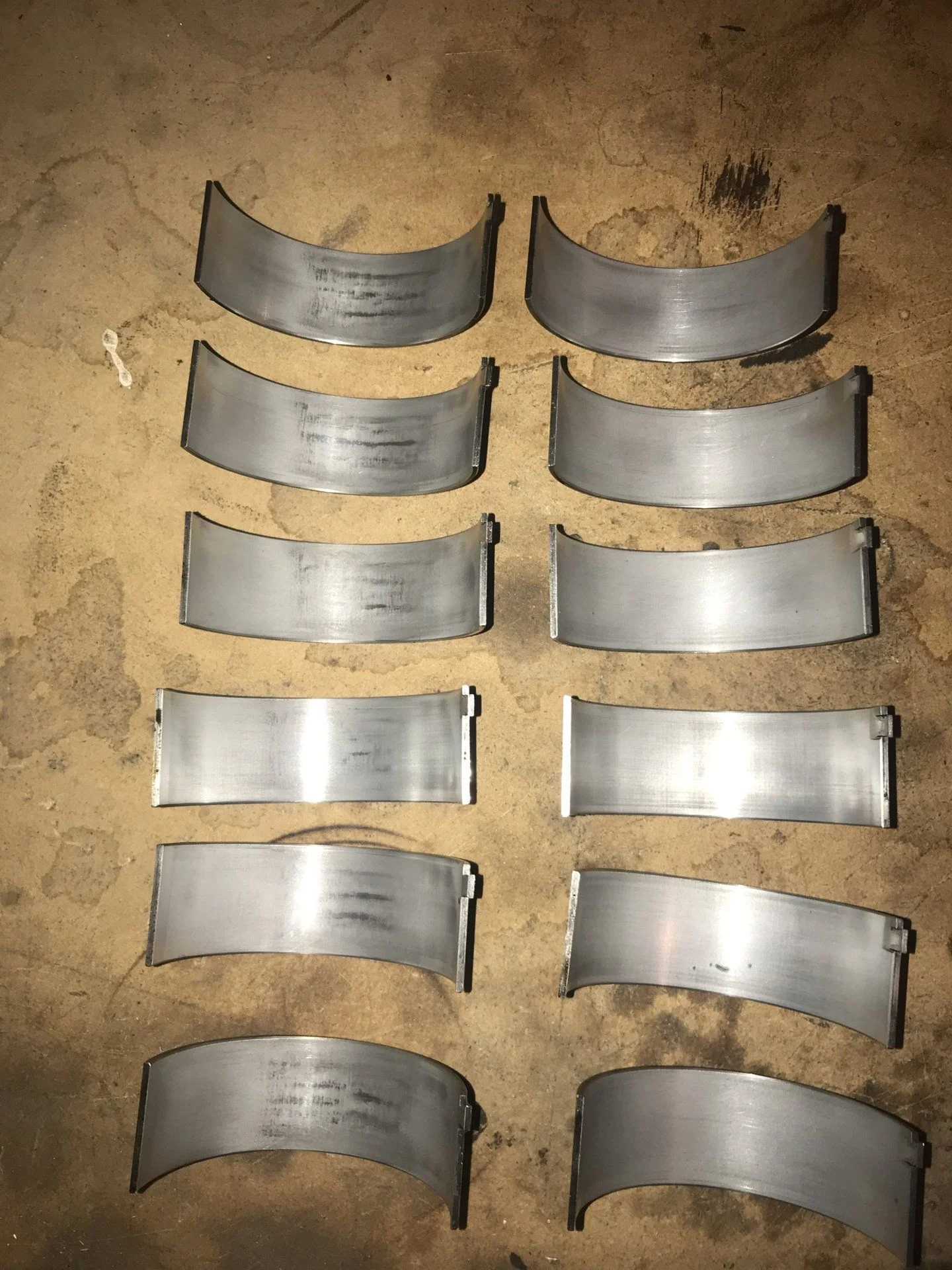

with the connecting rod cap off and the crank at the bottom of the stroke the valves should be open so it’s actually quite easy to just push the piston up in the cylinder and slide the bearing out. replace the on in the cap too and pull the piston back down. you don’t need to turn the crank at all while the rod is disconnected so no fear of damaging the crank journal. just be careful pulling the piston back down. install new bolts with a little oil under the flange and as per FSM torque each to 27ft/lbs. mark the bolt head to the front of the engine with a paint pen and turn 90 degrees more. i used the breaker bar again. it does feel like you’re going to break something but trust it. it won’t break.

refill with oil and you’re done. i’m not planning on changing them ever 100 000km like some people say. ill do an oil analysis from now as suggested by some people here on mud.
my bearings looked like this. no.6 is top. no.1 is bottom of the photo
only a little pitting on the bottom of number two
@franklin40 thanks for posting up the detail and information. Wish I could find the photos on mine when I did them. Mine is a 2nd gen 1HD-T from the block and injection pump numbers and I don't recall any standout pitting either.
Those bearings look a lot better then a number I have seen in person (or as referenced in the link above) so that is great! What brand name bearings did you use?

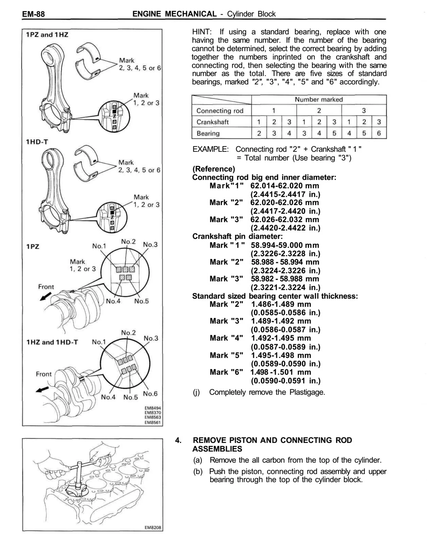

Do you have the FSM?
What numbers are punched on the crank, and conrods?
The OEM factory machining tolerance from #1, #2, #3 crank journal is quite small. From 1-3 is 0.012mm difference in crank journal diameter.
Conrod tolerance is similar, with 0.048mm from loosest to tightest
If you took the loosest conrod, put it with the smallest crank journal, a #3 bearing is most likely going to fall within the Goldilocks range.
Toyota's range of bearing sizes lets them assemble engines to very close tolerances. They do the same with the 1HD-T head gaskets. In the factory, they use a range of 5 different hea gasket thicknesses, but only make three sizes available as replacement parts. Aftermarket only produces three thickness too.
yeah i have a fsm. #1 crank and #2 on the conrod. bearing was a #3 bearing which matches how the fsm says to size it if you can’t see the number on the bearing. i just have a hard time seeing how the acl bearings (or the tiaho bearings fornthst matter) that are one std size would be an upgrade from the perfectly sized toyota bearing unless it’s based purely on better metals used in the bearing
It comes down to acceptable tolerances.
Looking at the FSM, and your crank and conrod sizes, you're right in the middle of the OEM assembly tolerances.
STD aftermarket bearings, are going to be sized for a goldilocks fit.

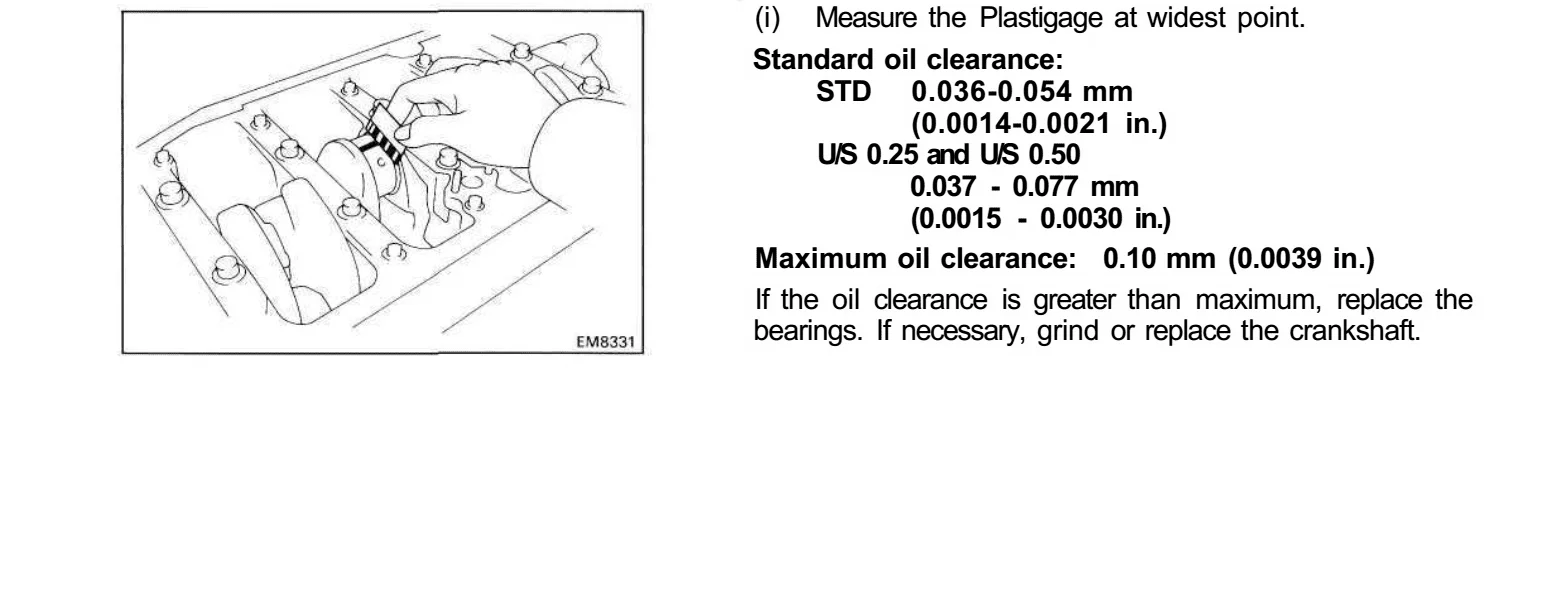

Looking at the first snapshot from the FSM, they show a maximum oil clearance of 0.10mm, which is way above what the FSM says to shoot for with the plastigauge.
Given the size of your crank and conrod journals, and the condition of the bearings you removed, I'd throw the STD Tiaho in and forget them.
