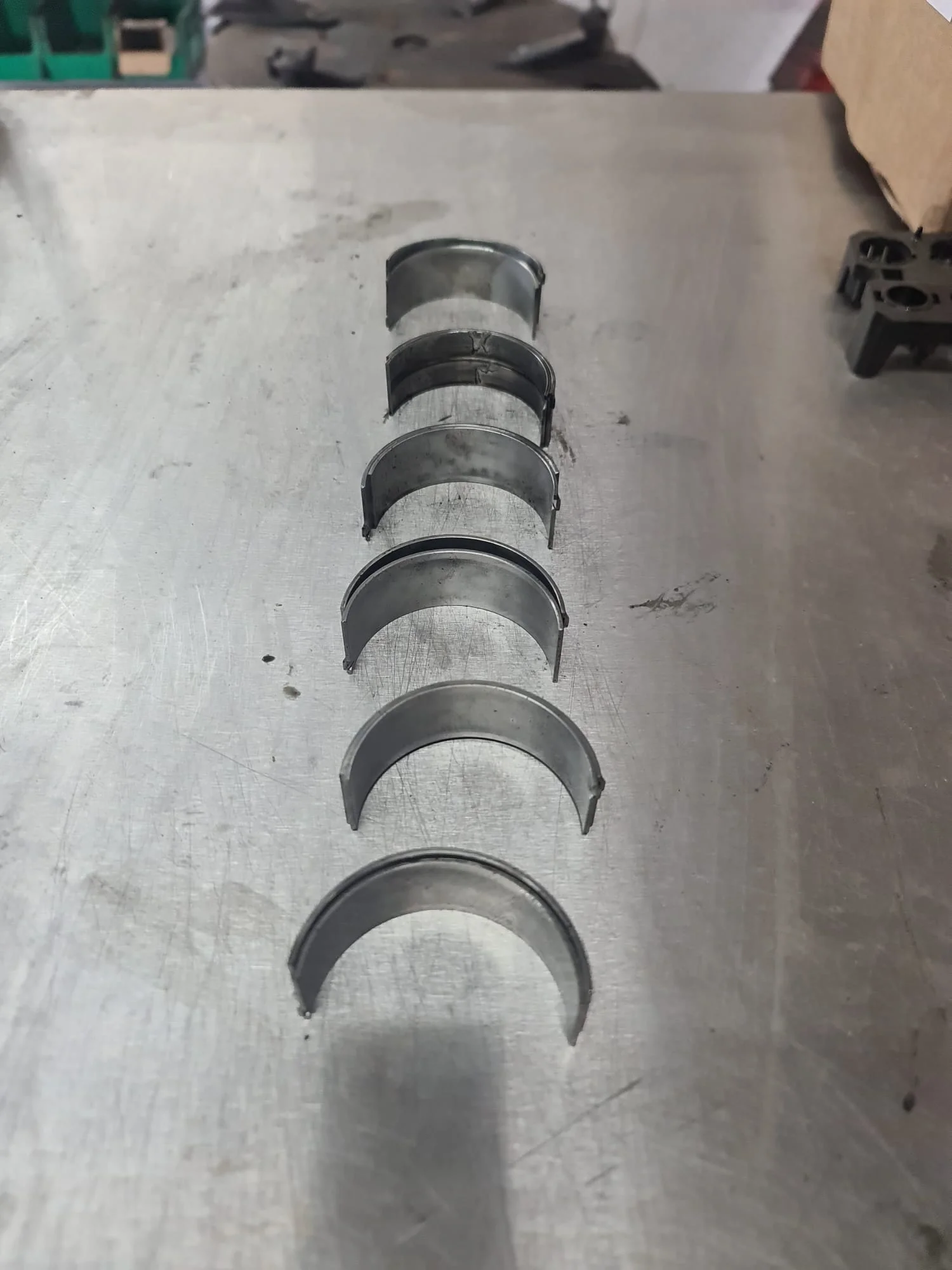

I've spent the last year getting the cruiser up to date with maintenance including the Big End Bearings...
Well boys just have a look at the state of those, I don't think they had ever been done and we were very near to absolute disaster. Caught em just in time.
No performance mods on the engine, and no indication there was anything wrong, and noticed no difference in the engine after we got new BEB's in.
But I do now have peace of mind that were not going to send those rods to god.

Interesting failure pattern on those bearing shells. Something unusual going on there!
I would suggest look at having used engine oil analysis done in the future, as you approach 100k km on the new bearings.
Its cheap if you do it say at 80k km, 100k km, 110k km 120k etc etc, and gives some confidence in your engine.
Yeah, I look forward to hearing what the theories are on that bearing.
In spite of my ignorance I'm going to guess that those bearings were cast and that the voids were in those bearings from production. Perhaps those voids were originally filled with another material that either dissolved or got flushed out over time or they were simply empty voids from day 1...
Now, the more experienced and knowledgeable can set me straight :)

There's a theory that the early 1hd-t suffered from harmonic vibrations in the crank that causes cavitation in the oil film.
There was various design changes to the 1hd-t to eliminate this
Ha, yeah really was a double escape, yeah i'd be interested to, I was hoping the BEB's might be a one and done, but that failure was too tight-aresehole to ignore for the future, maybe ill run a 100k km oil check and see what deposits we have to make the call
Thats interesting, given this is an eariler pre-improvement engine ill have to keen an eye on this in 100k km.
