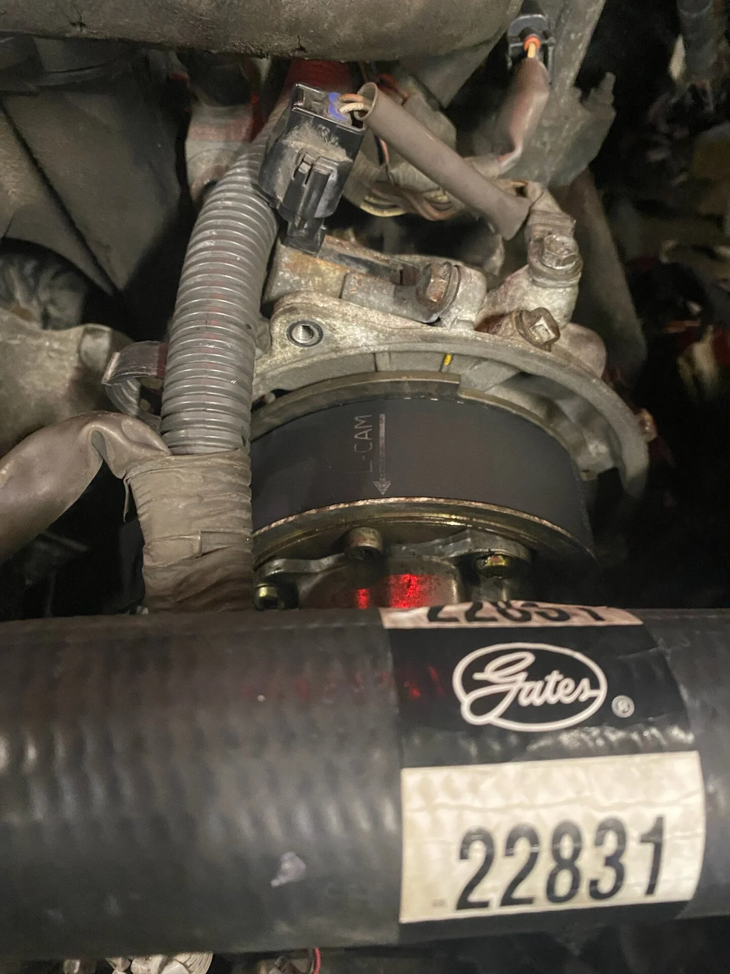

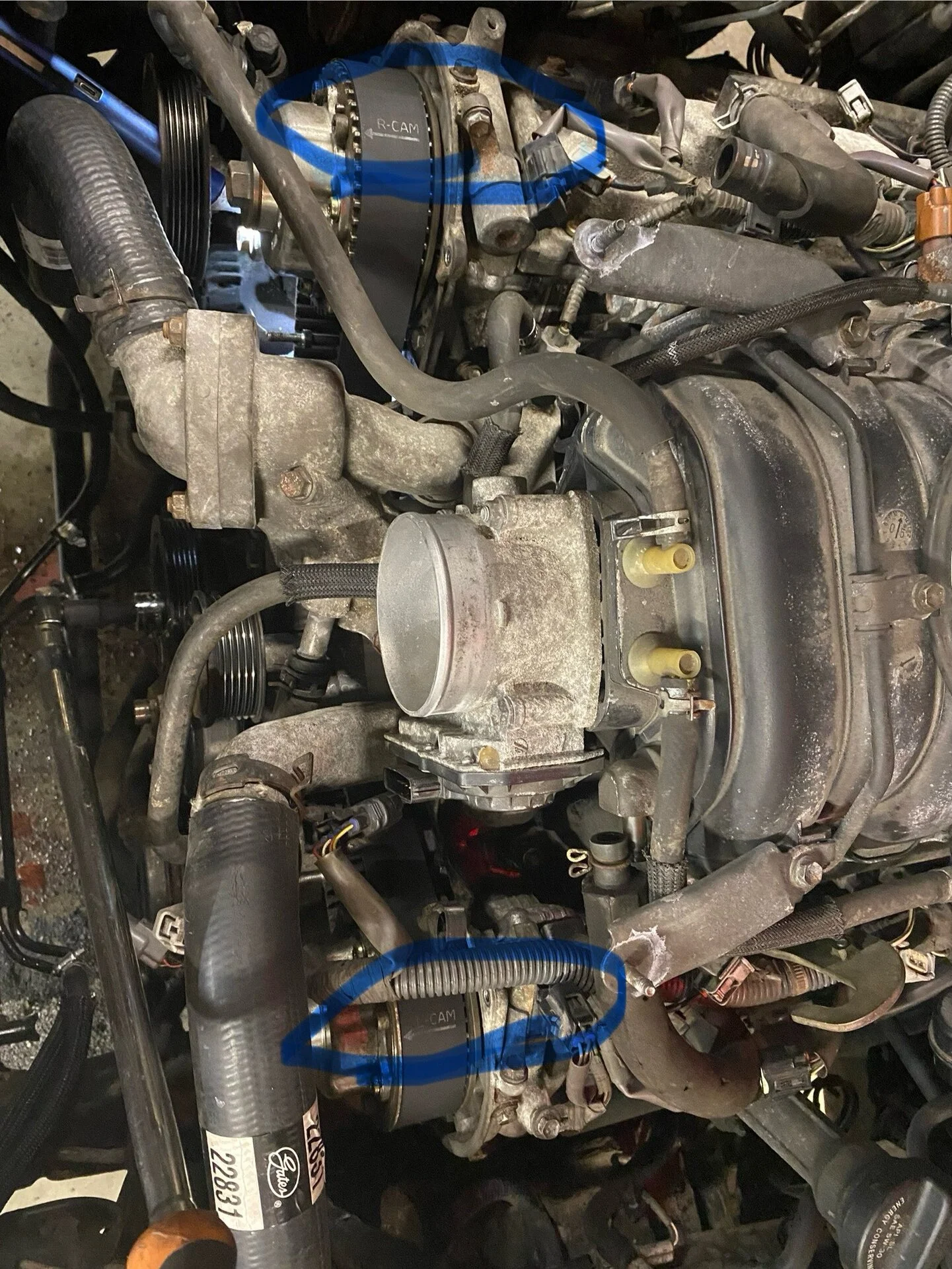

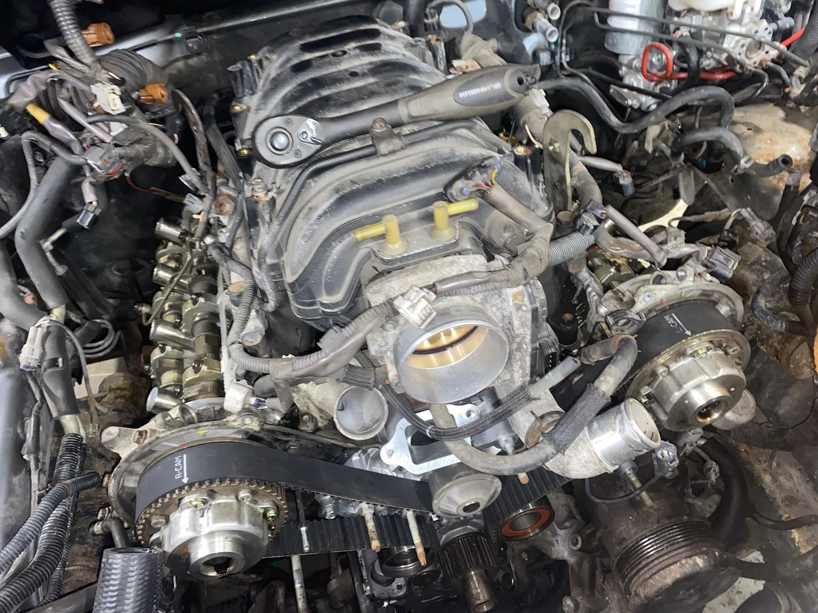

Okay, so my mechanic friend was helping me with my 2006 GX470 (190k mi). We agreed that he would do the CV axles and that was fine. I needed the water pump (leaking a lot) and timing belt (way past due) changed. He suggested that we tear it down to the head gasket and get the heads cleaned up. I agreed and now I am wishing I hadn't. We ran into one issue after another with wrong sized hardware, the machine shop losing a piece and a number of other minor setbacks. Well, he finally gets it together and fires it up for the first time and it is misfiring a ton. He did a compression test and the right side all was nice and strong (160+/-). The left side however, 0, 0, 30 and 120. Brand new head gasket torqued down to factory specs. The head was pressure tested and the valve seats were done and everything was cleaned up. I am at a loss as to what the issue might be. I am adding pictures of the timing belt and want to know if that looks right. I really don't want to rebuild the head if I can afford it. I suppose it could be burnt valves, but I would have thought the machine shop would have caught that.
Please take a look at these pictures and let me know if you think the timing is off. I suspect that if it is, the valves may have been bent but it seems odd that it would only do that on one side. Any ideas would be appreciated as I really want my truck back!

Regarding your timing pictures. Once you turn the engine over, you can no longer use the marks on the belt to determine if the timing is correct. There are marks on the crank and cam pulleys to check the timing. Typically they have a small amount of paint marker from the factory. Your pictures are not at TDC, which is how you check the timing.
Thank you. He is out of town until Monday so hopefully we can get it sorted when he gets back.
This is not a new photo, but one from when the belt was originally installed. Hopefully he can put it TDC and shoot me another picture. It really sounds like a timing issue to me.
In the picture above, the cam's are timed correctly to each other. However, I can not make out the little divot on the crank. Since L&R cams are timed correctly wrt to each other, one would expect similar compression readings L&R.
