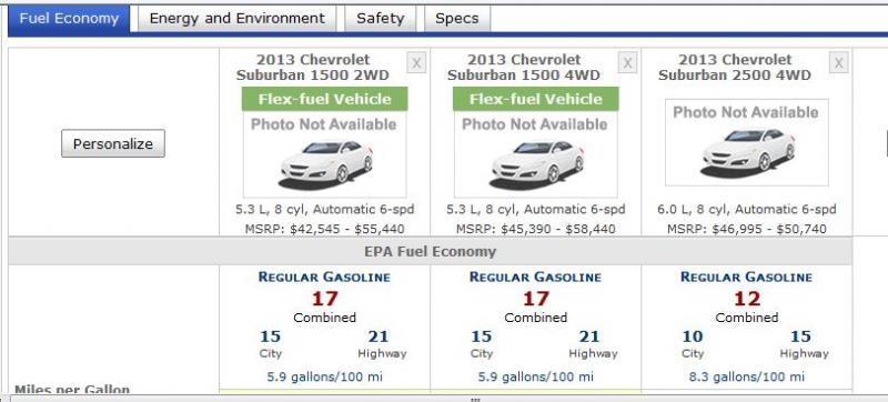

what model suburban? 1500? which one is most comparable to a LC?
It was the 1500 with the 5.3 V8 not the 2500 with the 6.0. I have heard the latter gets atrocious mpg. I was pretty impressed and would not have believed it had I not driven and calculated it myself.
