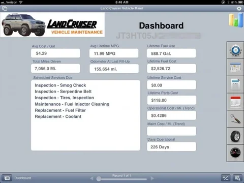

I created a database app for managing my LC maint. Within that app I built a fuel reporting piece that tracks every single fill up including adjustments for tire size as well as tracking other variables. in the last 226 days of operation I have averaged 11.99 MPG.
I use the tried and true method to calculate the mileage - miles driven / gallons used.
^ that seems about right. I only get 14-15 on full tank highway runs. I average about 10-12 per gallon on a normal tank with all types of driving.
