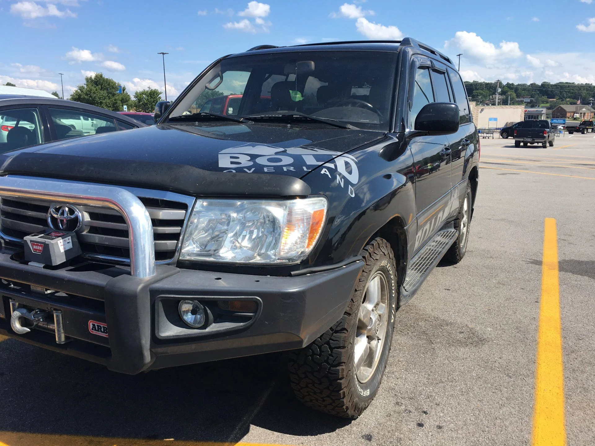

We are selling our heavily built 80 series so I can inherit my wife's 06 100 series.
Currently all that is on it is an ARB and warn 9k.
I will be building it basically the same as my 80(locked, geared, etc...)
