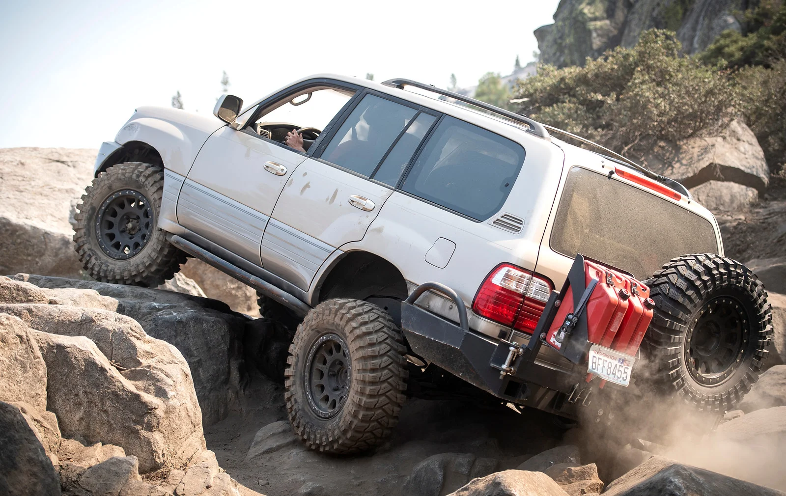

Just my 2 cents, never been to the place you're talking about but if you are getting into some big rocks etc, the 100 can be a great crawler, just needs the right mods IMO...
3/16th's full skids, they pay for themselves fast
Sliders, wide with a good kickout
lockers front and rear
35's
4.88's
Low TCase gear reduction
High clearance metal bumpers
Stronger rear lower control arms
etc...

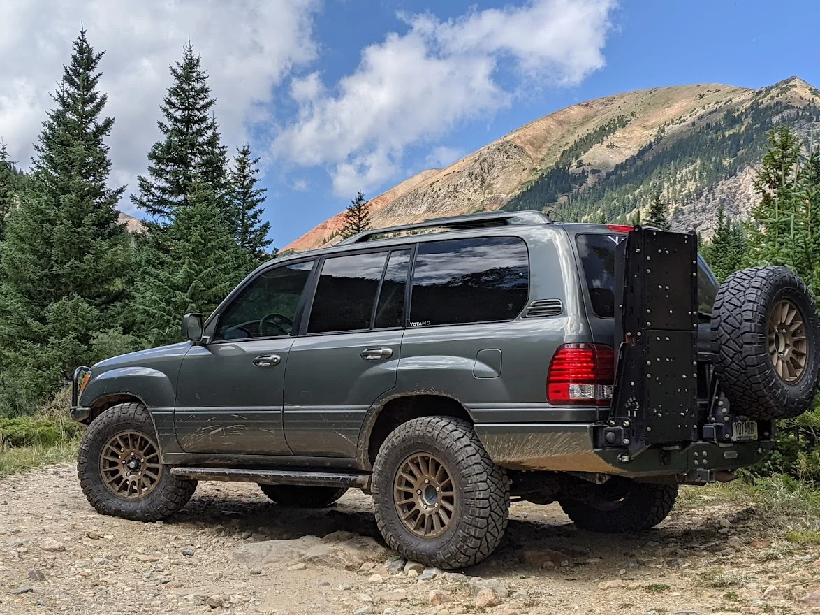

Armoring up is an obviously wise choice. I would really encourage people to strongly consider going for the best approach/departure angles possible (if crawling is a goal), this is going to help you get away with a ton while still on 33” tires. The high clearance dissent front bumper is definitely a difference maker.
My favorite mod so far was the T-case reduction gears, especially while on the rocks. It allows for a lot more precision. “Send it” is NOT your friend while wheeling the 100, and will not be your friend when it comes to longevity of critical parts. Finesse will get you so much further with this platform. The 100 is a lot of weight to be throwing around, even if it’s more durable than most.
Im always tempted to move up to 35s, but these small 33s (285/75/16) have cruised through every “hard” trail from the Mid-Atlantic region to Moab and Colorado.
