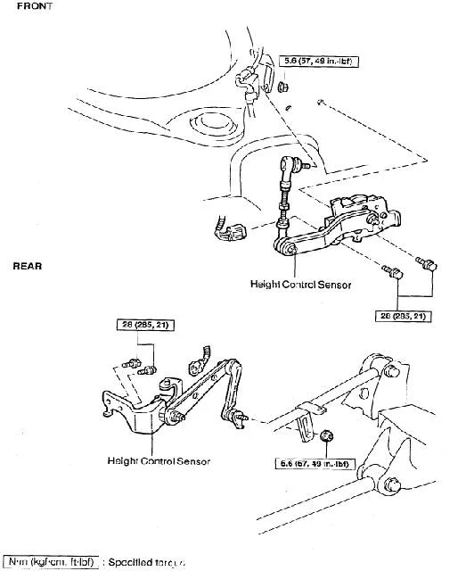

How does that work? Does it just keep it in high mode always? Or do you actually gain some clearance in high mode over the regular high mode?
Start here... 2-2.5" AHC Lift Using King Coils & Shock Spacers - https://forum.ih8mud.com/threads/2-2-5-ahc-lift-using-king-coils-shock-spacers.945879/#post-10534795
Installing the Japan 4x4 spacers allows you to keep the travel the same. And the sensor lift gives you some height. But I would not go past 2".
You can still go into high/low mode.
