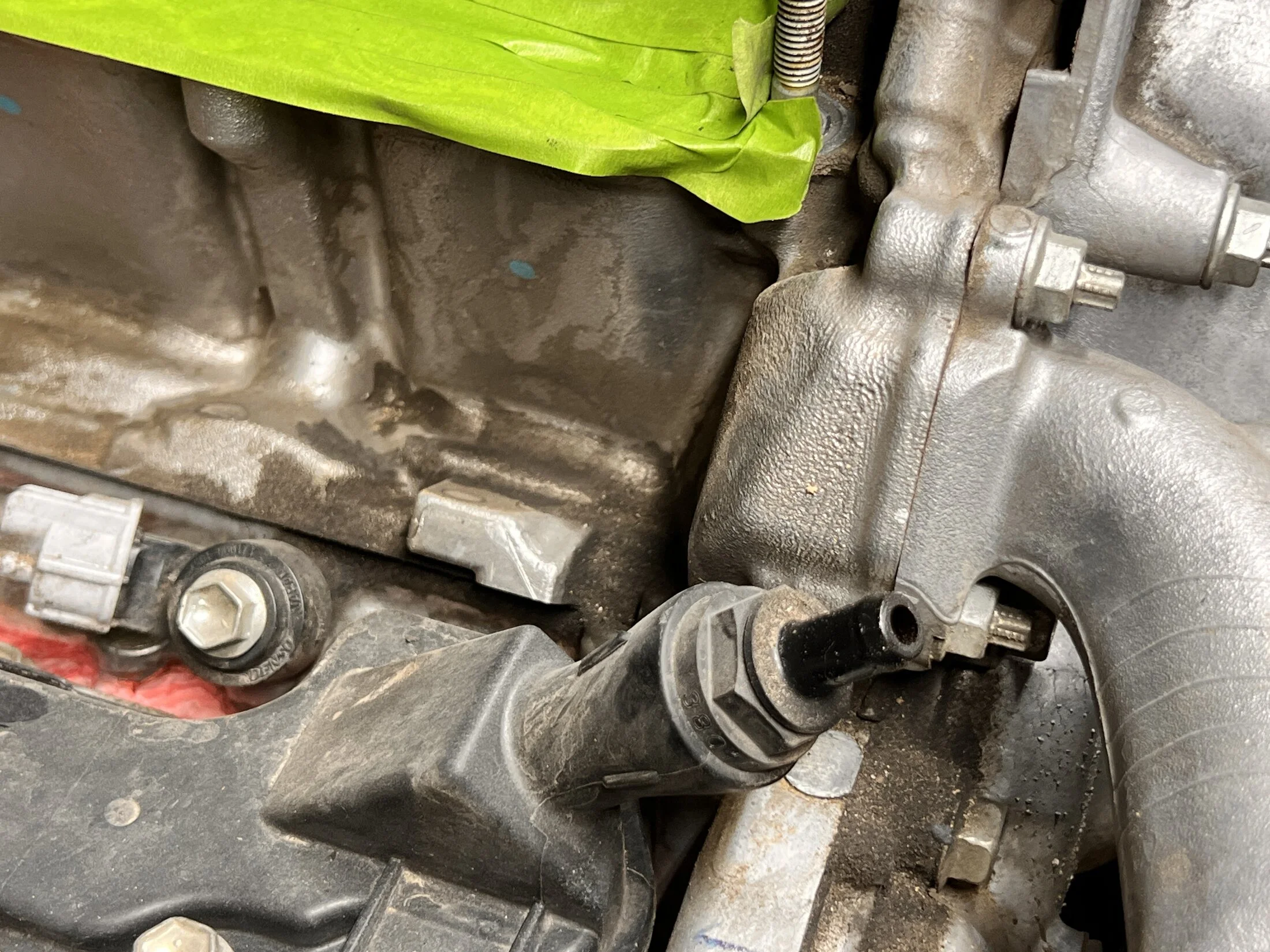

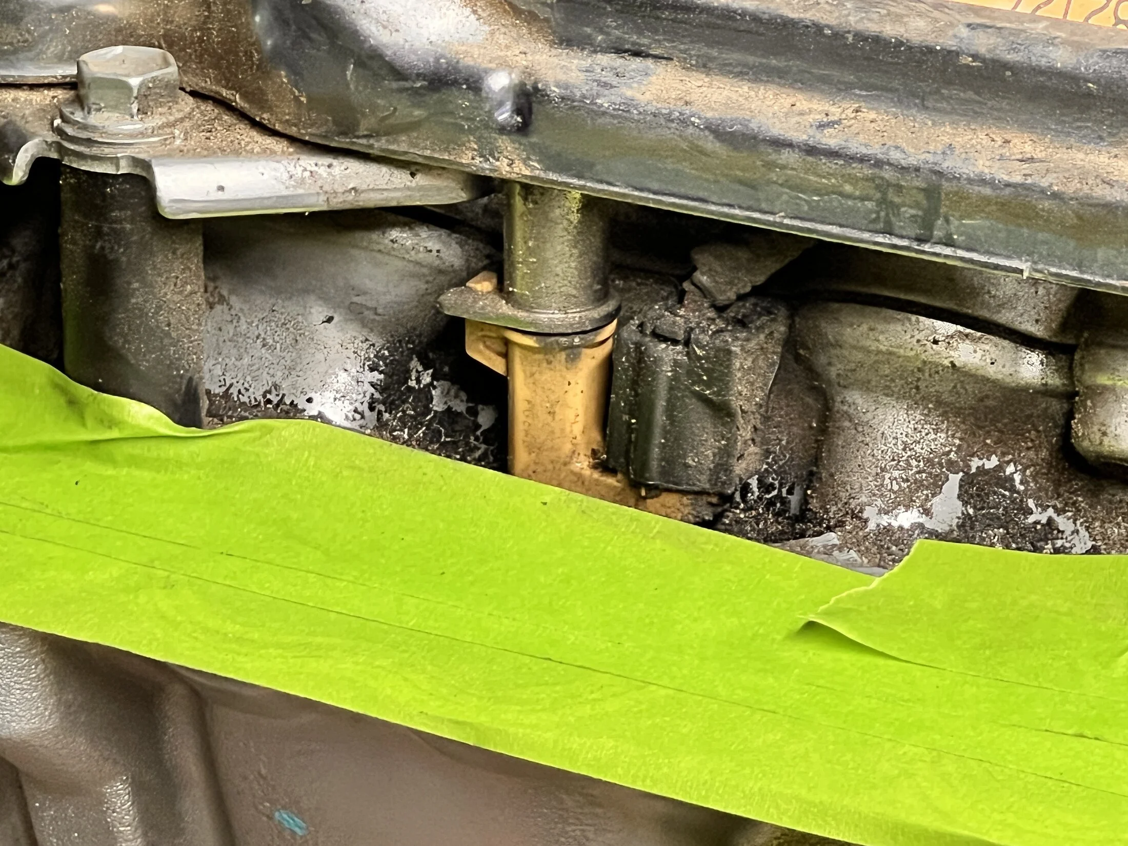

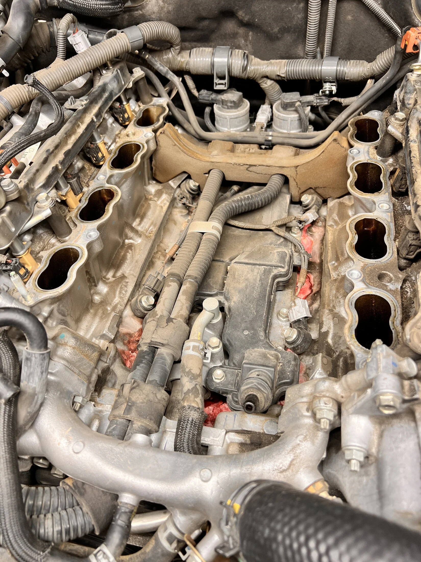

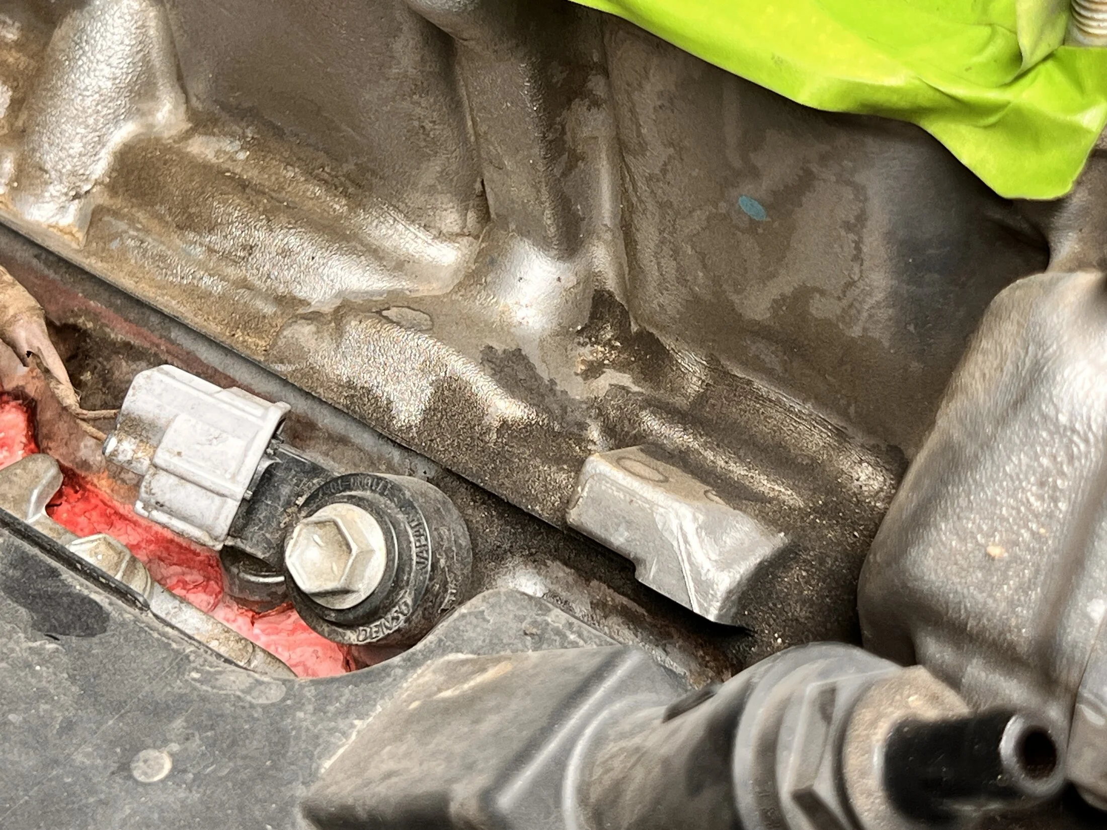

I’m deep in the valley plate fix (taking my time and cursing a lot) and noticed that the driver’s side bank of injectors look particularly dirty…like the valve cover gasket above them is leaking. I was not planning to do anything beyond the valley plate, but can someone who’s more experienced (which would be anyone) look at these pics and let me know if I need to address more?

Looks like you can get access to the valve cover with the intake manifold in place. Proceeding with the valley repair and cleaning things up a bit (without dropping anything into the cylinder intakes) seems the way forward.

This is a very long video and other than having to remove the coolant again looks like you can fix the valve cover gasket without removing the intake manifold. So I would not fix it now given there is little to no evidence of a leak. Obviously your choice and not bad either to do so. Good luck!
Check for cracks in the hose that connects to the PCV that could be contributing to the mess in that area.
This valley plate leak is such a ridiculous problem common to the UR engines. Hopefully you didn't run it low on coolant.
With it being mostly on the drivers side another possibility is someone made a big mess while pouring oil into the oil fill spout.
Personally I’d just clean it up well and reassemble, then monitor for further leakage.
Yes valve covers can be removed with the intake manifold in place, if it turns out the gasket does need to be changed.
This given the evidence shows coked oil and general dirt, not any fresh leak. So like Bloc I would leave it alone.

Oh, I’m replacing the sealing on the valley plate, which is leaking. No way to do that without removing intake manifold and a lot of other stuff. Thanks, though, since now I know I can replace the injectors at a later date.
This is what I was thinking. I hope so.
