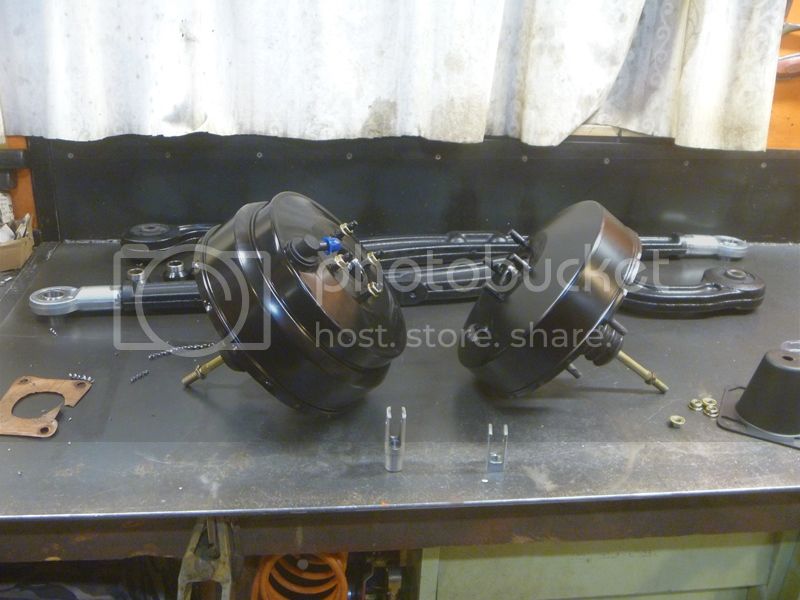

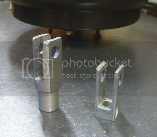

Should also drop these pics here of the 80 series booster & the longer clevis needed to link it up to the 70 series. Bolt in otherwise.

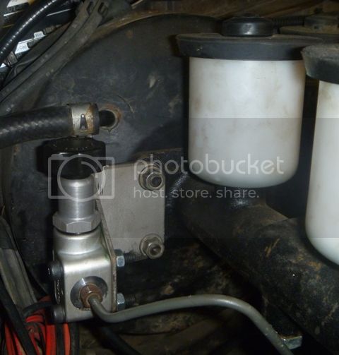

I am running 80 calipers, rotors and pads up front. New drums and shoes in back adjusted near perfect. I removed the LSPV and installed a proportioning valve. New 70 booster and MC as well and all new lines.
The truck stops incredible.

Did you need a spacer for the 80-series booster to mount to the 74's firewall? Or direct fit? I'm assuming you had to extend the linkage as mentioned earlier in the thread...
It was a direct fit but I did need an extended linkage to connect to pedal.
80 series Master had different orientation of brake lines. Made some to suit.
