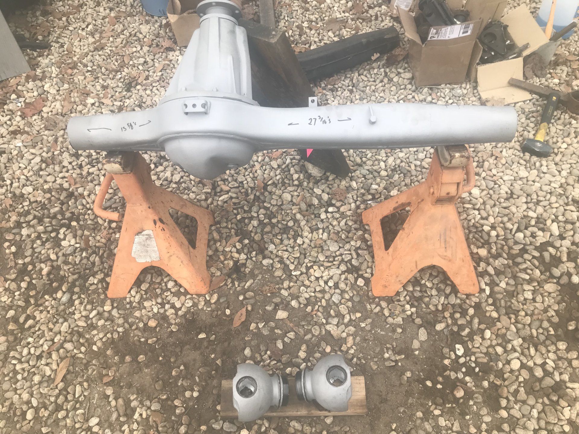

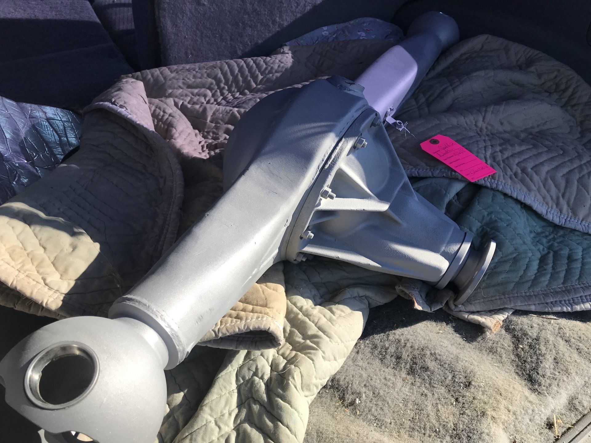

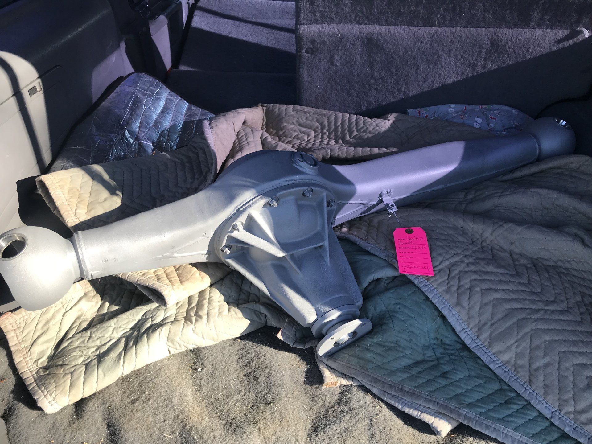

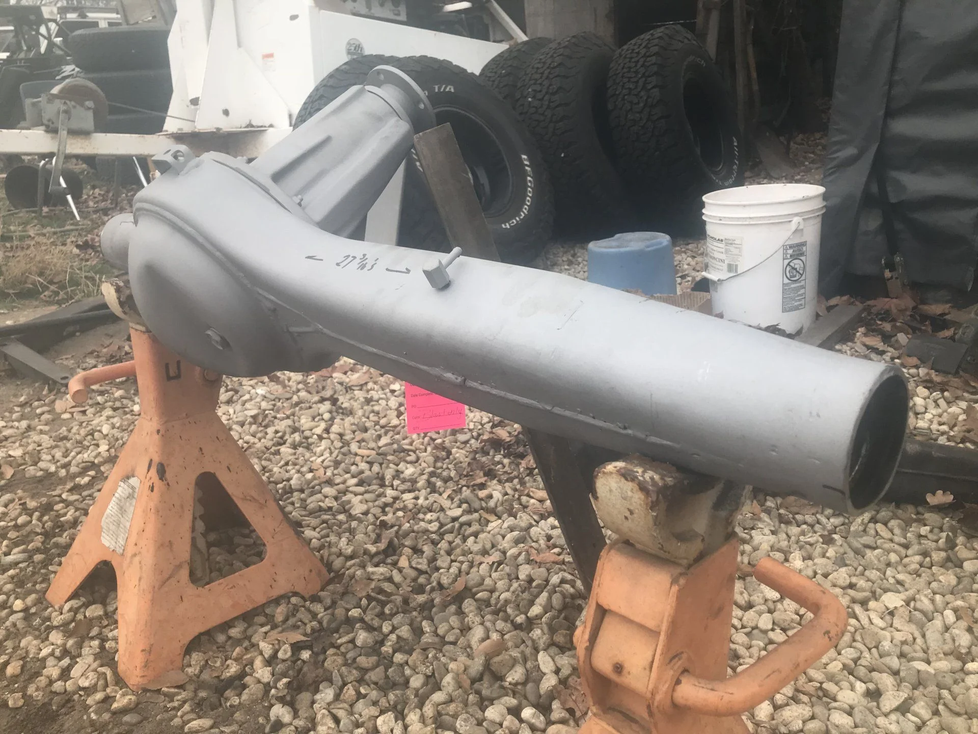

However, it would be comparable dollar wise for my client and rather than spend time on that I picked custom radius arms because it is less work. There are plenty of other things I can be doing while I wait for radius arms and the axle to be prepared.
I am far along on the fab and prep now so once I have the new radius arms and axle all back from blasting and machining I can start in on welding.

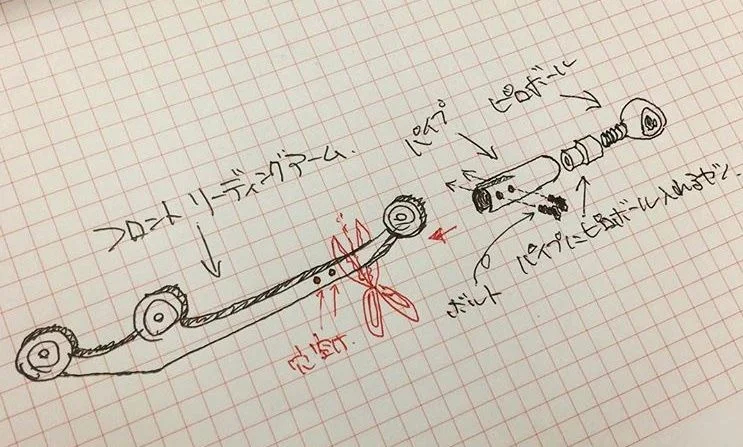

Here’s what my buddy in Okinawa is doing.

How are you working out the knuckle ball orientation with the custom Delta arms? Will the castor correction be part of the cut and turn or the control arms?
I am buying 4* arms. With 80 style steering you can only get 2-3* from a c&t but since I am setting everything up it is kind of irrelevant. What I am shooting for is 4(ish)* of caster and 2* on the pinion.

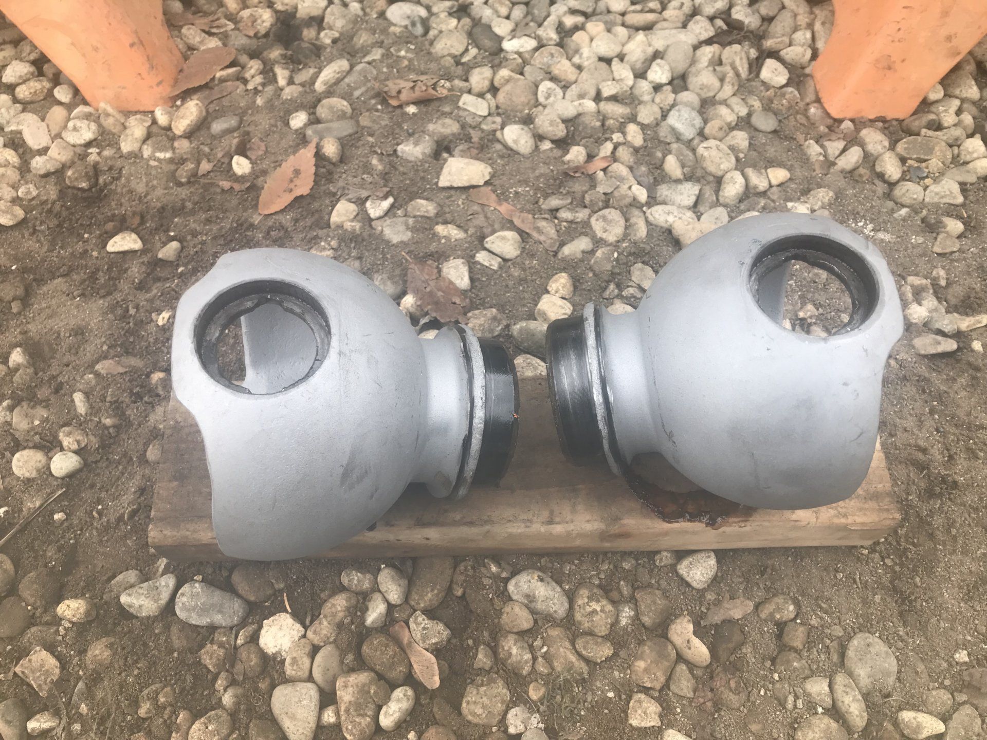

The frame is completely prepared now so it is a waiting game now for the radius arms and knuckle balls.
Cheers

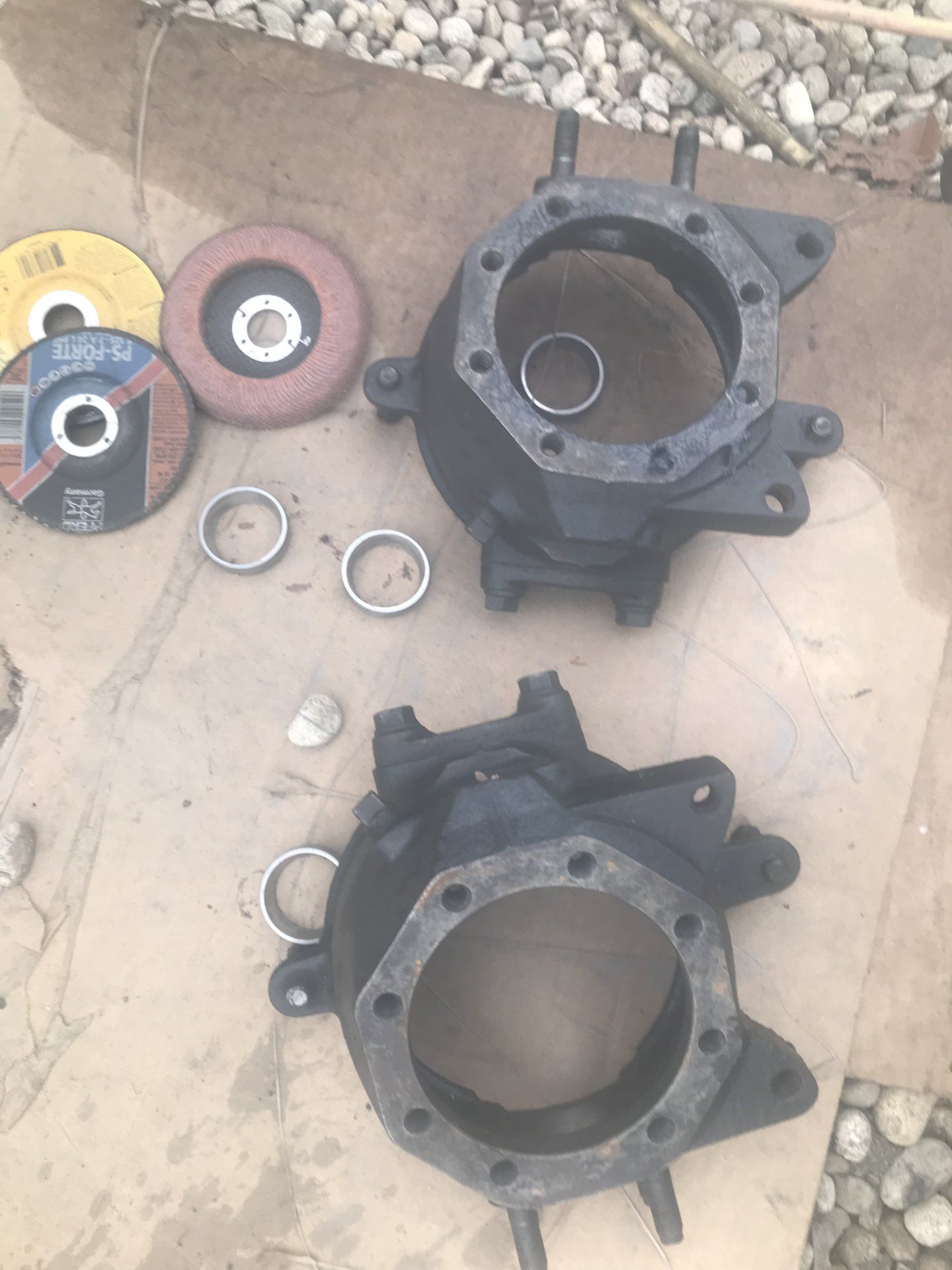

So I already have 80 knuckles. I think I will get them powder coated while I am waiting. I will be using the 79-series steering arms I bought with these knuckles.
I have some 80-series spindles laying around to use.

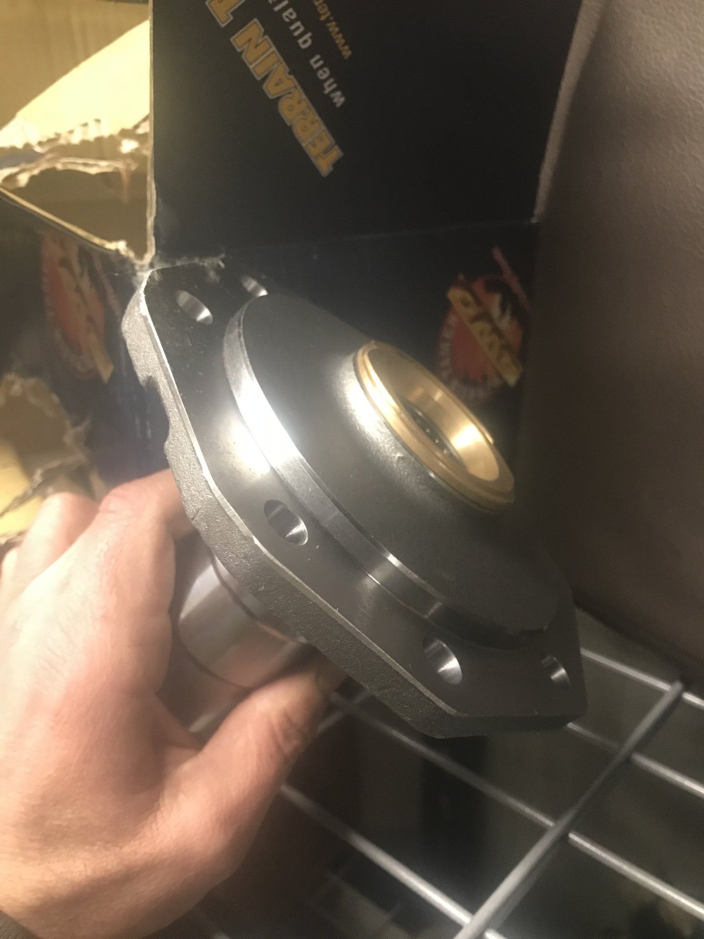

I found new OEM 80-series hubs loaded with wheel bearings and wheel studs for a screaming deal. So just the axle shafts to work out.

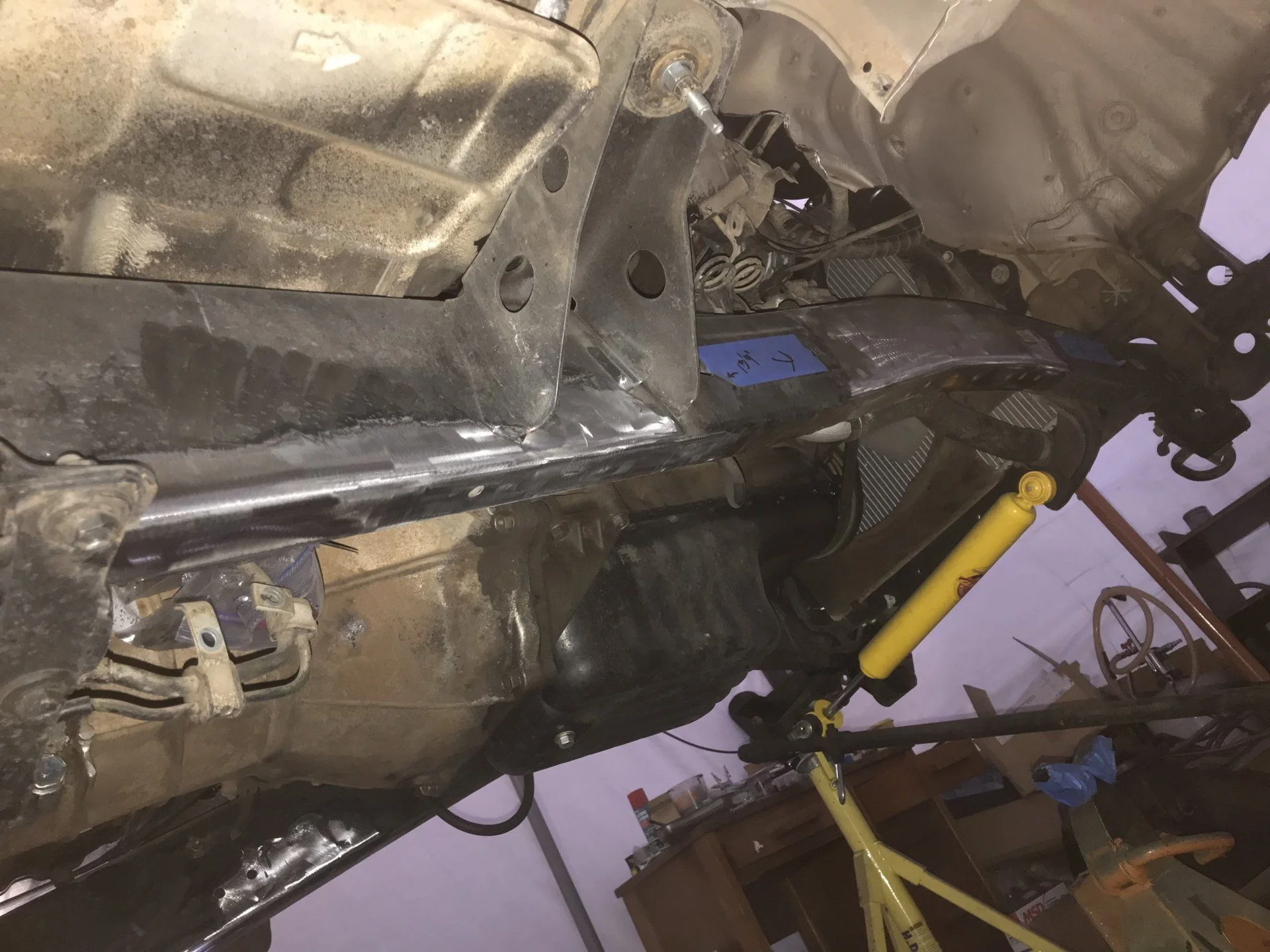

As mentioned previously in the thread, the owner wants to tow his pop-top camper trailer with the truck occasionally. Yes we all know this truck will not tow it that great but it will do it. He doesn't plan to do long distance with (HWY speeds) the trailer and this truck, short trips out of town kind of a thing.
So I have got to prep the truck for towing, his trailer is roughly 2,000lbs, I am shooting for 3,000lbs safely. Rather than try and find a receiver, which by the way this frame is not prep'ed for it at all meaning no holes, nuts, ect in the frame to mount a receiver, I am fabricating the mount. Looks like way to much work to build a reciever from scratch (or even modify an 80-series I have) to fit the truck and be mounted securely. So, I will use the rear crossmember just like Toyota did but I am buffing it up big time. In addition I am wiring a brake controller up and a plug at the back of the truck.
I am ready to install the fuel tank but I want the room to do my fab work for the tow hitch before I install the new tank.
