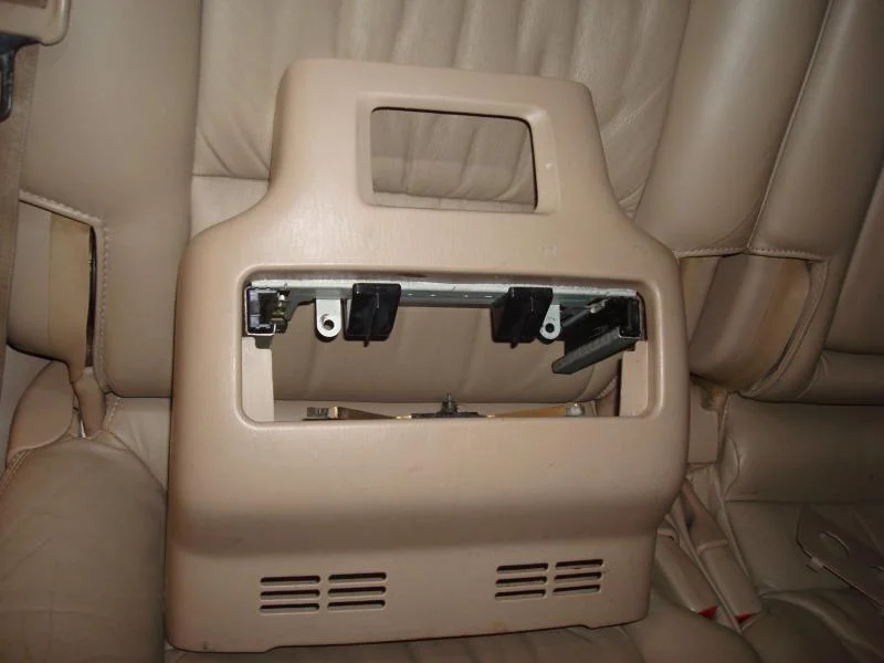

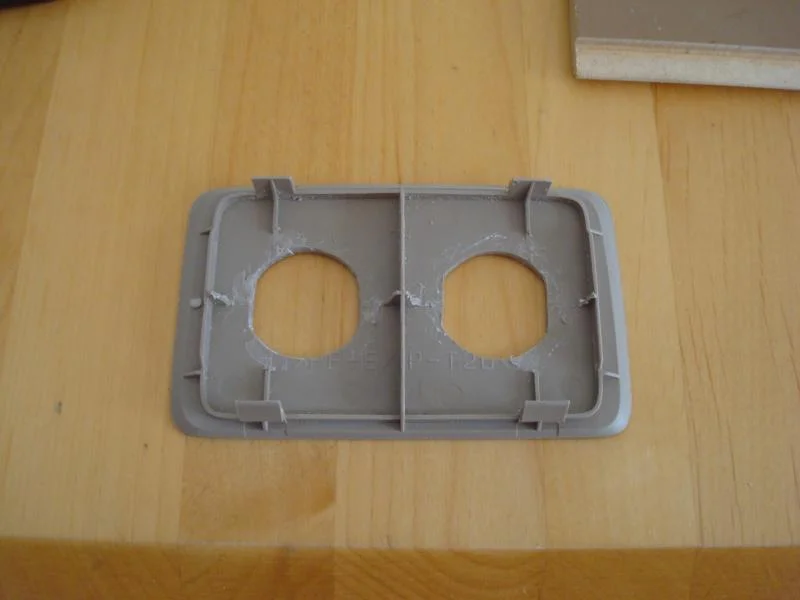

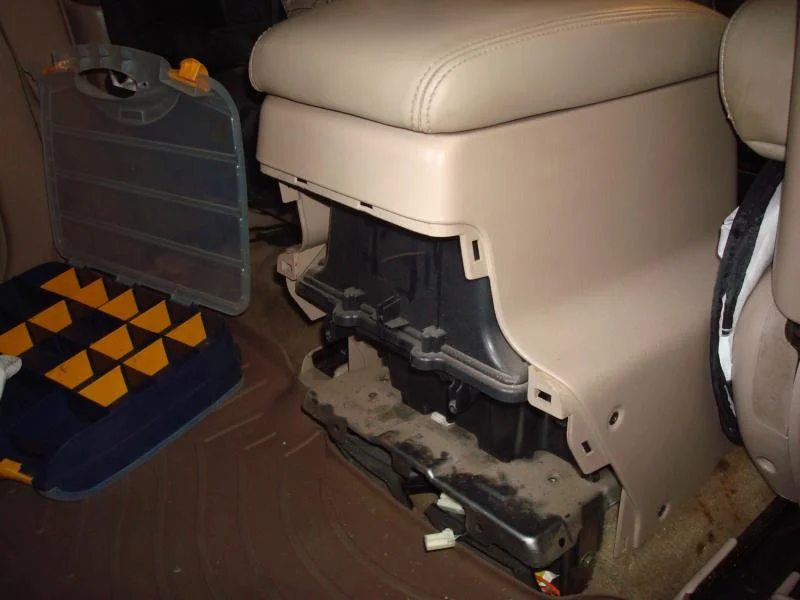

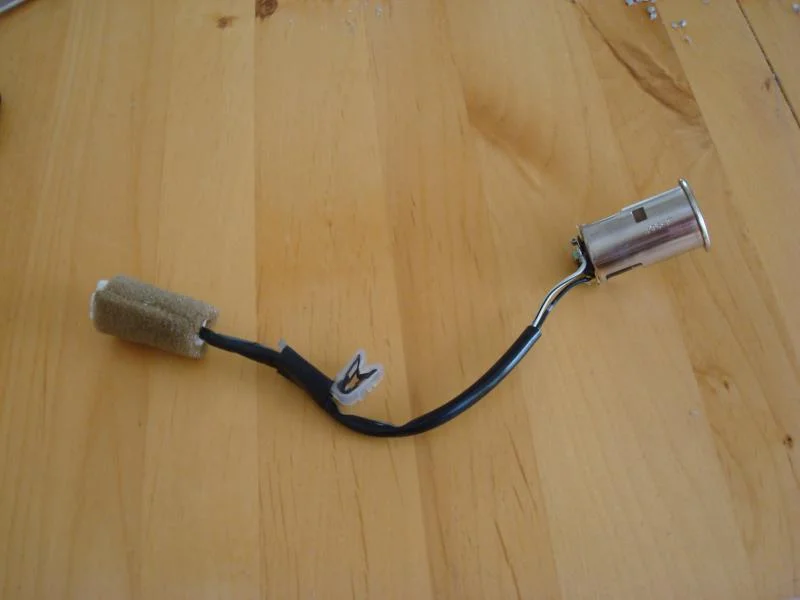

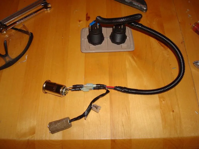

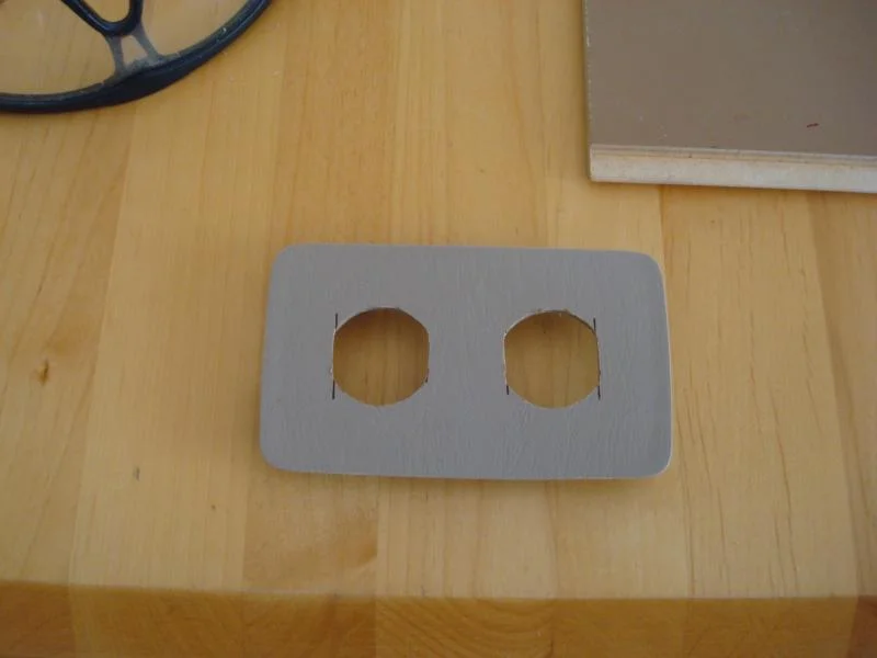

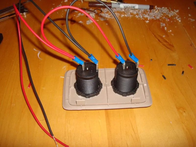

So I bought a dual USB socket as well as a standard 12V accessory socket from Sierra Expeditions. They are BlueSea components. I removed the back of the center console and popped out the filler panel that fills the hole where the rear heat controls would be for some years. Then I cut two holes in the filler panel and installed the two sockets. Lastly, I built a harness that taps into the power port that's buried in the center console because it was conveniently close to the location of the new sockets.

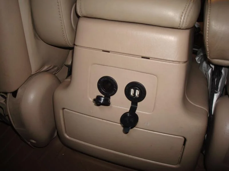

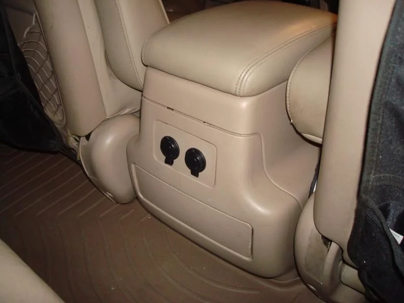

And the finished product:

This is the part I bought: USB Socket
or: Blue Sea
The rectangular flange is optional during installation, just depending on how you want to install it. I just made the hole match the back of the socket and used the nut to secure it.
It does draw power even when there is nothing plugged into it, about 15 mA. There's a cute little green LED that lights when power is applied to it.

Nice job Marc. Are you using the 2 amp USB sockets or 1 amp? Seems like the pads these days like to have the higher amperage units.
A suggestion I have is to wrap electrical tape (or heat shrink) around all exposed spade terms. Just in case one of them comes out (they expand due to heat) and doesn't cause a short. On the same token, use a pair of pliers to gently squeeze the female spades a little more so they really hang on tight.
Yeah, I was thinking about that. I'm going to try to find some shrink tube for them. All the female connectors have a very snug fit so I'm not worried about them backing of. The socket can supply up to 2.1 Amps. It does not specify if that can all go out one USB port or if it's really 1.05A X 2, max.
