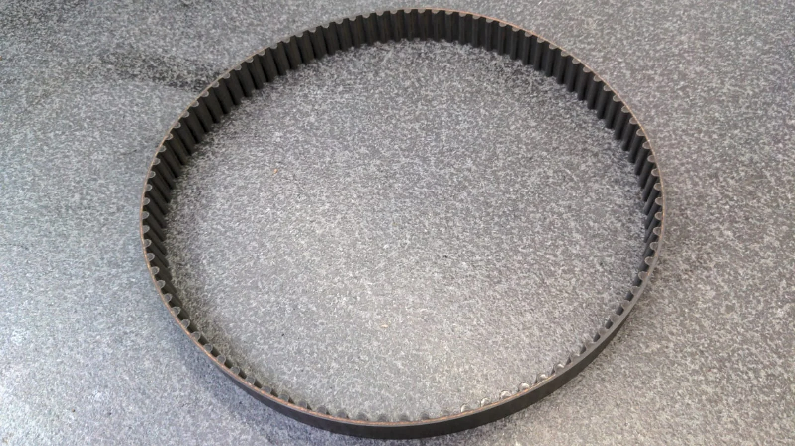

I picked up the replaced parts at the same time and am going to keep them for field spares because to visual inspection they all look fine and the bearings on the water pump and idler don't seem bad.
I am, however, very curious about what level of maintenance this former government vehicle was getting. It could help us as we tear into the truck.

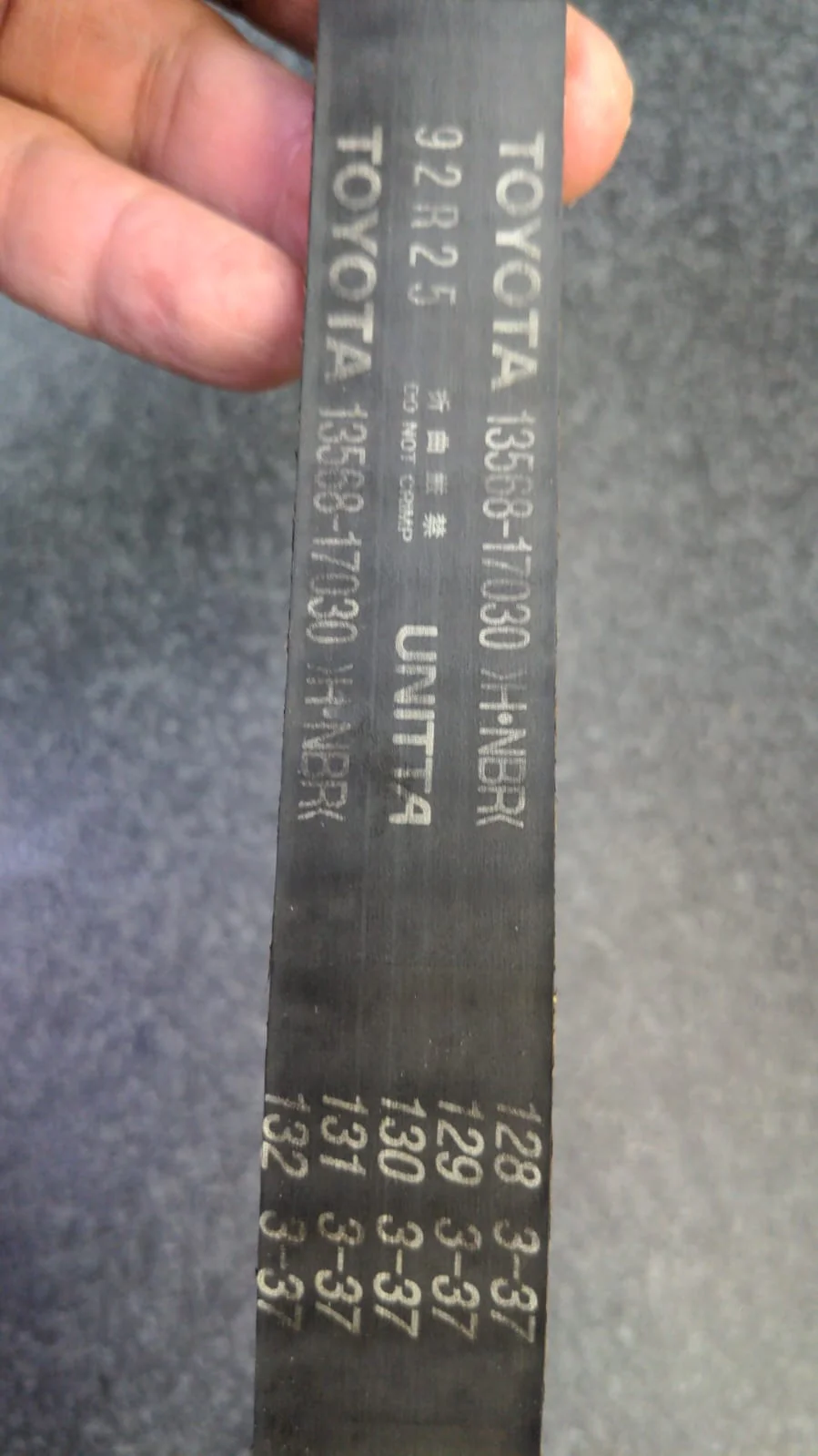

I am hoping that the collective wisdom here can help me decode the timing belt markings.
The only thing that looks like a date code is the 3-37. Can anyone enlighten me?
Im unaware they have a date code. With timing belts, you either use them or throw them away. If a belt needs to be changed, you should be using a new one. And if you need field spares, I would only have new one as a spare. But they do not fail very often and will do 3 times the 100000 klm service time. Belts dont just fail, they normally drop grey dust out of the bottom of timing belt cover long before they fail.

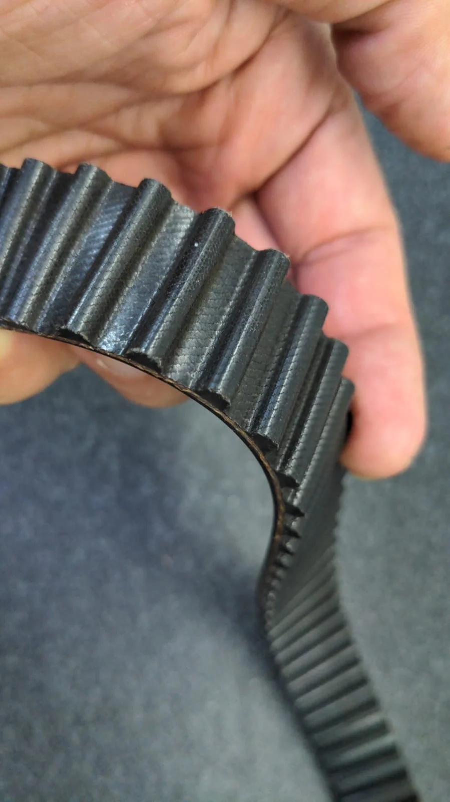

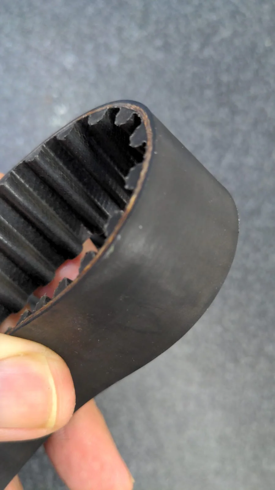

Judging by how shiny the rubber teeth are, it's got its fair share of use on it.
Looking at it in isolation, it's hard to tell just how much wear they have.
Lay it beside a new one, and match up the teeth, you'd see just how much rubber is lost from the teeth.
This affects cam timing. As the belt wears, cam timing will retard.
I would not reuse, not worth the effort.
