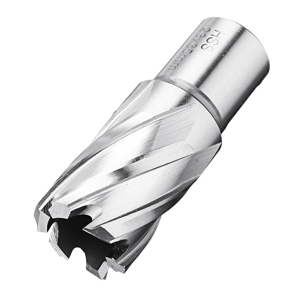

It's been a few years but I've used a bit like this on both an upright mill and a drill press, works well.
Is that an annular cutter? I think I was looking at those but was worried about snapping it if I have too much movement in my drill press spindle.
You are correct. I didn't have any issues but if I remember back I wasn't cutting thru 1/2" plate.
Could be worth a shot, depending on cost of course. If just knocking out a few holes a 1/2" bit will work, just get some cooling spray.
