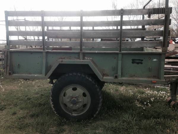

It does look like the last trailer I posted is the M116a, the plain flat beds go for about $500 at auction. I could make some light weight sides for it possibly.
Yeah, the trouble is finding one, but a M101 CDN is probably your best bet if you want a ready to go military trailer that is about the right size. You can add side racks if the bed doesn't have enough capacity, although you'd have to fab stake pockets or something to attach them somehow.
Keep in mind that the 1/4 ton rating is the amphibious capacity, i.e. what it can float ashore or across the creek. Actual axle rating is at least 4x that, probably more, as it's probably of a similar capacity as one of the Dexter 4500 lb axles.
The M101 CDN can handle up to 33" tires in stock suspension trim, although the stock fenders likely won't cover them legally in many states. I had a set of custom fenders made that bolt on just like the originals.

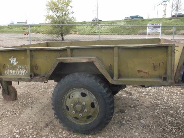

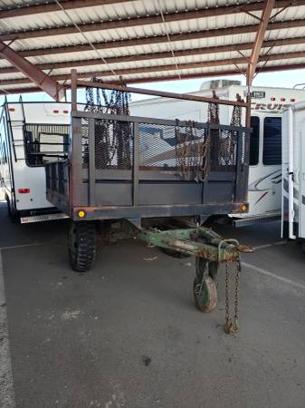

Anybody know anything about these trailers?
What size/equivalent they are?
Not sure if they are M105 or M101 sized.
I have one of those, that started life as a generator trailer, stripped down to the frame for a camper build project I am SLOWLY progressing on. It is 84" outside of fender to outside of fender.
