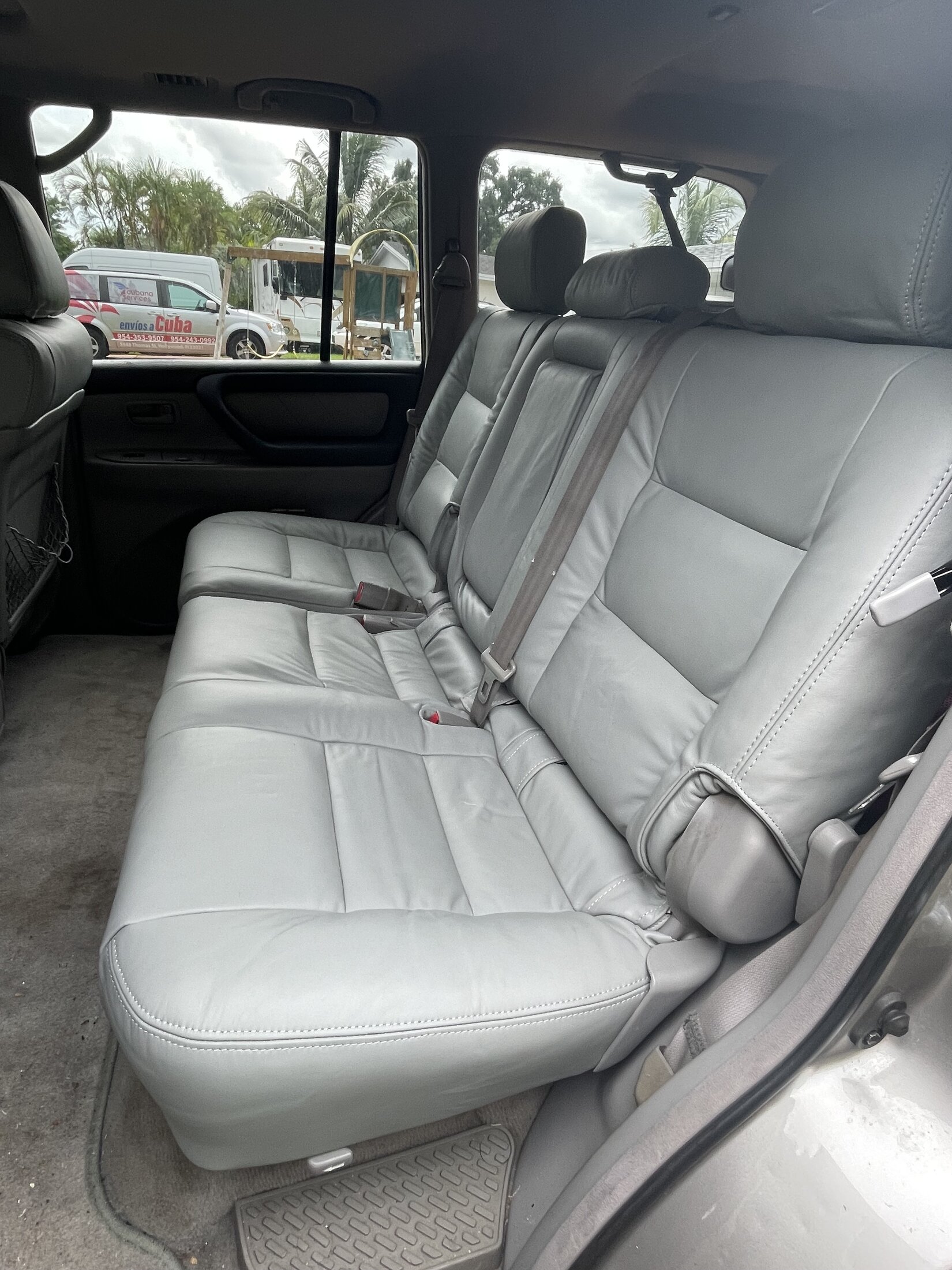

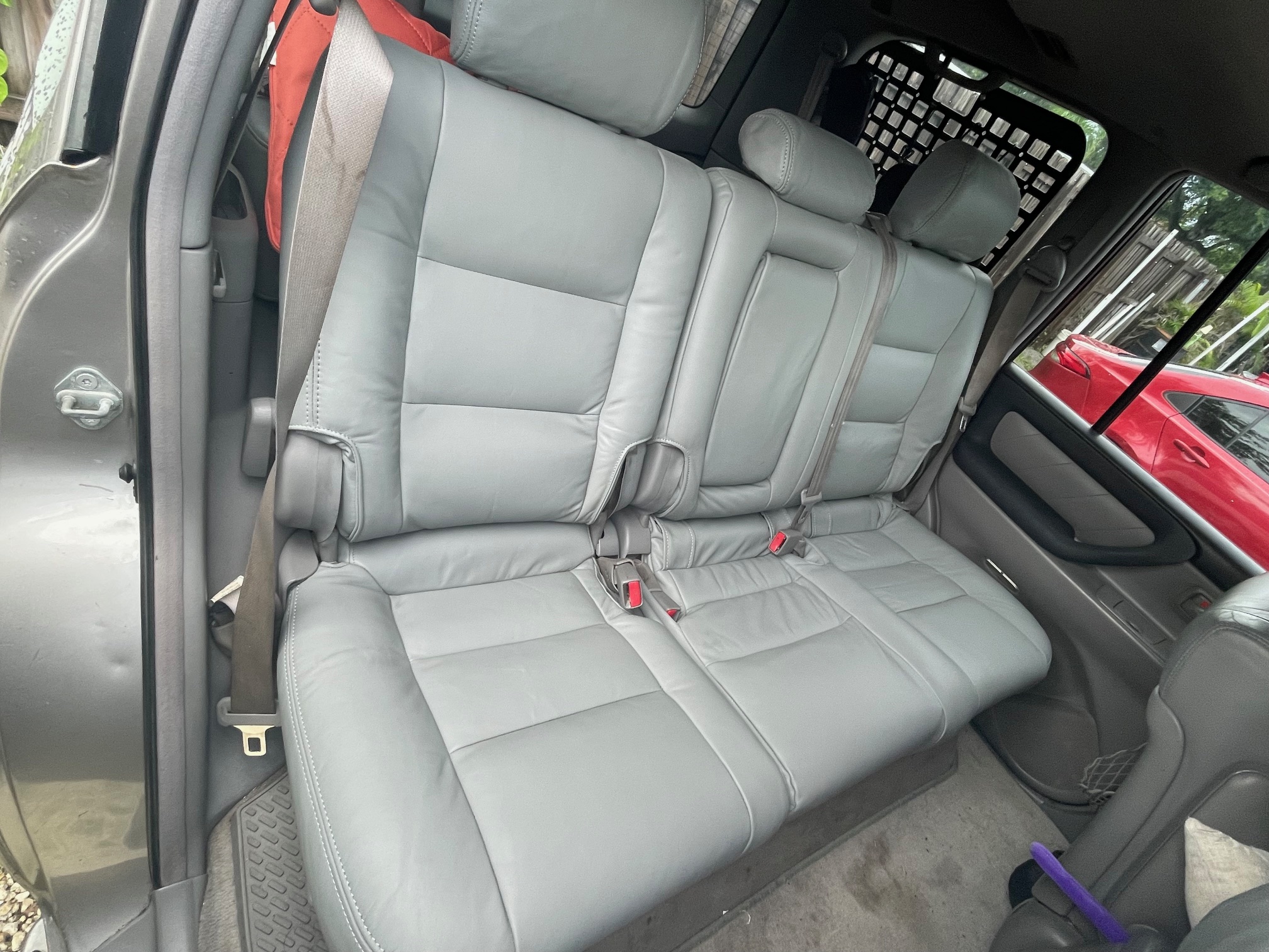

Hahahah, yes, it was definitely a pain!
Overall I'm satisfied - I got my leather from Mosley Motors, but the reinforced area for the middle seat belt to come through was 100% just off where it was supposed to be by 2" or so, and there is zero provisions for the child seat anchors - so I'll have to cut my nice new leather at some point to access those for our 9 month old. ☹️.
Otherwise, happy with the leather and my execution:

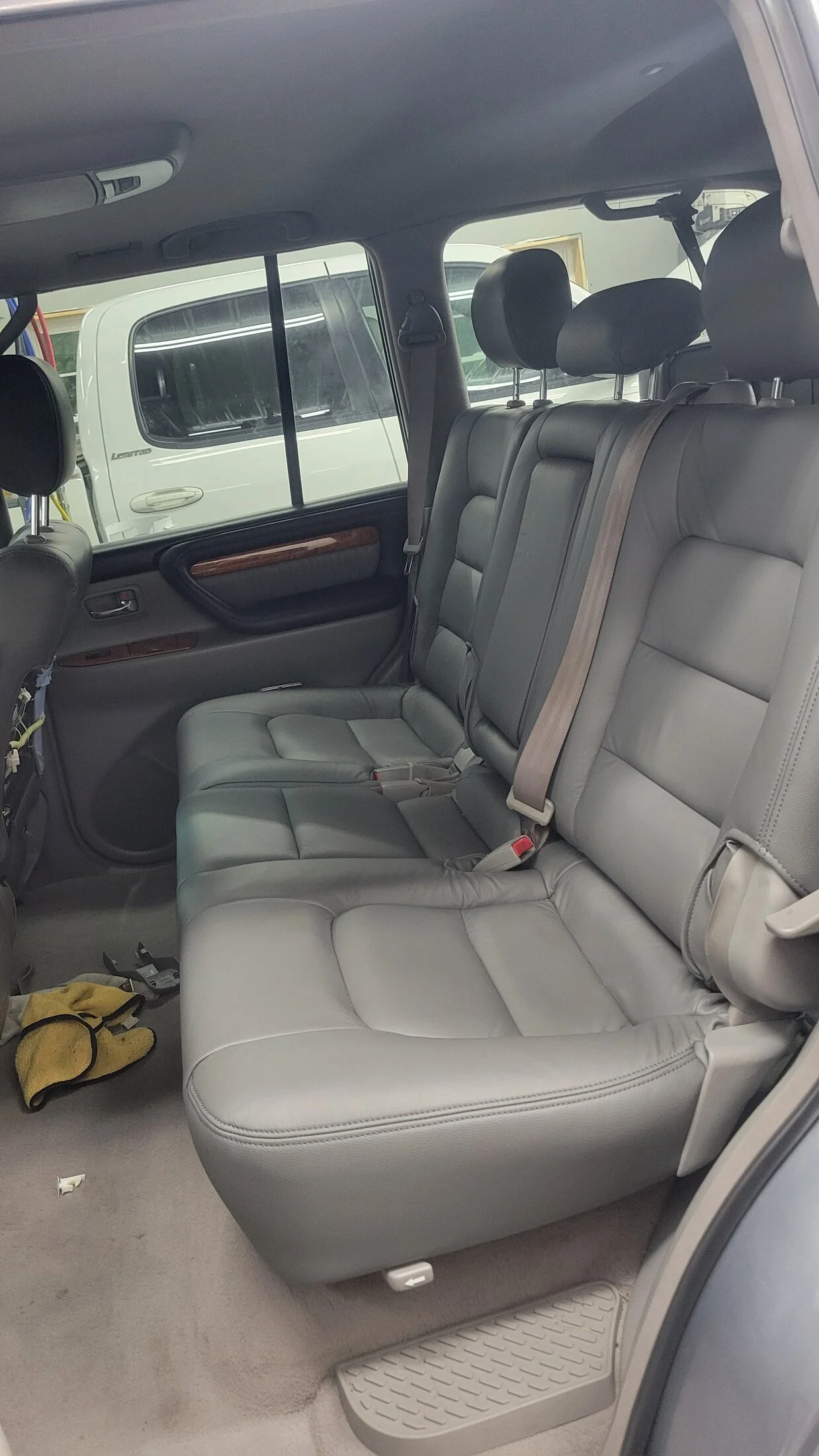

Finally done w the 2 parts of the rear seat (middle). Started yesterday at 7pm till 1am, continued from 8am till now 3pm.
Not fun.
The front seats are not easy but definitely doable, and a joke next to the rears. I’m beat. Broke a few things and made a few mistakes, don’t care, I’m not touching that bench anymore!

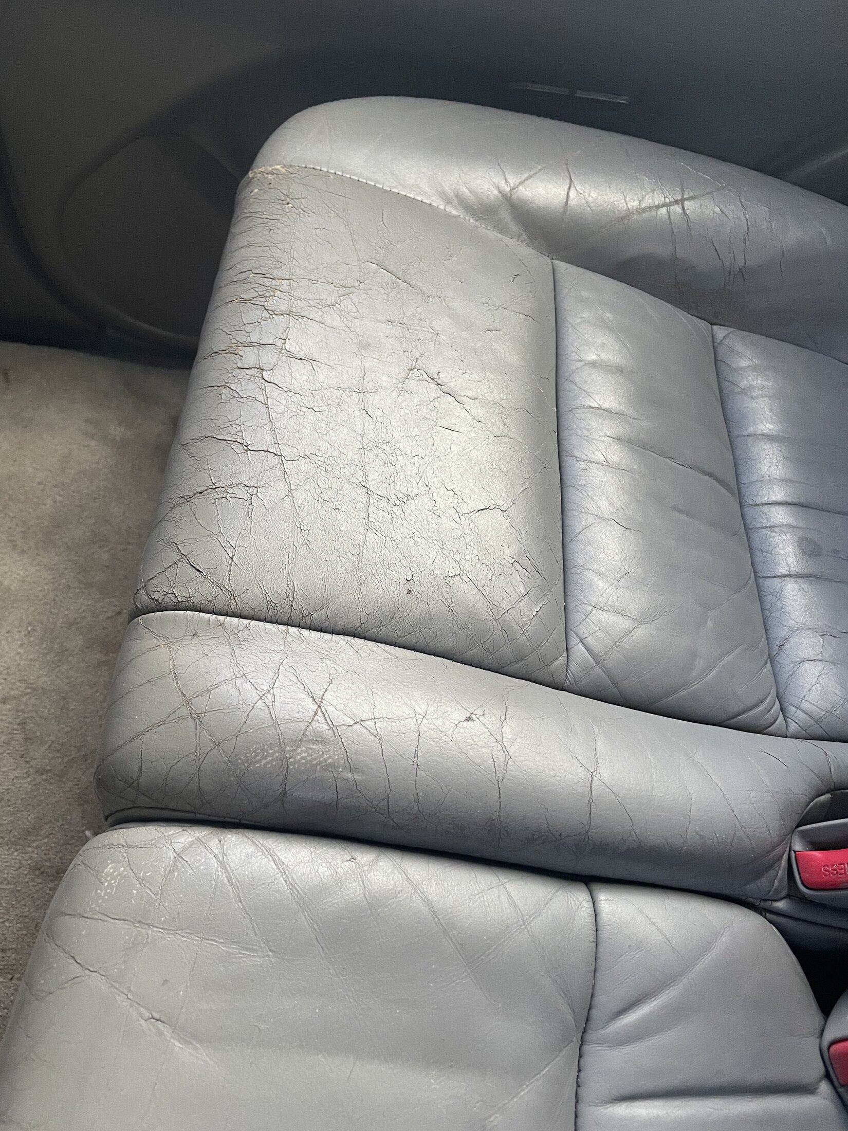

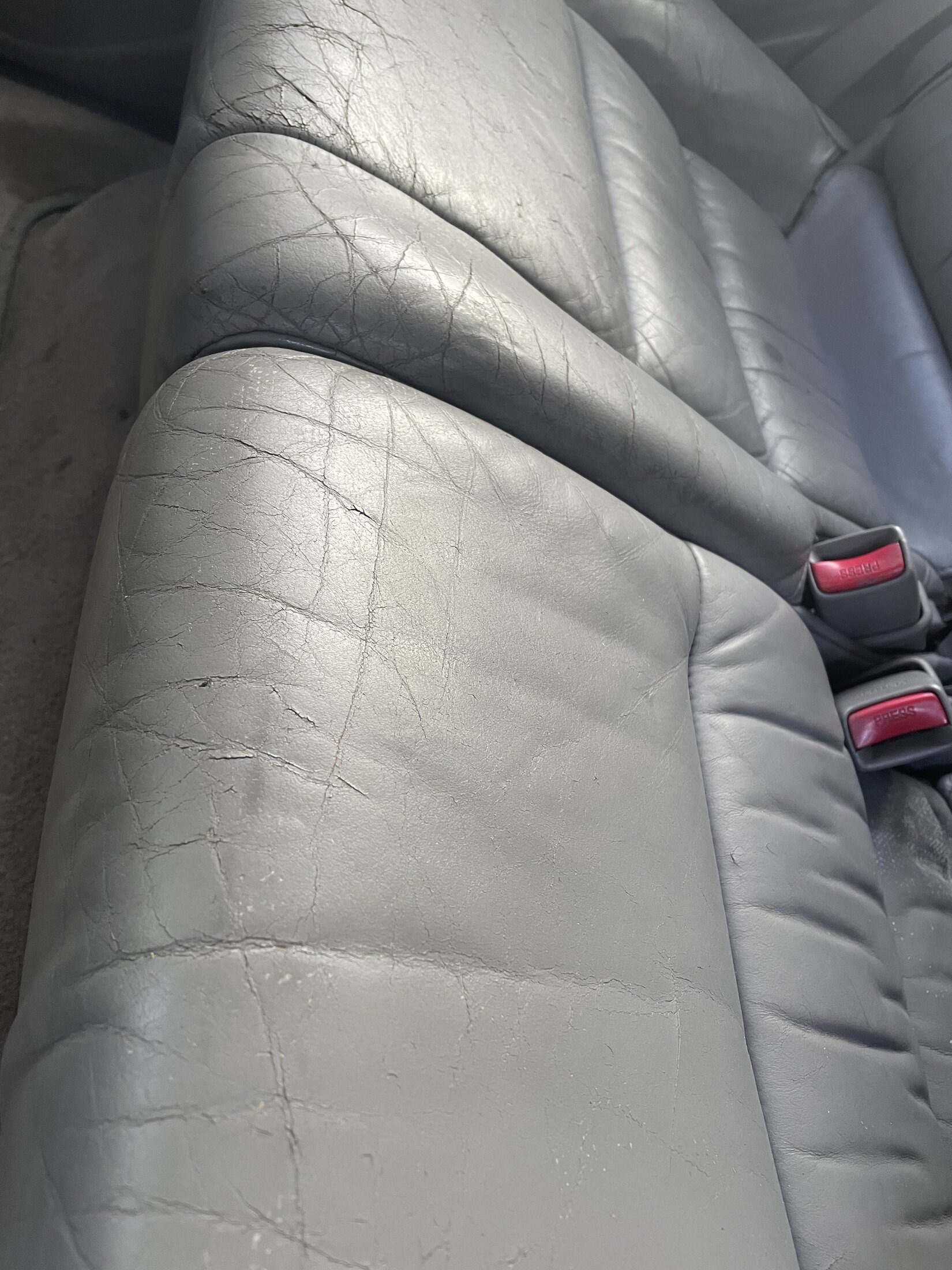

Before and after:
Last is the driver’s seat, got new bottom foam and waiting on a new seatbelt latch and back seat pockets from Serra Toyota to proceed..

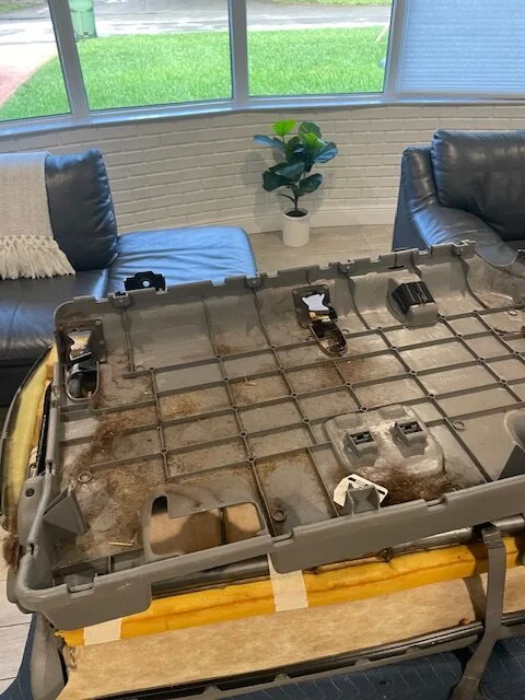

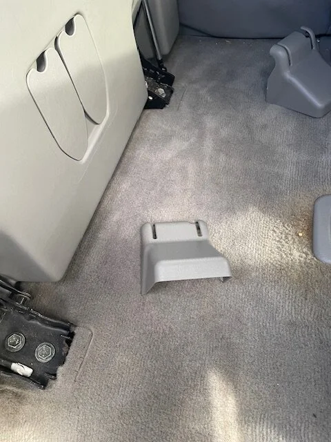

The fist step is obviously removing the bench from the car, 4 14mm bolts after you get the plastic covers out of the wa
Get it inside while you break your back and scratch everything in the way

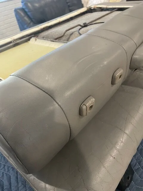

Remove the headrest posts, or clips, whatever it's called. Held from underneath, a long screwdriver and some pressure did it. Make sure you snap a picture to put back the same way so the headrest clips in later

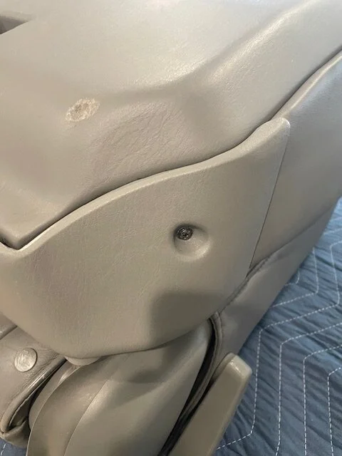

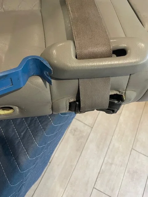

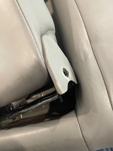

Bottom of the seat, remove corner trim and plastic lever cover. These are JIS screws, so be careful if you use a Phillips
Start working the plastic sewn to the leather, it's a clip and it's been there for over 20 years, so don't go crazy, go slow
I used a combination of screw drivers, trim removal tool, force and very bad words.

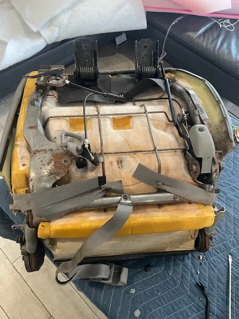

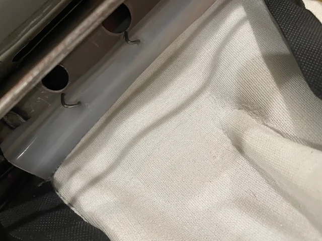

After the whole surroundings of the leather was released from the plastic tub, there's 10 or so screws holding it, screwed directly to the metal frame, a couple are hidden, a flashlight helped locating them
Twist the straps and pass through the slit, remove plastic bottom, set aside and clean, it's nasty

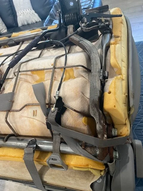

Now snap several pictures, you want to keep record of the release cables, and the straps holding the leather. Unless you got the cover directly from Toyota, the chances of these straps being even remotely similar are low, but you want to get an idea of their position, some run below the bolted hinge, some over..
Remove the bolt holding the seatbelt and seatbelt latch. The seatbelt will stay there hanging and bothering you during the rest of the job. The latch goes in a degreaser bucket to soak since it's nasty!
Start removing the old rings holding all the straps, again, AFTER you took pictures of their position.

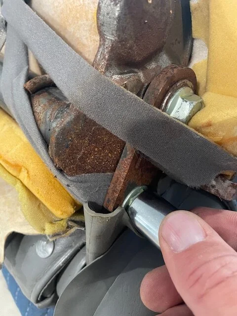

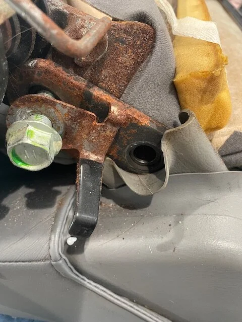

Then get a 17mm and hammer drill these off separating the bottom seat from the hinges, and taking note of the way you should reinstall the tabs that will hold the corner plastic trim

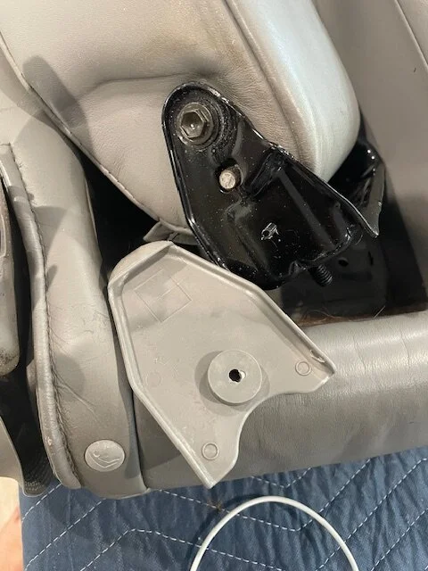

Separate the hinge from the seat frame and set one of them aside, I started with the back rest since it seemed like the most complicated one with that BS armrest in there, and IT WAS..

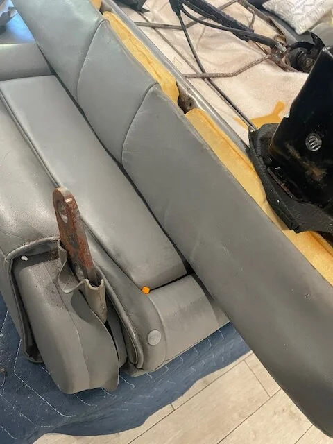

The folding arm rest..
It swings up and down inside a frame, the frame is installed on top of the leather in the cavity where the arm folds into. That frame is held with 2 nuts on the back, and the square shape is given with wires hog ringed to the rest of the frame.
Took me a few to figure it out without making a mess, and this is the reason I'm writing this, since I couldn't find any info on it.
I guess all vehicles rear seats are similar, but I never took one apart, so it's all new to me..
After taking these nuts off, you can move the armrest a few inches and expose the 7mm (?) blind nuts holding a little cover, and remove the 12mm bolt separating the armrest from it's frame.
Pay attention to the way the frame is installed, not sure if it can be reversed by mistake, but if you do the armrest won't work. I marked it with a Down arrow..
I also marked the way the insert goes after I peeled the leather off

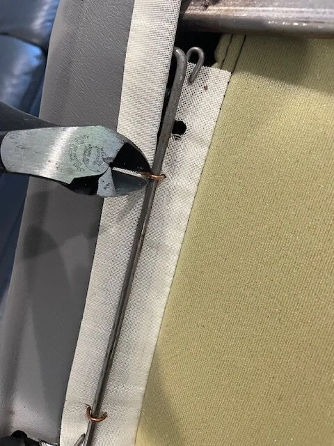

Begin removing the old hog rings in the back side, the proper way to do it? No idea..
The way I did it after a few tries is by grabbing and twisting them off, if you cut them you'll end up with 2 annoying little pieces of sharp steel in your foam, but if you manage to twist them off you might get lucky and remove it whole in one move.

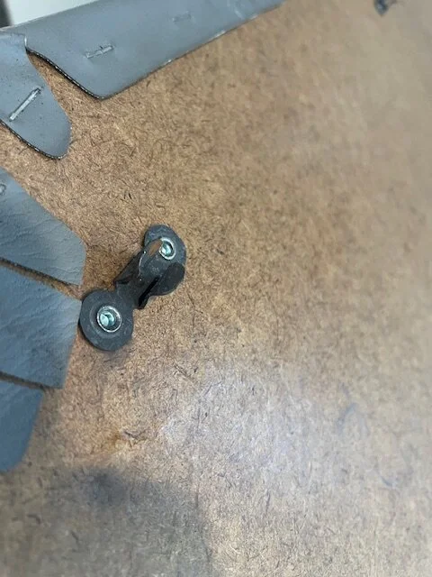

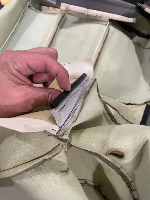

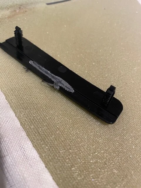

On the old leather there's a little plastic bracket sewn to it that has 2 clips, they clip onto the 2 little holes on the corner trim, I managed to transfer them to the new leather after cutting the old threads, but just on the double bench. On the small one there was no way to bring the leather close enough to install using the clips, so I left them off.
I believe it was BC I glued more foam on the small seat, since my mother in law usually rides there and I want her to be comfortable...;)

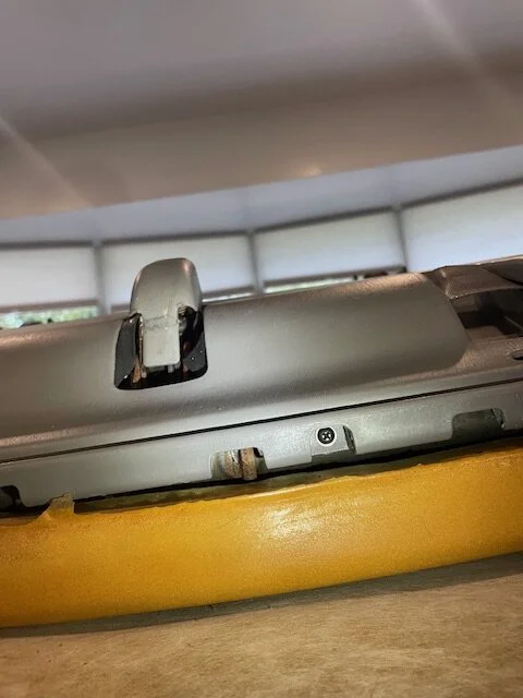

Now remove the corner plastic covers held with a small screw each, and carefully slide off, the have some tabs in the back that might break if you just pull them straight off.

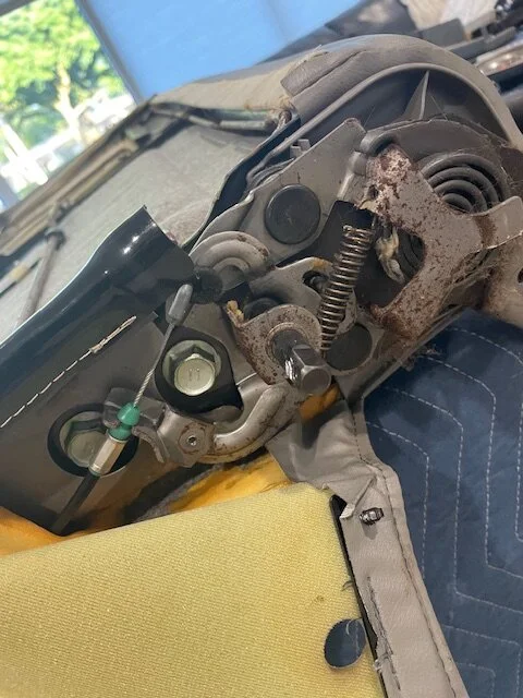

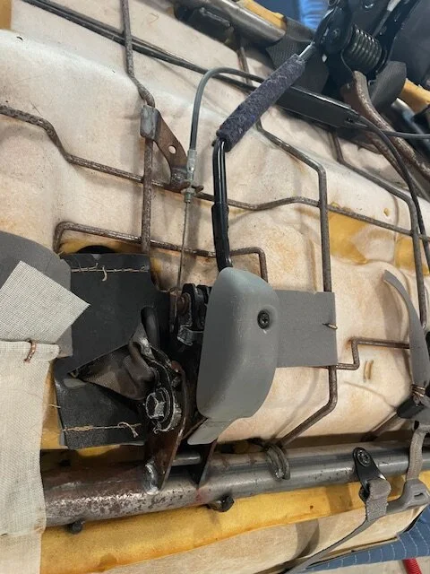

As you can see, you'll be exposing the hinge. That little S ended cable is easy to disconnect, just be gentle with the green part.

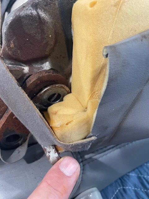

I don't really remember why I had to remove the hinges there, either BC a leather flap goes under the hinge, or the cable is routed some way that needed to be moved.. anyway, when you'll get there you'll see..

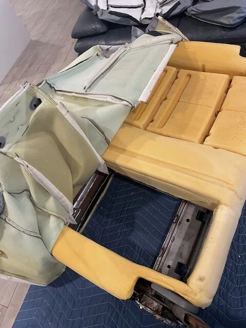

Peeling off the leather. Every hog ring has to come off, a head lamp is useful since you'll be trying to get close to see what you're doing under the leather, and blocking your light. Just be mindful that the wires in the foam are old, and probably rusty, and you will need them again when installing. I fixed several foam pieces that opened up trying to remove old hog rings.
To avoid mixing wires up, I removed all rings and all the old leather, and only after I was ready to install the new piece I transferred the wires to their respective sleave.

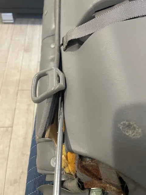

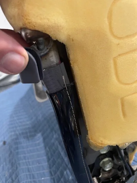

Don't loose these little plastics protecting the leather from sharp edges:

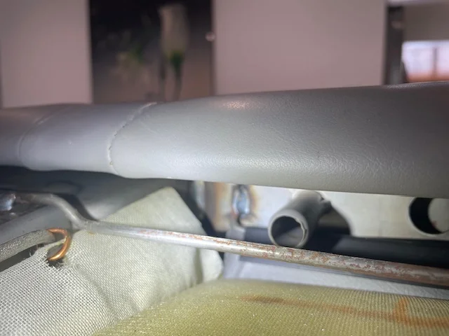

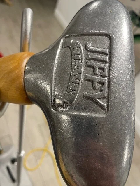

Naked and ready for a steam
Fixed wires that came off the original foam, trying to make it stay with some new foam and glue. Needs time to dry..
Not sure if that's the way to do it. It kinda worked OK..

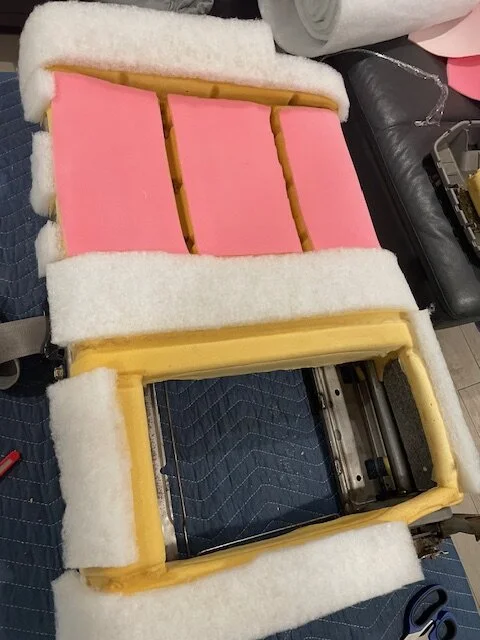

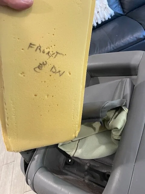

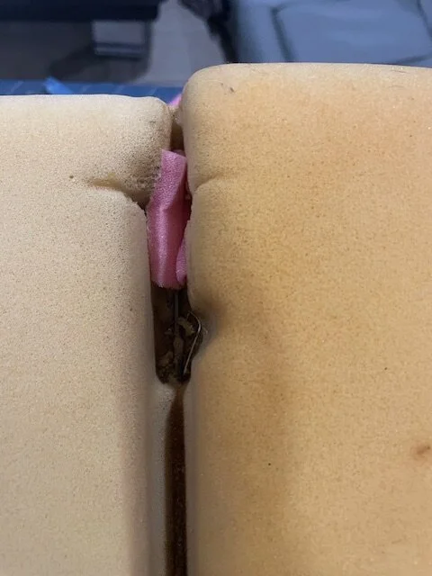

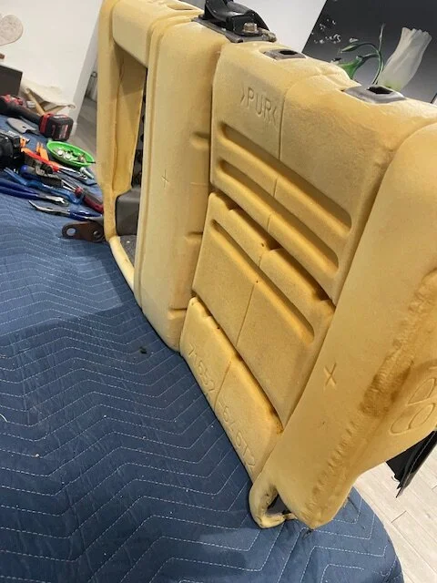

Now, getting the foam ready, and fatter, so it'll be even harder to put it together. And.. a huge mistake that I'm still trying to fix.
Added foam to make it plump. Does it need it? Probably not, but if there's a way to complicate things, I'll find it

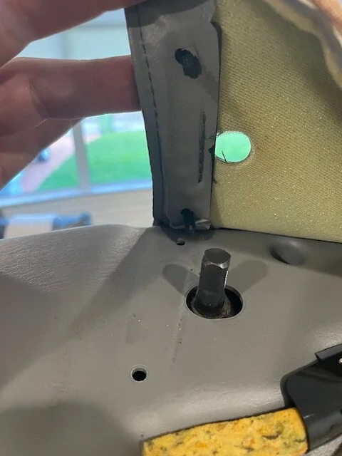

in this piece, which has the hole for the g-d d--n armrest, I started by trying to get that part out of the way, and probably will help align the rest of the leather to the foam properly. It did, a bit..
This is a plastic clip from the original leather, it goes in the hole, top part, clipped to a wire that crosses that area, and stretches the leather in there so the arm rest has a free movement:
This is what I had to do with the new piece which is made out of very flimsy and rubbery plastic that deformed every time I tried to clip it in place, destroying my fingers and nails doing it:

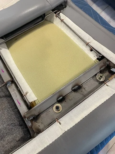

I became fond of the hog rings, I gotta say. From now on I'll be using it for Everything!
I'm looking for more pics of the backrest, but can't find any, so I guess that's where I got busy with the hog ring job, and since I had all images needed to put it back together I didn't take any more.
The idea is simple, keep the leather aligned so it doesn't create creases, begin from the center and move towards the edges, try not to puncture the new leather while you move the pliers with a very sharp ring attached, and gerit done!
On the bottom seat pan, I inserted the leather around the seatbelt latch first, In my head that kept the whole cover aligned and since it's in the center, It didn't bother me with the rest of the hog rings.

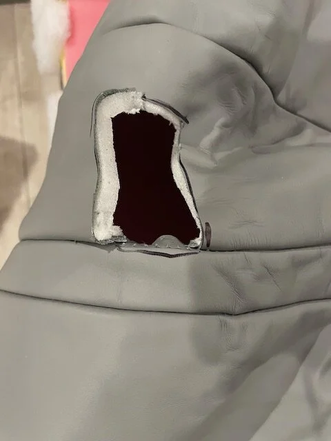

Now, a touchy subject. Making holes to your new leather....
You'll need a super sharp blade, the new leather, or at least this one, is really flexible, I wasn't expecting it to be like this, it resists punctures like a deflated basket ball. An exacto knife should be used, and replace blades often. of course, I couldn't find any of the 20 kits I got over the years, so I used the cheapo harbor fright little knives they have next to the register, good thing I always stock on them.
The scary one is the rectangular cut around the top part where the seatbelt is. I measured 7 times and still made a mistake, I believe I made the hole much bigger than needed, and that's hunting me till now. Even after covering it with the broken and epoxied trim piece, some of the cut is visible.
So.. DON'T DO THIS::
If done again, I'd measure 7 times and just slit the leather enough to get the seatbelt through, and only after everything is in place and stretched begin slowly removing material till I can re-install the trim piece there.. So yeah. Even though I'm the only one that knows that's there and you can't see it unless you look for it, it bothers me and I'm still thinking about that.
The headrest holes and side handle hole are pretty easy, start small and go bigger, and always stretch the leather first before cutting since the location changes, the new leather feels like rubber.

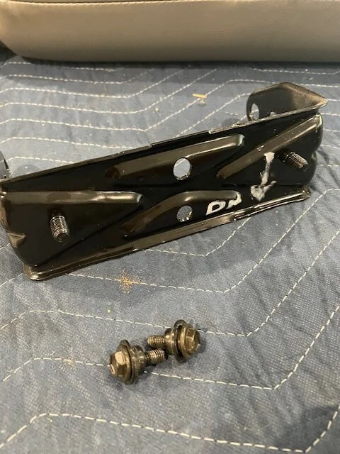

The issue I had here is that when I got the hinges back, one of the bolts that screw into the frame stripped, the hinge fights you back and you have to make sure you hold it in place tightly while you thread the bolt in, but I was by myself so there it is.. the bolt broke in there, I looked at it, cursed it and continued with my life. So my cruiser is an ounce lighter now..:cool:

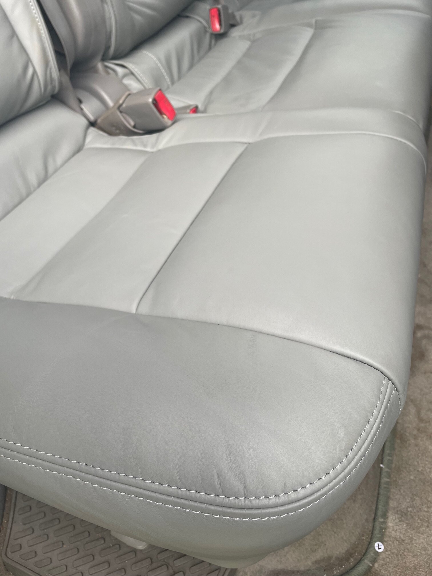

So... to resume.

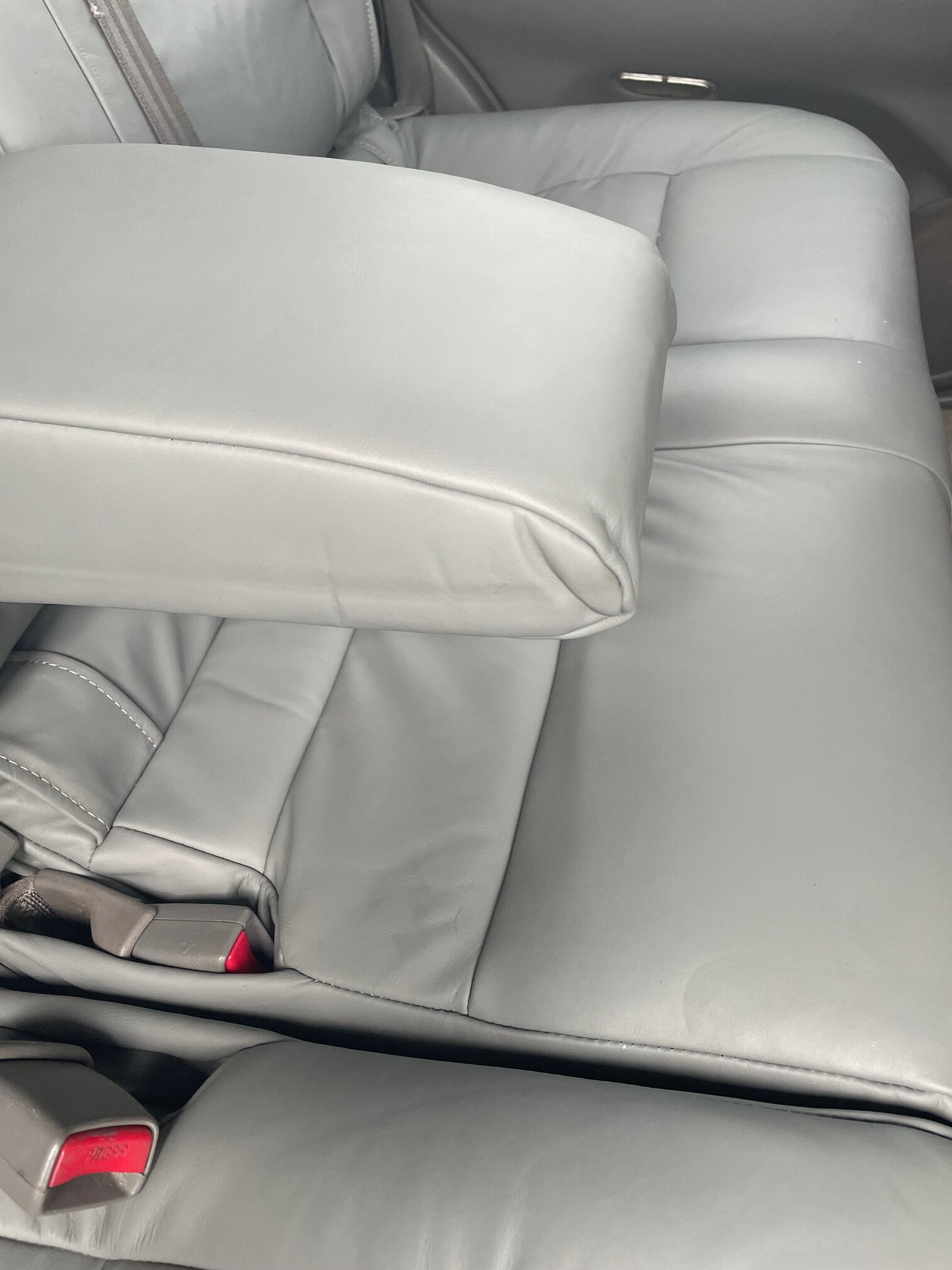

Here's the seat after a couple days
I'm happy.
Not so much of my execution. I made mistakes and I'm sure a "pro" would have done better. BUT.. I get so disappointed and pissed of when I pay a "pro" to do a job and ends up badly, that I prefer to do it myself.
