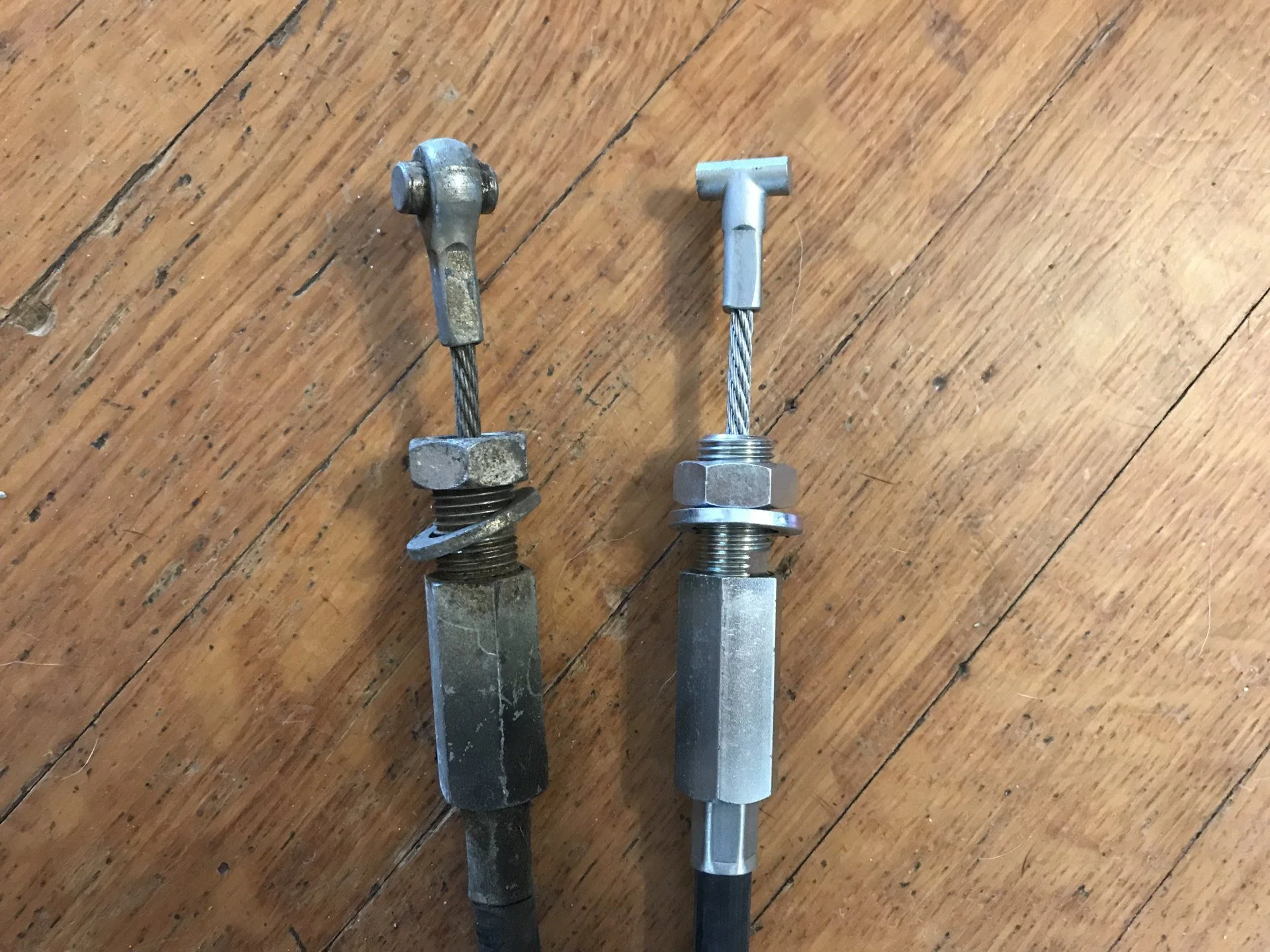

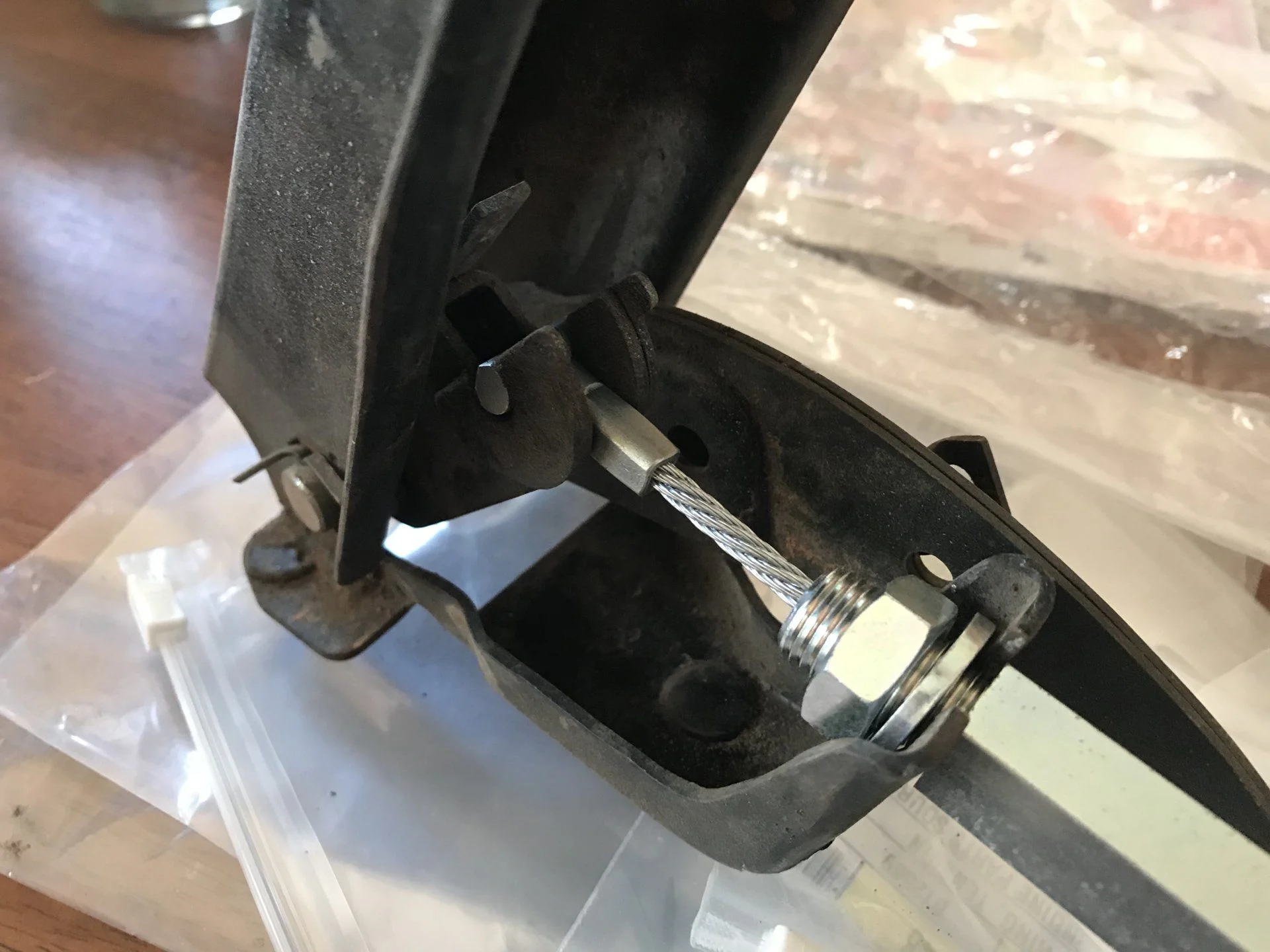

As a follow up, here's the difference between the cable years listed above. The overall length, adjusters, and attachment at the emergency drum backing plate are identical. The earlier version has a "rounded" head with integral cross T, the latter is just T shaped. It looks like it drops right in and fits like the earlier one did, so they appear to be swappable!

01/1975-03/1976 on the left. 03/1976-01/1979 on the right.
