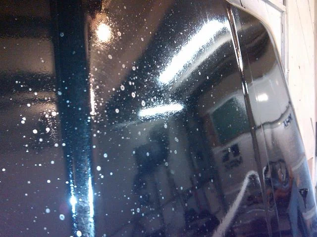

so this is part two of my POR15 problem (which started at the link below).
https://forum.ih8mud.com/40-55-series-tech/289101-por15-spray-problem.html
not wanting to hand strip this hood i think i'll try out the media blaster i've had for 3 years and never used.
I know POR is supposed to be a bugger to get off, but at the same time i don't really want to warp the hood by using something like sand.
Maybe I should walnut or crushed glass? anybody know what they are talking about when it comes to media?

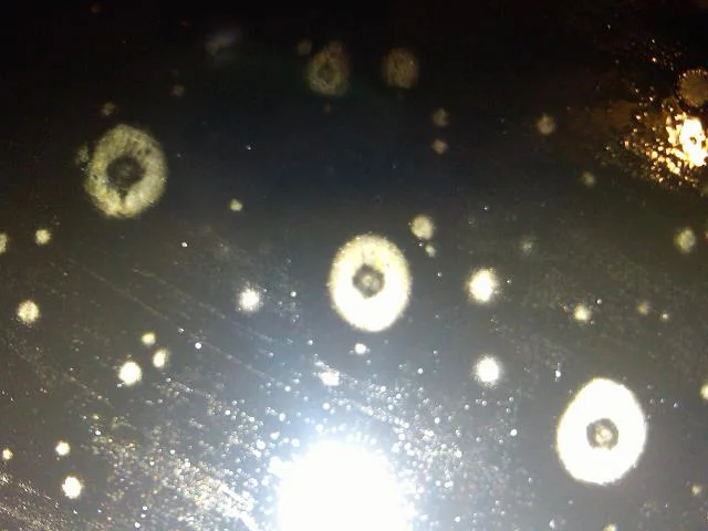

The whole reason to strip it is because the application came out terrible. There is a whole thread devoted to WHY it came out the way it did. The link is at the top of this one.
That looks like a serious case of fish eye to me. You must have used something with silicone in it to wipe the hood down before painting it. Why did you decide to paint it with POR15 anyway? If it was in good condition and down to bare metal you'd be better off priming it with epoxy and topcoating.
