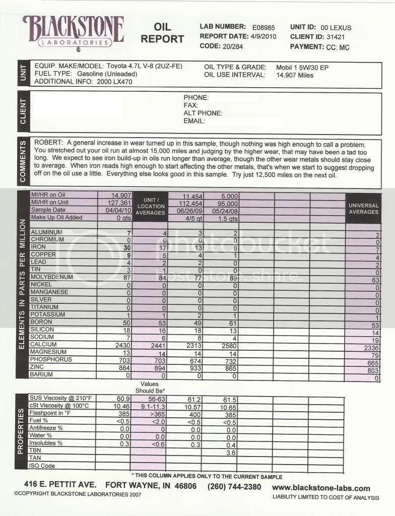

I had been trying to extend time between oil changes by using Mobil 1 EP and getting it tested by Blackstone to verify oil wear. It seems 15k miles on this oil using my engine is too much. The good news is that I had to add zero oil during the period.

I know, I know... frequent oil changes are cheap insurance. So I will reduce to 7,500, I think.
