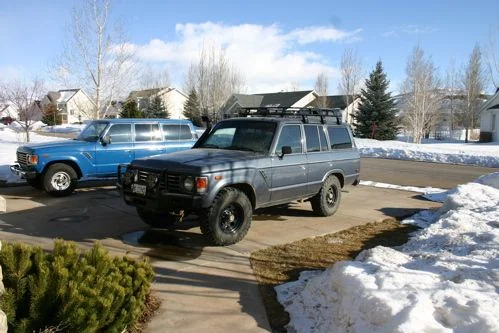

Shots on stock suspension...
The one in front has the stock suspension (until next weekend) with 32x10.8x16. On Allied Custom Steel rims.
The one in back is stock with 31x10.5x15....
