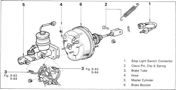

Well, all brake boosters have a check valve in the vacuum line that powers them. If it's still in the truck, you start the truck and let it run for a bit, shut it off, wait 30 minutes or 1 hour, and then wiggle the check valve. If you heard a vacuum sound, then your booster was still holding a vacuum. In this diagram, the 90 degree 'fitting' where hose #4 goes in, is the check valve. If the booster is off the truck, you will have to rig up a way to supply full engine vacuum to the booster and charge it up.
