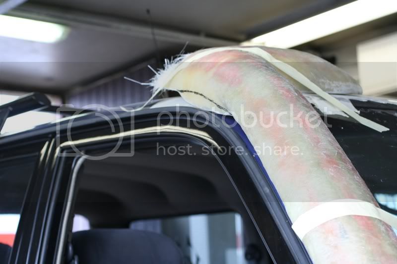

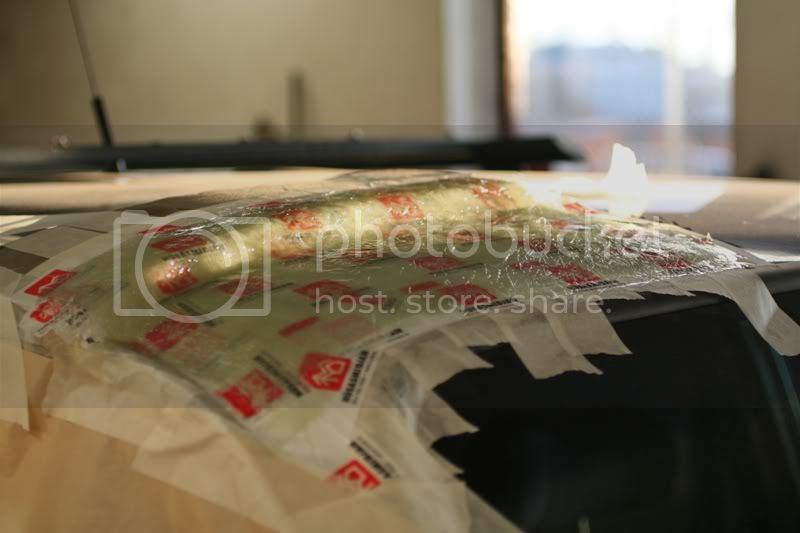

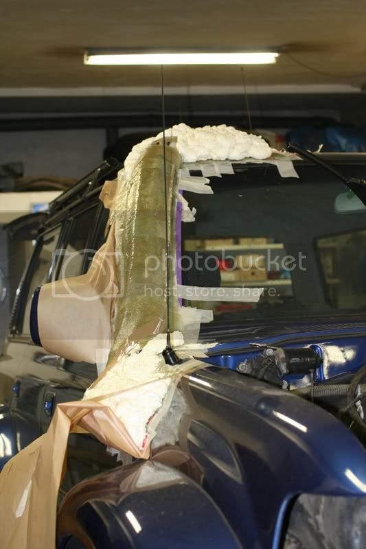

I started by masking off the parts of the car where the snorkel touches it, both the fender and on the top. First I waxed the area but I did not polish the wax off, then I laid a painters tape over the wax and then plastic tape over the painters tape. Fiberglass does not stick to the plastic tape.

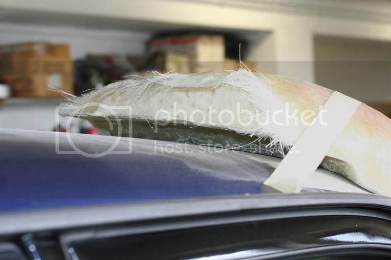

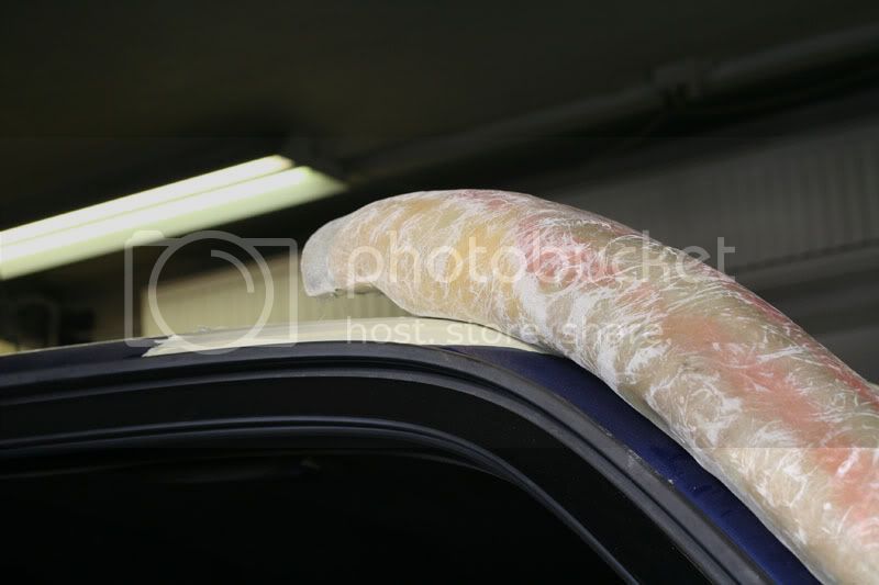

Then I laid two layers of fiberglass over the taped area to make a base for the rest to stick to. This way it is also sure that the fiberglass piece will fit the car perfectly. I lifted the glass on the top about an inch from the top in the back, the reason I did that is so that water on the top does not flow inside the snorkel when braking or going downhill. The snorkel will suck air in from the back. I haven´t designed that part yet.

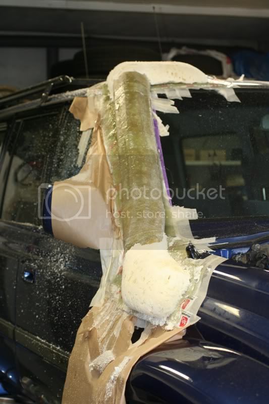

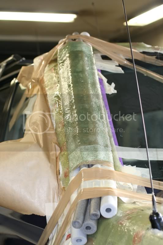

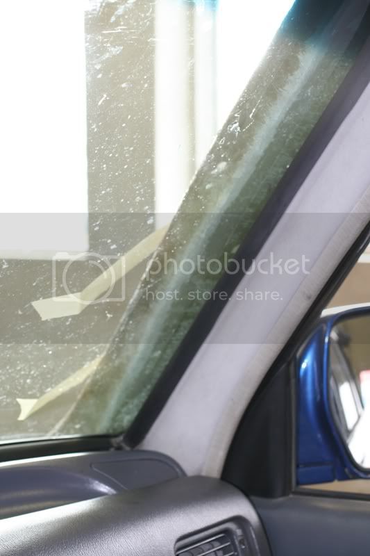

When these two parts were hard I padded the a-pillar with an old camping mattress and tape and joined the two parts together with glass. I used the mattress to lift the glass from the pillar because I want to allow water to escape the windshield.
To make the tube up the a-pillar I used some foam tubes I found in the hardwarestore, I taped them together and made sure that the tube is wide enough to allow enough air flow. These tubes I taped onto the base and glassed over them.
Then I used polyurithane expansion foam to cover the top and the bottom pieces. When that dried I formed that to the shape I wanted and classed over it.
When all of that had hardened I "broke" that thing off the car. With that off the car I could glass the parts of it I could not glass on the car.

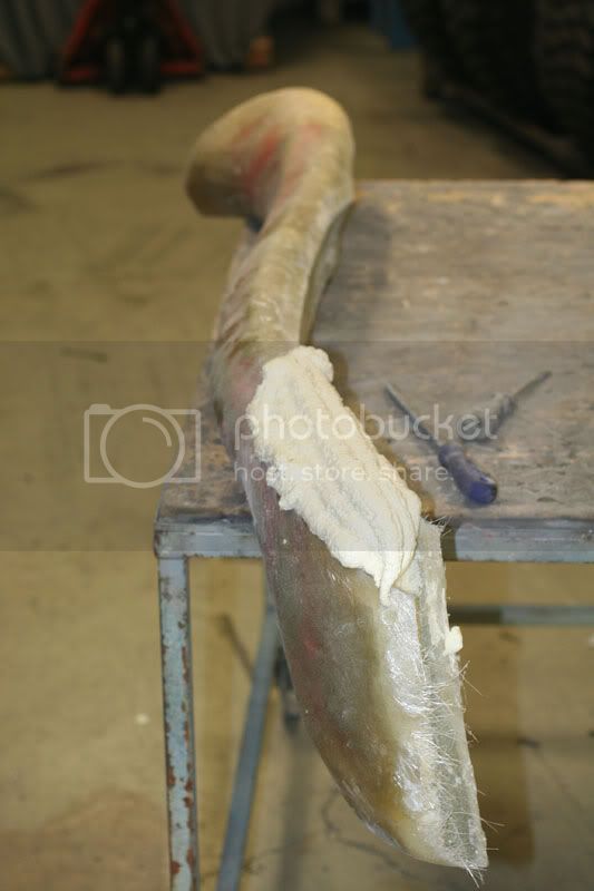

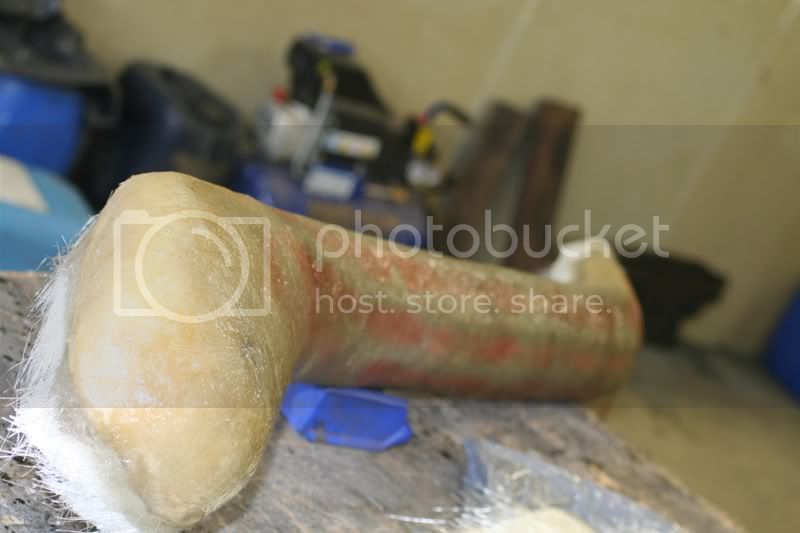

Now I had a rough shaped fiberglass chunk to work with.
Now I used a fiberglass bodyfiller to smooth out the most obvious low spots and then sanded all down with a handheld belt sander. And glassed two layers over that. Then I had much smoother and better looking "thing" and when I had the edges cleaned and sanded down I started to look like a snorkel again.

It does block the view a bit but I don´t think that it will matter.

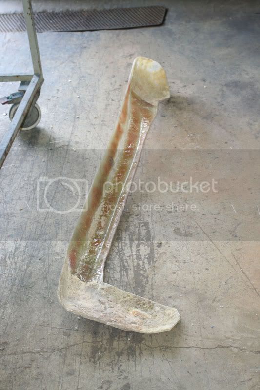

I spent some time on this this weekend. First I cut of the part of the top that I did not like and filled the cutoff with expansion foam. Then I shaped that and glassed over and test fitted the snorkel on the car to see the new look. Now It looks much better in my opinion.
This is not the final look, the part where it lifts off the top is going to be a bit smoother. I will work on that with the final layers on the outside.
Since I was happy with the look I glassed that new part as smooth as I could. I also made a mold of the air intake with some mdf pieces and glassed that. I really forgot to snap pics of that.

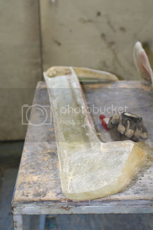

With that in place I cut the snorkel open and removed the filling. Spent some time scraping, sanding and using a air dremel to make it as smooth as possible on the inside before glassing on the inside, one layer over all and two to three layers where it was thin and I had holes.
One pic in the end of the top section that I will glass back in place, I still have to sand it a bit better on the inside to get it smoother.
Next step is to fit it on the car, drill holes, add some fasteners and pipes and then glass them all stuck.
