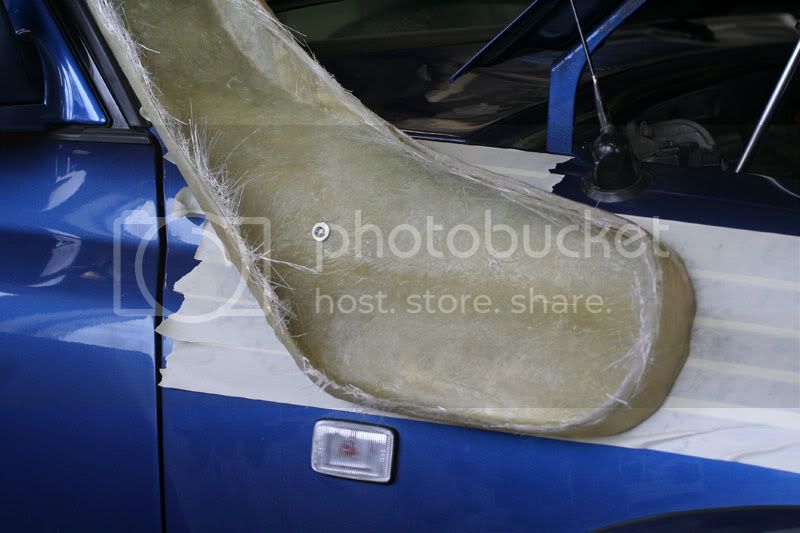

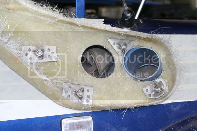

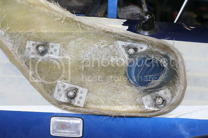

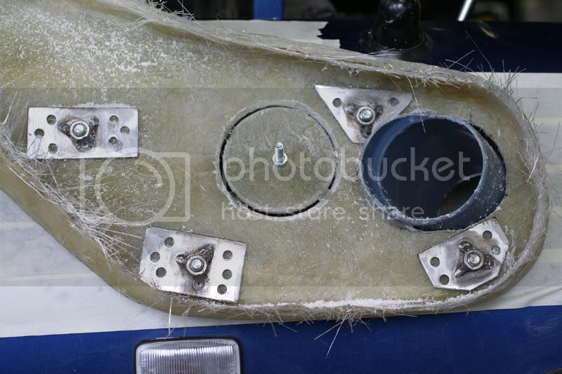

Last night I took this project past the "no way to return" line. I drilled a huge hole (two huge holes in fact) into the fender and a few smaller ones as well.
At first I drilled a hole at the wrong place. There wasn´t enough space behind the fender for the pipe to pass. So I just drilled another hole ;)
I welded 8mm nuts to pieces of sheet metal and bolted them in place from inside the fenders. Then I glued the "lid" that came off the wrong hole back in its place and glassed over.

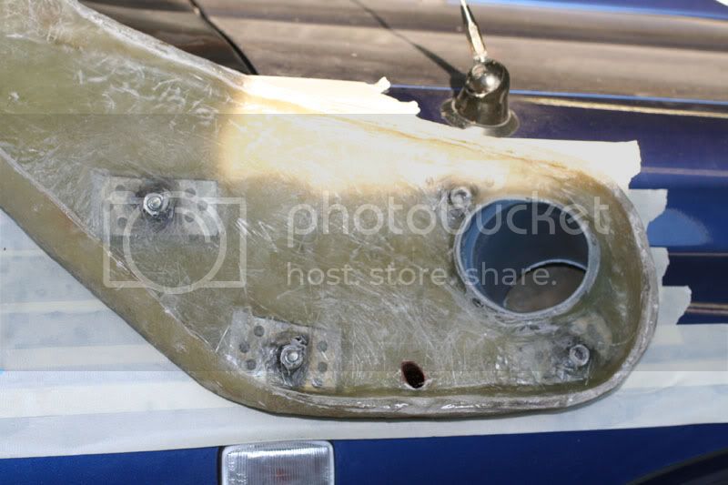

I drilled a hole below the air intake hole and glassed a 12 mm pipe through that hole. The plan is to use that part of the snorkel as a water trap and that smaller pipe is to empty it. I´m going to route a hose with a valve on its end from that 12mm pipe.

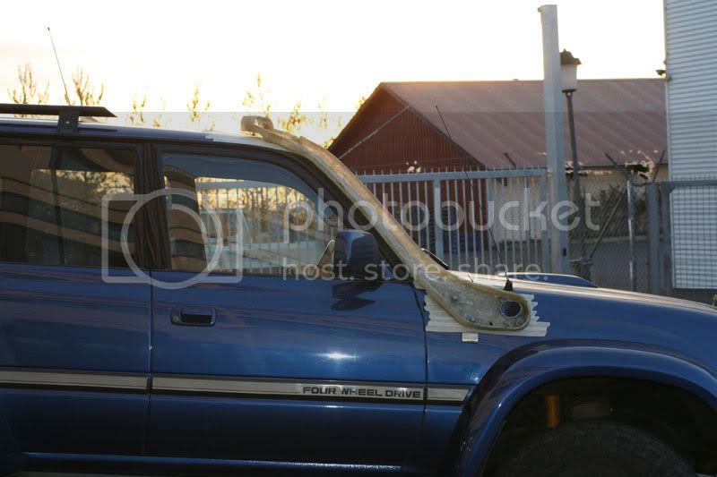

Tonight I added three rivnuts to the top of the car, these three nuts will hold the top in its place.
Here you can finally see the air intake. I will find some kind of net to cover it. I will be able to reach those bolts through the air intake.
Hopefully I will close this thing again tomorrow and then I can start filling and sanding.

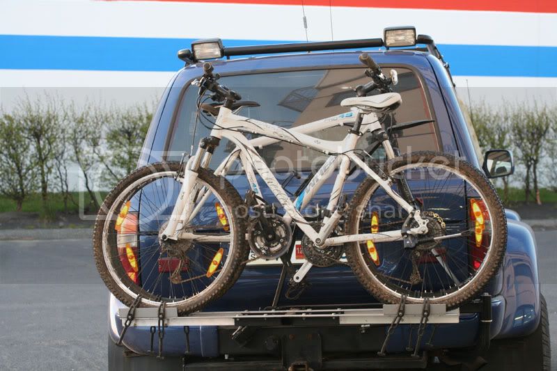

Fiberglassing is time consuming, you are always waiting for something to cure ;) so when working on it you need to have another project on the side. Finishing this bike rack I started building earlier this spring has been my sideproject for the last few days.

Am thinking about swingouts that can be completely removed - quickly & without tools. Just wonder if you hv a sketch/more detail pics, thks
Haffi,
Great progress on the snorkel.. I like the bike rack too. The square red lights on your tail gate....are they factory or did you add them??
Thanks
