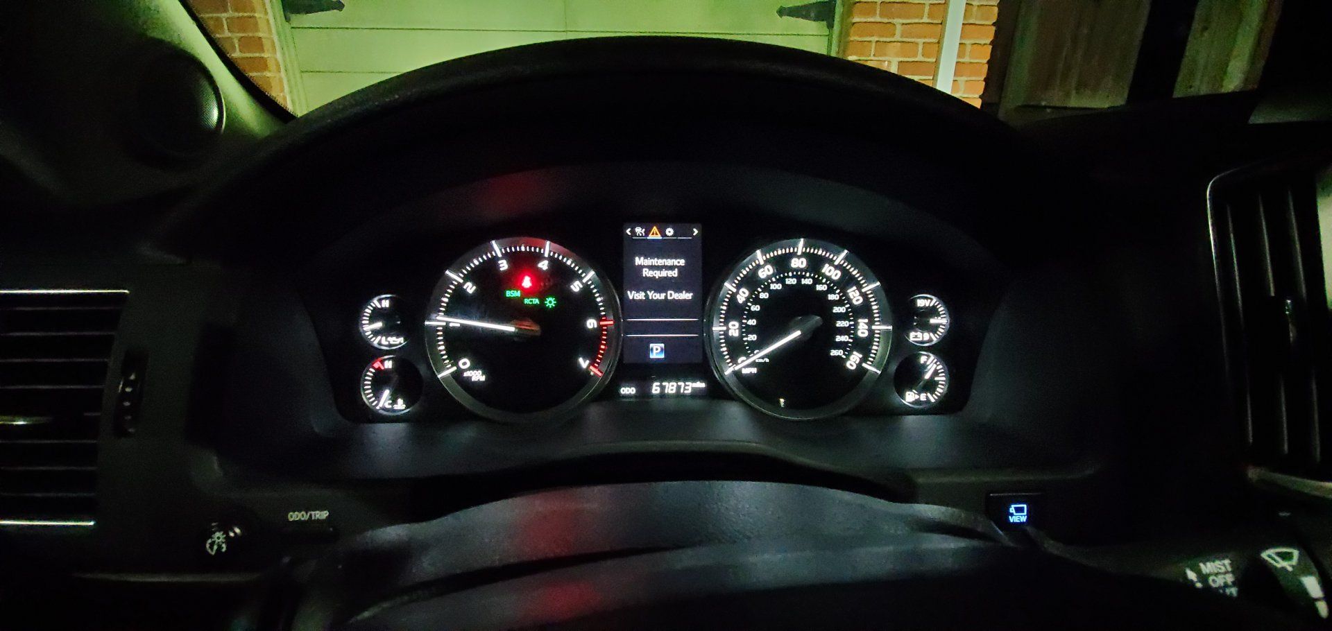

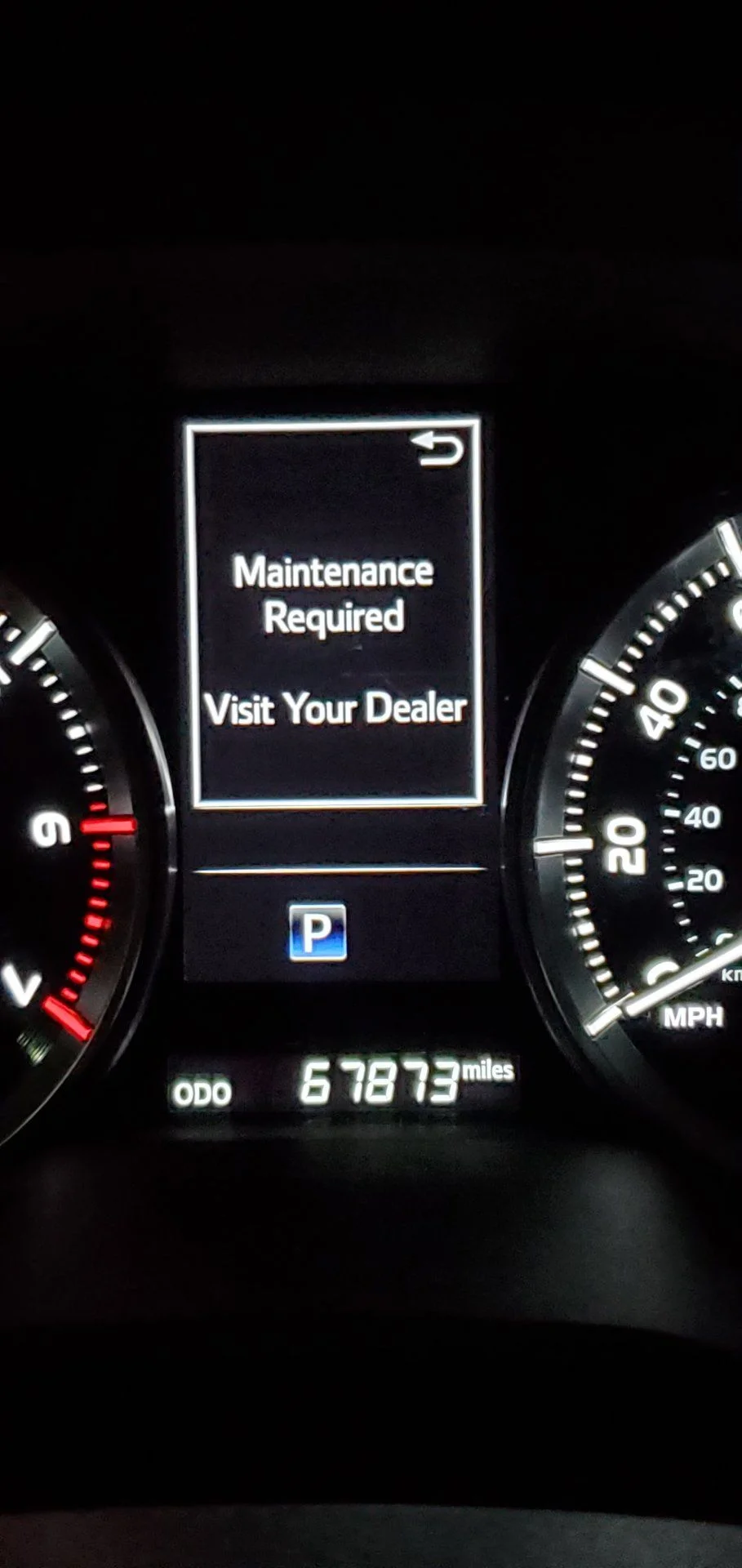

Just to the left of the gear icon there is an orange triangle with an exclamation point in it. When I "arrow" over to it it didplayes the "Maintenence Required vidit your dealer" message.
If the message is just BS to get you to a dealer then I will clear it as you described above. I just want to make sure there is no significant maintenance that needs to be performed like a timing belt/chain replacement. Per the owners manual, I don't see that anything needs to be done at 67k miles.
Thanks all for the help, this is my first "nice" car.
I attached a couple of pictures.

Your car is not smart enough to know what maintenance is needed. That is a dummy notification that comes on every 5k miles, regardless of use/problems.
In my '17 Owners Manual the reset procedure noted by @Dan Higgins is on page 441. It's probably the same page or very close to that in your '16 manual. The list of specific maintenance needed at each service is in the Warranty and Maintenance Guide. Those for 65,000 or 70,000 are page 46. There is nothing special or major about either of those services, so the "visit your dealer" is effectively just an advertisement, so to speak. You can have the work done anywhere and there is nothing wrong with your truck. To reset the TPMS, see the location for the reset button and procedure on page 465 (or thereabouts) of the Owner's Manual.
