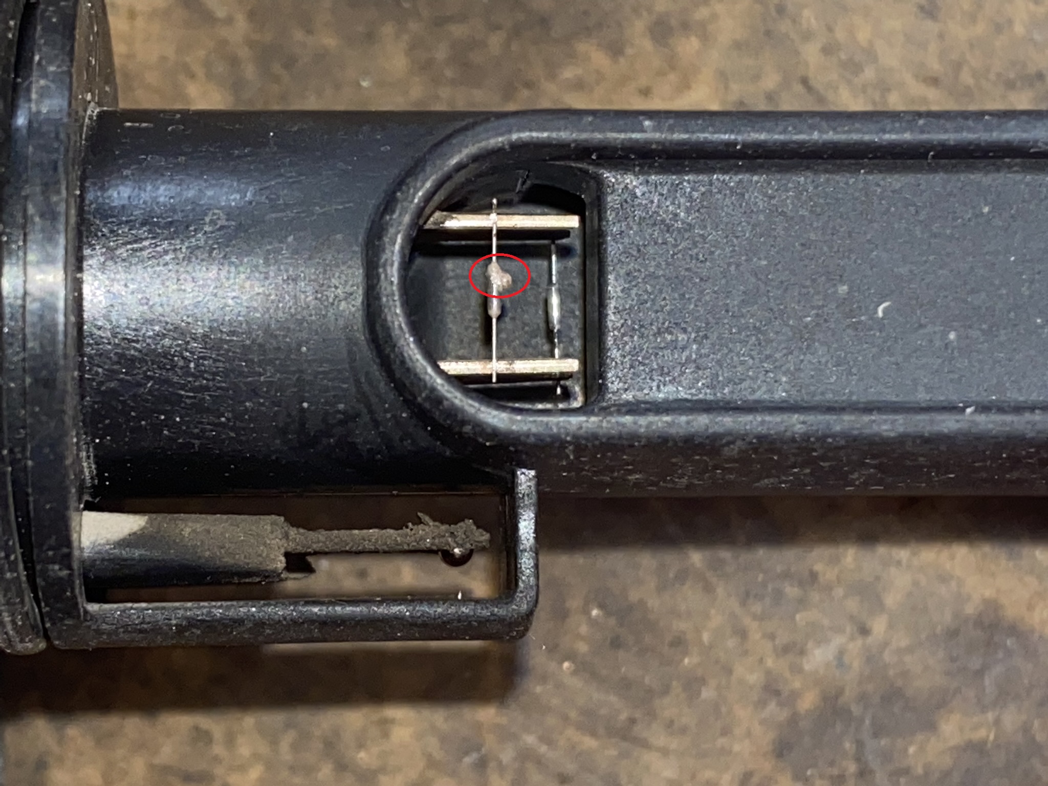

MAF, are very sensitive instrument. Replacing old MAF, isn't a bad idea as a PM. I'm see improvements, in fuel trims & MPG doing so. Make sure to disconnect battery negative clamp first, before disconnecting MAF. Reconnect battery when done, but no sooner than 20 minutes.
This MAF bad on, burned up BK1 CAT fast. Luckily CAT BK2 did ignite.
