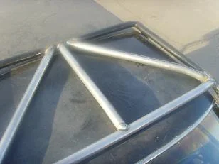

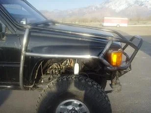

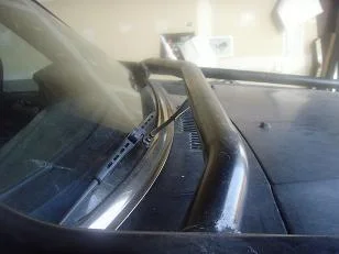

a few pics to get it going
thanks. i had a pretty good idea of how i wanted it to look before we started, but its changed a few times. . . any question/comments welcome.

We don't have the cab finished yet.. I just wanted to show progress as we build. We decided the start with the front bumper. The winch plate from Trail Gear that I purchased through Worldwide Off Road provided a great starting point or base. We first bent the bar that mounts right above the plate and then did the lower supports and the front hoop.
Then we decided to try and bend the piece that comes off the side of the front hoop and runs across the top of the grill, down the hood, up the 'a' pillar and across the cab... In one piece. That was an adventure LOL. I recommend doing one or two bends at a time. It worked out good though, we had to sleeve it in one place but it turned out nice.
We also bent the Main hoop that goes across the back of the cab before this also. That was all one piece too. It actually worked out pretty good. Right now we are working on finishing up the "hood" section and then we will start on the cab and finish up the rear. I won't be down to the shop till Sunday but I'll post pics when we get more progress going. I'll let you know what type we used also. I just want to make sure what it is before I tell you wrong. We spent quite a bit of time debating size and type. So, ya I'll let ya know.
